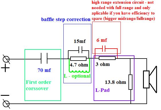

My low pass is second order my high pass is first🙁
What to do?
This is a concern only if you use a single stereo power amp to drive the speakers.
I am with first order crossover for my midrange and the recomended from MJK low pass crossover for the Goldwood (13mh, 150mf) and at higher volume levels I get too much midrange cone excursion 😉
And this is due to two reasons, the first is that the big woofer makes allot of back current and the amp that I use now has damping factor under 30... so that current manages to pass through the 60/70 mf capacitor in series with the midrange 😉 and because in first order there is no parallel inductance to deal with it, it moves the membrane of the midrange...
The second reason is that I designed my own OB using the EDGE program and it is much smaller than the original MJK baffle... due to that the raise in SPL for it is centered around 900-1100 hz and the fall (baffle step) is around 200-250 hz
So with first order crossover at around 200-250 hz I get a second order (12 db/oct) cut off slope, but I get the bass driver inducing midrange cone movement as well... 😉
The aim with the smaller OB was to achieve 100% accurate SPL EDGE prediction as it is with 4 open ends (or edges) suspended in the air and the sound is very good, but that comes at a price... 😉
With higher damping factor amplifier I am able to go to higher volumes before the midrange membrane begins to move too much... but again at some point the effect is present...
I tried to run the low frequency part and the mid/high frequency part separately and both run smooth and without distortion almost to the maximum power 😉
And if I go for a second order electrical crossover I will get a third order overal slope - e.g. 18 db/oct... so I'm kinda stuck 😕
But if you go for first order slope with the original OB dimensions and driver position, then you'll get a rise in the SPL somewhere between 150 and 400 hz which will be unpleasant for sure!
Have in mind that while the original MJK low pass crossover is aimed at 100 hz electrically, the actual overall (the sum of acoustical and electrical) crossover is 200 hz for the H-frame 😉 because of the rising response of the Goldwood and the length of the path of the sound waves around the H-frame...
So you have to play with the EDGE program, a pen and a piece of paper in order to design an open baffle and the respective BSC and etc with smooth frequency response...
For instance a first order crossover and smaller OB size leads to such complicated circuit:
Note that this is the crossover for an fullrange or a midrange which falls in response with no spikes and peaks in the end of it's response!
