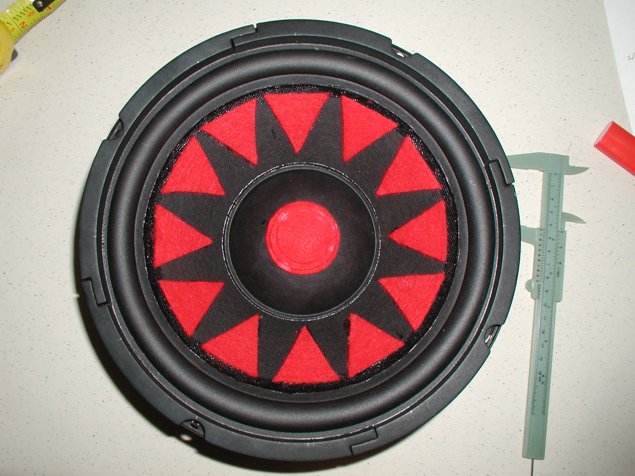

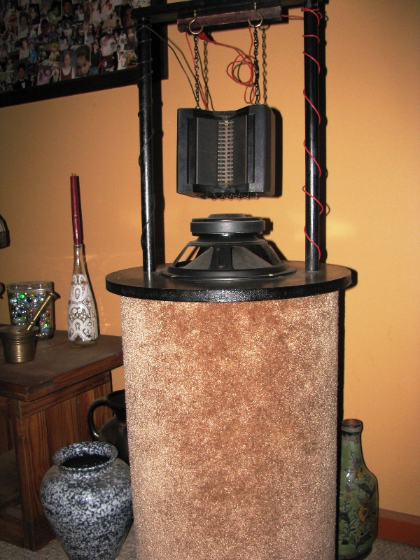

Hi Steve - Just a couple of quick shots as I don't want to stray to far off topic. Dez speakers ain't OB's - well - not quite................... they are (gasp - THE dirty word for some) Omni directional!!!!!! The thread is over on the Walsh 5 remakes - so dis is all I'm gonna say about 'em on this thread. (Just my attempt to stay OT here - not being a [insert your fav phrase 🤐 here])..
1st photo - modified 10 inch Pioneer
2nd photo - ESS AMT1's
The discussion of these starts around post 289 on that thread. http://www.diyaudio.com/forums/multi-way/100390-ohm-acoustics-walsh-f-speaker-remakes.html
