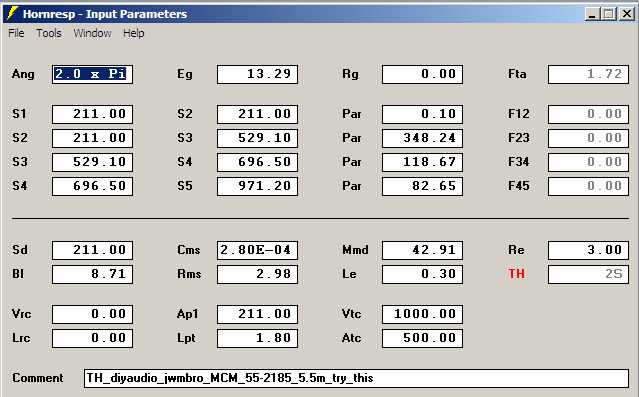

Just for an excercise: change S1 to 149 and L12 to 0.10. That's what you would have with a throat chamber coupling to the end very end of the horn. (To be correct you'd also have to add a throat chamber: Ap1/Lpt/Vtc/Atc.)

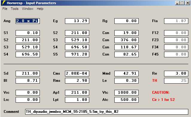

I'll attach a concept Hornresp input screen, and a sketch (concept only, not a drawing) using your maximum dimensions. This shows one way to implement a throat coupling chamber (compression chamber). The horn path turns out longer than I would make it for that particular driver, but it gets you below 20Hz. It's less raggedy than some of the long horn home theater tapped horns, the slightly drooping response (at the low end) is desirable to compensate for room gain. I'd almost bet that the high end would be much less than indicated in Hornresp. When you play around with this in Hornresp you'll find that increasing S5 will raise the mid/upper bass more than the very bottom.
On the subject of Hornresp, I find it amazing too how many different enclosures we can model with the relatively small set of variables. By the way, have you measured the Thiel/Small parameters for these drivers? My experience with MCM drivers has not been too good as to the accuracy of their data (and that sentence was edited by the legal department :)).
Ultimately, there is really only one way to find if this works, and that's to build it. I recommend to use the least expensive material you can get your hands on, people get all bent out of shape about this subject, but I can't see why for initial experiments, e.g.: 1/2" particle board or OSB.
I'm sorry that I don't have the time to run through the complete folding with any accuracy, but you're doing fine by yourself as far as I can see.
Just more stuff to think about.

Another view at the driver/throat area (missed taking out the chamber in Hornresp, makes no real difference):
  • TH_jwmbro_dual_8_try_this_2.pdf

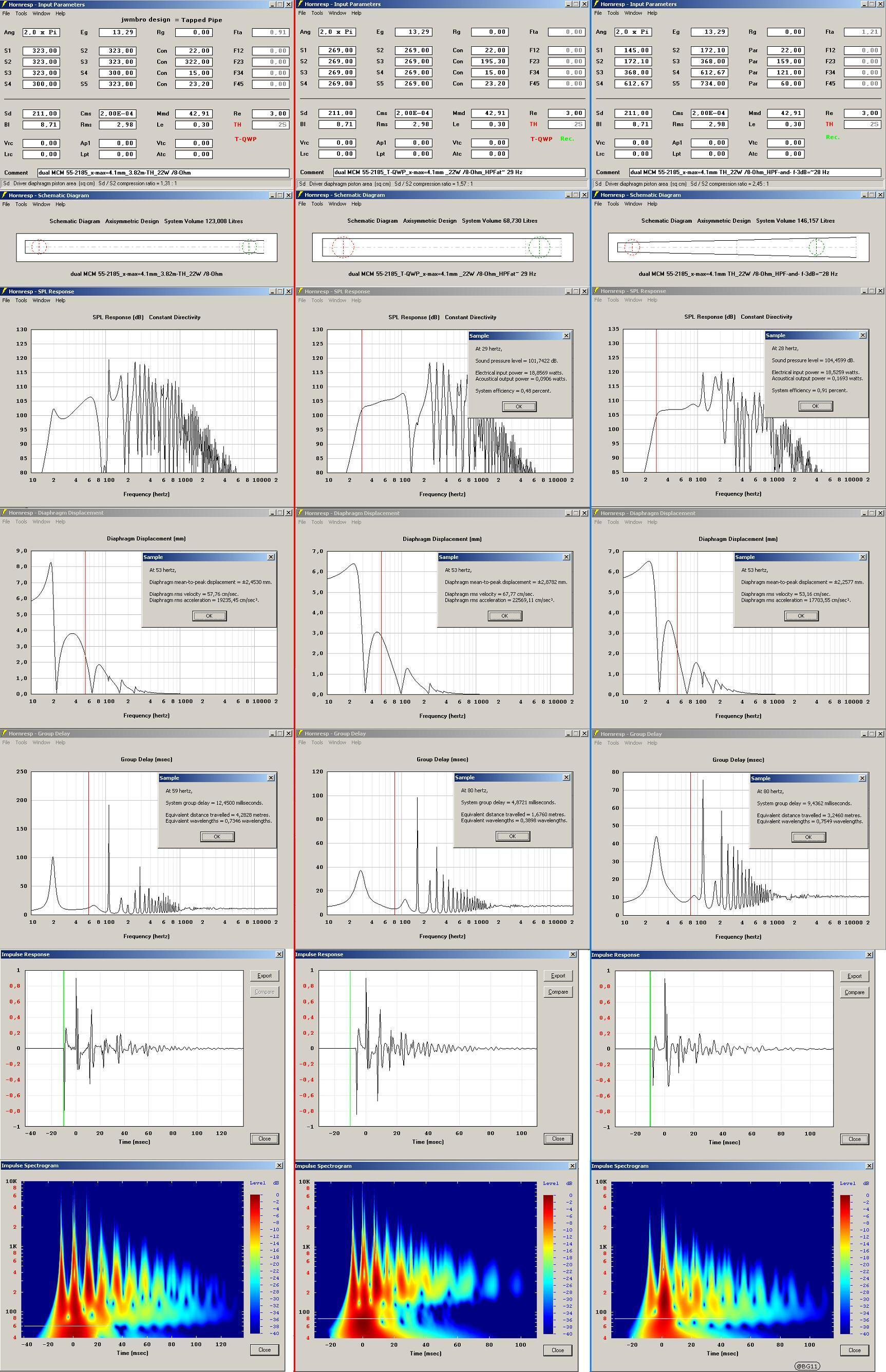

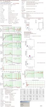

No doubt, I simulated your 'tapped pipe' design: See the complying results in the first column/ picture:
..I've done some simulations, and I'm rather surprised at how close at 20Hz a dual driver vented box is to the horn (all the while being half the volume)..
:eek: If two bad designs are compared, one will always be a winner. :)
It gives up about 2dB at 20Hz (both designs xmax limited, and both requiring a 20Hz highpass), and is surprisingly lower in group delay (one of the reasons I had originally discarded vented boxes was the high group delay)...
What BW are you targeting?Looks you have targeted ~60 Hz for an upper boundary.
..And, the response of the vented box is flat for 4 octaves, which is more than any TH I've ever seen can achieve...

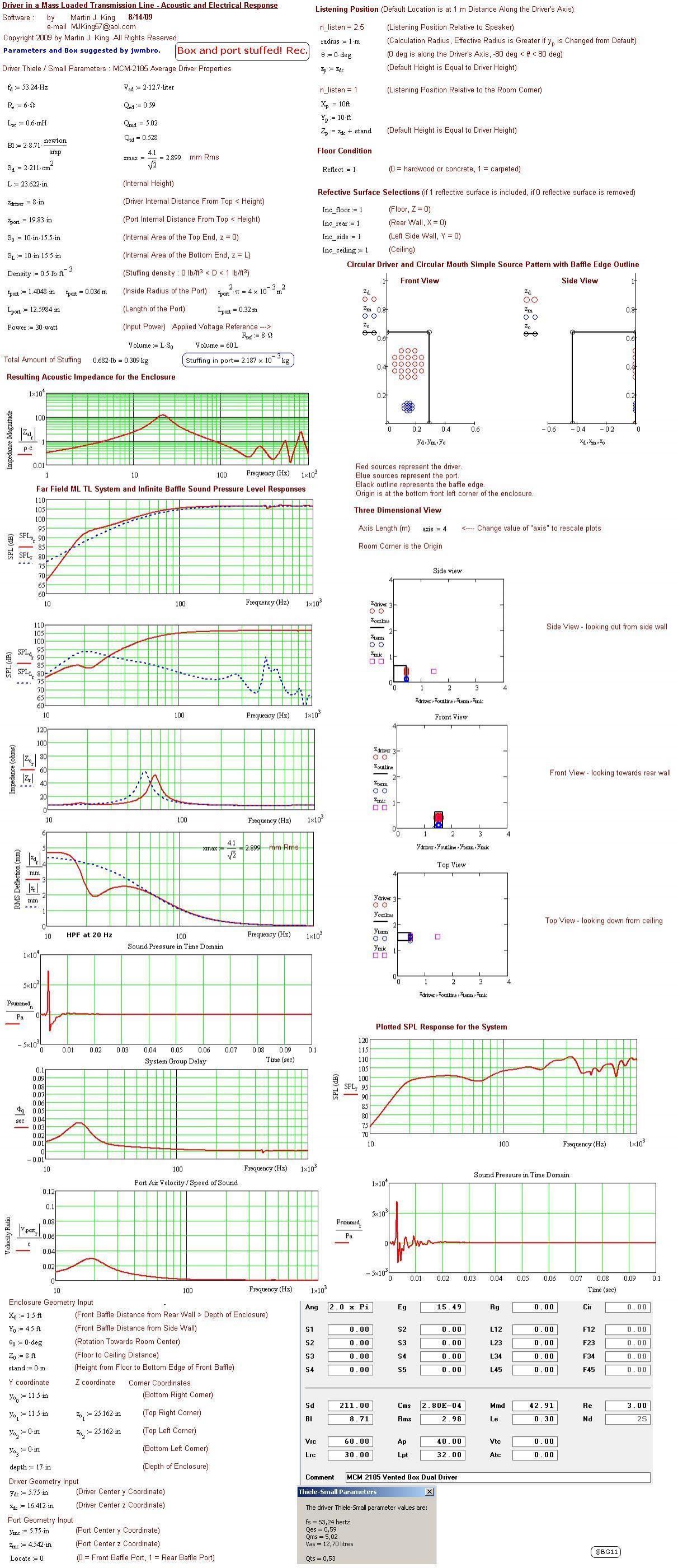

No way, See the submitted MJK simulations where only the heavily stuffed box and port design would be considered to incorporate a flat response up to ~50 Hz where f-3dB is in the vicinity too.
...Oh, and by the way, even with the small (3" diameter) reflex pipe, my calculations reveal max vent speed of 15 m/s at 20Hz (would be 20 m/s without the highpass), which should mean no chuffing at all.
I disagree again, See the simulations showing if exceeding 7W (if the box is stuffed): the port air velocity would be more than 30 m/S.
I'm a bit curious how come you used a different Cms (thus also different Vas) figure than me.... due to this difference your simulation comes out even peakier than mine. EDIT: Never mind, I think I've figured this one out, you're using a higher Fs.
Perhaps we may both be wrong - I really should make my next investment a woofer-tester so I can measure the params.
No doubt, I'm only a beginner at this, and while there are surely better designs to be made, so far this is the best I can come up with at this stage. But as long as I learn from my actions and mistakes, I'm happy.
Ideally I would like to have a flat 20Hz-80Hz range of 100dB SPL.
If I had to make sacrifices, I'd rather lose the top octave than the bottom octave. So I'd prefer 20Hz-40Hz if that was all I can get, rather than give up bottom end extension.
Perhaps I should mention, I have DSP at my disposal for this project, and also it will mainly be used for movies. For relaxed music listening this often won't even be in use. So SPL and depth are a higher priority than musicality.
To be quite honest, the main thing I was looking for when making my design was not the flatness of the curve, but rather this:
Max SPL is >100dB all the way from 20Hz to 80Hz.... DSP can handle the rest.
b:)
Wow, interesting how extremely 3 simulations of the same thing in 3 different programs can differ. Sometimes WinISD and HornResp show the exact same thing, and sometimes they differ wildly by >10dB. It's interesting.
