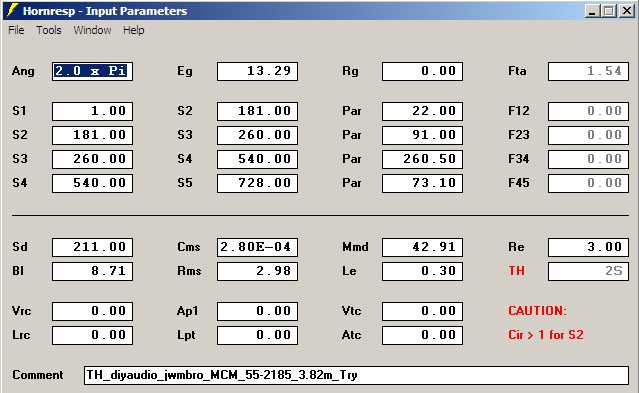

Heya Oliver,
I have indeed read that thread some time ago, but never really tried the enclosures in it. So I modeled two or three of the enclosures in there, and for all cases got results like or similar to this:
xmax limited at 12Watt instead of 22Watt like my design, but similar spl and excursion.
Enclosure volume is around 250-260 liters net, so just over twice the size of my design (not to mention too wide for my 66cm space constraint).
Also, as for the hole above 70Hz, I realize that that's not ideal, but I'm struggling to make anything else within my size constraints (ie preferably <150l) that does better there and still reaches down to 20Hz. In fact, I'd even like to go even lower, but my DSP only supports highpasses down to 20Hz, so any output below that would be wasted).
Also, bear in mind I have 3 closed subs covering nicely above 40Hz (each one equivalent to the purple curve, add a few dB for summation):
Also, I approximated the passband of my tapped "horn" in winisd, to get some comparison figures, and also apply some filters to it (no signal processing in hornresp).
The hornresp results are shown in yellow.
Orange shows how I'd like to use it, with 2nd order bandpass between 20Hz and 50Hz (with the rising response, the 50Hz lowpass tames the peak, and extends the usage window up to about 70Hz, so that's about 1 and 3/4 octaves).
At this output, it's excursion safe within passband, and pretty close below (the only overexcursion is a 5mm peak at 16Hz - compared to the 4.1mm xmax), but I believe the times at which I'm going to play a 16Hz sinewave at full blast will be very seldom. (and even if - a rare case of slightly exceeding xmax shouldn't do much harm - I unfortunately can't find a quoted xmech figure).
A plus-point for my design, is that it can be built using a single sheet (=3 m^2) of 12mm ply, which already costs 60€ over here.
So, by all means, this design looks pretty promising to me, if there's any reason I should abort this plan, please let me know.
Worst case I'd be out around 60€, which wouldn't be too tragic.

Thanks for the tips. I've played around, both from your baseline, and from some proposed in the TH-SPUD thread, and while I've had some better results, I haven't had anything I've been able to fold into my size constraints.
Here's the best one I've been able to do, using the full dimensions of my size restriction (200cm x 66cm x 24cm external). Height is, as usual, 21.5mm internal.
It just barely extends to 20Hz, I was hoping to get one or two Hz below that, for margin of error, but that's all the bottom end extension I can manage from a two-fold 2m long design.
It does get me a good 4dB more output while forfeiting those bottom 2 Hz, also it gives a smoother response (and no huge dip right outside the passband), although I do have plenty of DSP available for this sub.
However, it's exacly twice the external volume (2m long instead of 1m long), and it needs almost twice as much wood. (approx 1+2/3 sheets instead of 1 sheet - 5m^2 instead of 3m^2) Also it will be a lot more impractical to transport, at 2m length instead of 1m length.
So at this point I'm debating if those 4dB extra output are worth the downsides of higher cost, size, and F3.
What do you think? I've HornRespWizarded some a lot nicer designs in less than 200l, but nothing I've been able to fold to fit the space it needs to.

hi jwmbro,
Another nice drawing, what program do you use? Horns (even tapped ones) tend to be big, don't they. That seems to be one reason bjorno likes the T-TQWT enclosure.
Just for an excercise: change S1 to 149 and L12 to 0.10. That's what you would have with a throat chamber coupling to the end very end of the horn. (To be correct you'd also have to add a throat chamber: Ap1/Lpt/Vtc/Atc.)
I'll try to look at this tonight.
