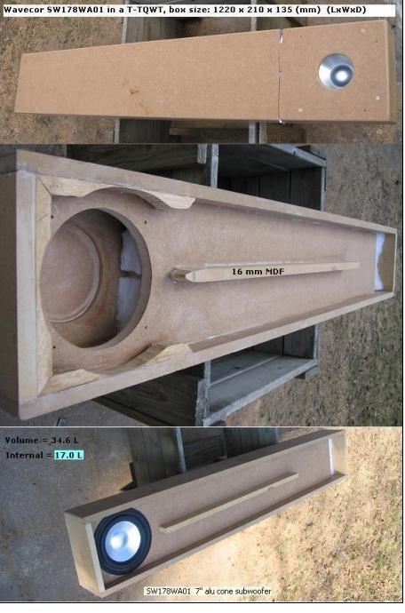

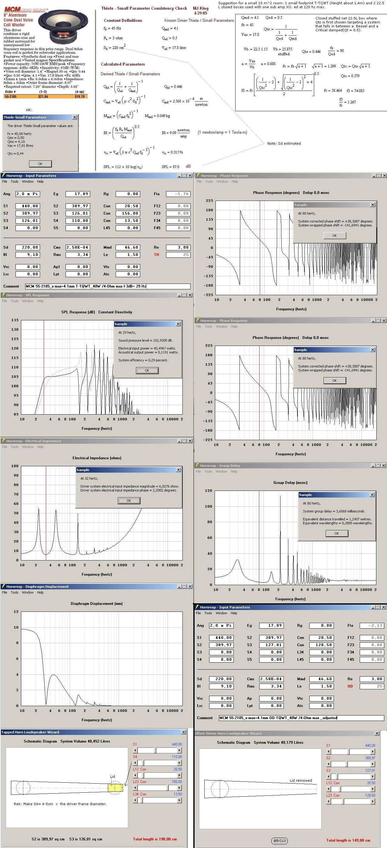

Hi klankyman,
Maybe a small footprint T-TQWT could be of interest: See the pictures
My son has a very similar system (high SQ performance wise, size(and driver sizes)) in a small room (ca 10 m^2) using a single plate sub amp and a 7 channel main amp.

Hi klankyman,

I’ve tested aluminum drivers with Sd/port area exceeding a ¼ ratio, (though max 1/3 for quality paper cones) sounding IMO very well.
See the small T-TQWT IMO,high SQ sub I built last spring for a friend:
b
Thanks a lot for your help, björno.
I have a few small questions. The design you simulated for me, is that a single driver in the enclosure like the last one you attached, or is it a double driver setup like your son's? If it's single driver I must say the output is quite impressive.
I'm a bit wobbly on the nomenclature for the different areas on hornresp. I think the following is the case, but please correct me if I'm wrong:
S1 is the biggest area, basically the size of the lid that covers up the big end of the tube.
S2 is the cross sectional area directly behind the woofer.
S3 is the cross sectional area directly in front of the woofer.
S4 is the size of the opening.
L12 is the distance from aforementioned S1 lid to the center of the driver.
L23 is the distance from the rear center of the driver, all the way along the tube, and around the fold, to the front center of the driver.
Is that all correct?
How exactly is L34 measured? if you just left the tube open at the smallest end, I'd assume it would be from the front center of the driver to the end of the tube. But if the smallest end is closed up, and the opening is instead directly in front of the driver like in your designs, from where to where do you measure?
S1 is the area at the closed end of the folded tube.
Usually in a tapped horn S1<<Sd and S2 and S3 and S4 >> S1
But these rules are not fixed. You can alter all the areas as you see fit and Hornresponse shows you what to expect from the changes.
L34 is the distance from the effective cone/piston centre to the centre of the S4.
It can be very small ~[driver diam / 2] or it can be much larger.
