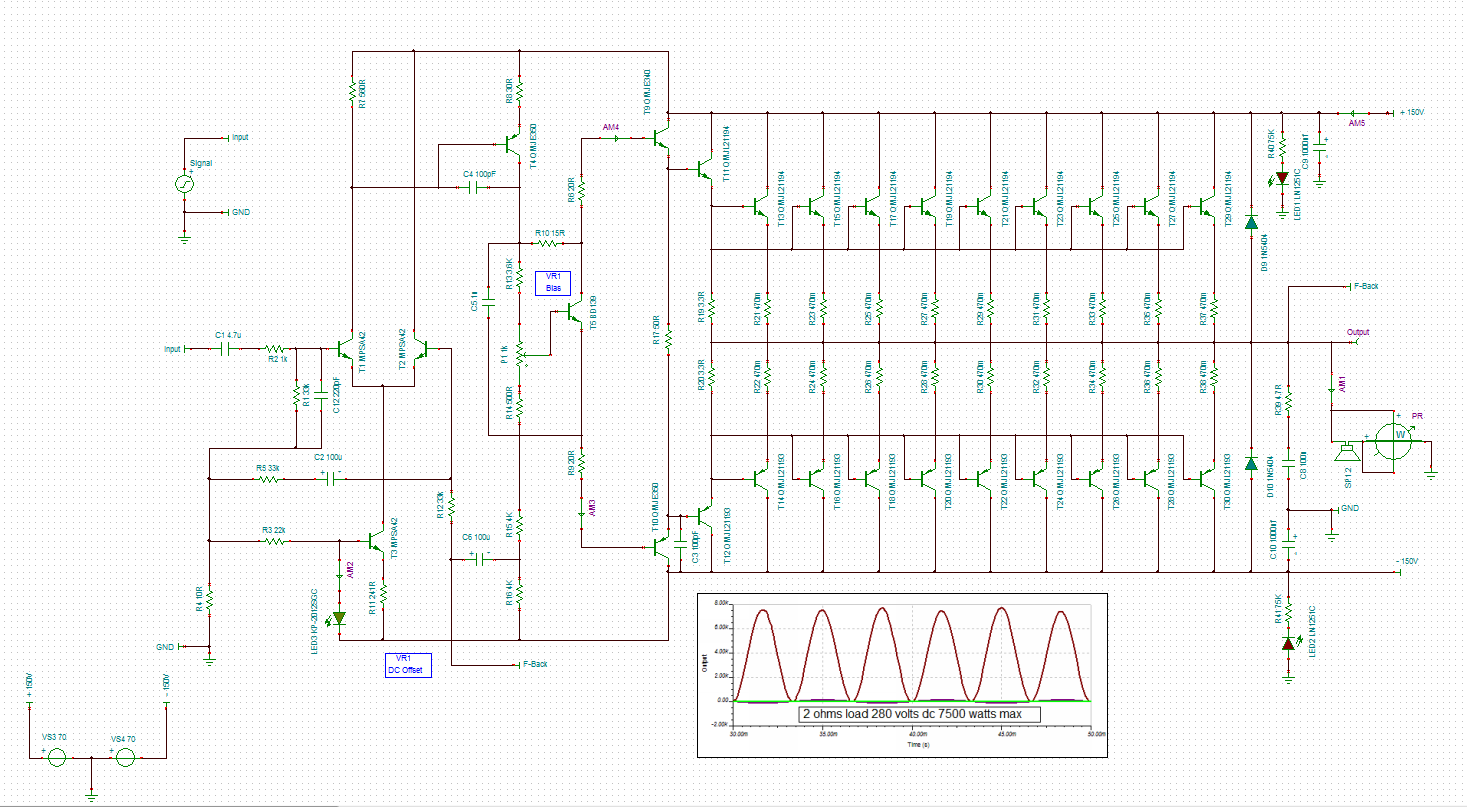

Trouble with the amp.
I did in fact build the amplifier for the posted schematic,
I'm now having a problem getting the power supply voltage up to full voltage.
If I make the power supply voltage at lets say, 55VDC peak to peak it works well. However, when I go above that voltage, the power supply gets a huge inrush of current and pops the fuses!
I'm trying to run this at 120 a channel (240 vDC across the rails)
What is amiss here? It will play nicely at lower than those voltages.

What outputs (build details) ?? , most are 230Vce -some 250.
120V is pushing this rating. This type amp I would not push 90V rails.
A class h stepper would be better at >100V Vce is split over 2 devices.
Project 117 would not be good with modern devices without some sort
of decoupling at the pre-drivers. There are many other "refinements" that
I could not live without for class AB amps >500W.
Thanks for the reply,
I have attached my Tina 10 build where I did model it before the build took place.
The plan was to use 150 VDC rails on this amplifier, but I decided that would really be pushing it, so I settled on 120 VDC per rail +/- 120 VDC.
Outputs are MJL2193/94 to-3 types and there are 20 in total, the transformer in use is a 4kva torrid with 220 VAC primary and 200 VAC center-tapped secondary. one thing to note is that I swapped out the BD139 and used an MJE340 in it's place.
I tried to attach the actual Tina 10 file to this reply, but it states it is an invalid format. So I attached an .PNG shot of it instead.
As you stated on your reply, there is no Pre-driver DE-coupling used in the amp. I will add some in there and see if it helps with the problem.
Robert
