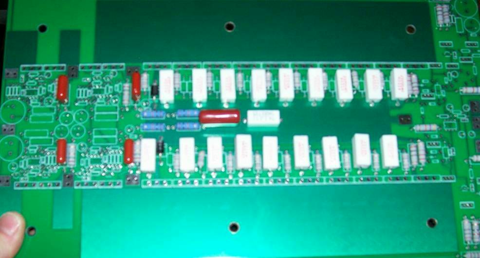

Starting to stuf a power board. Lord only knows when I'll get back to it..... I think Leach once warned that if an amp takes less than 4 months to build you end up with an unacceptably sloppy job.

the 2 Main Power supply boards are done and almost have all the caps in place and the main supply bridging board is done.
Will get the wife to take some pics and post them up.
I Still need to figure out a way to protect the output in case that the and goes into oscilation.

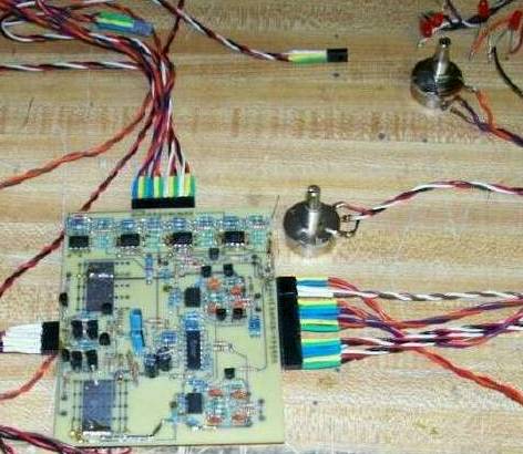

Mine are progressing - slowly. All the wiring harnesses for all 4 are done, all 4 front end boards tested, and all 8 power PCBs stuffed except for the TO-247's and 264's. One has the outputs,commutators and heat sinks installed, but I haven't begun test and debug yet. Looking for a 4 or 5 day uninterrupted window before starting that - because you know it never works perfectly the first time and you can't put it down till it does.
I ended up with one design flaw so far - the overtemp muting circuit had minor problems that required adding a resistor to -15V to make sure the clamp was hard turned off when it's not supposed to be clamping. Just reducing the base drive to zero was not enough if the input signal is much above 5V peak.
Most amps don't have any protection for that per se- you just have to design so that it won't go unstable in normal operation. Short level-dependent bursts of oscillation could still happen, but are not catastrophic. That's not the same as a completely unstable output stage that will go into cross conduction and self-destruct. That would happen without drive or even a load. Protection against that is the light-bulb limiter while you're debugging - and it's pretty much the only thing that works if the amp does that. The input should be filtered to prevent HF overdrive, but that's easy.You could even disconnect the speaker (and zobel) in the presence of excessive HF.
