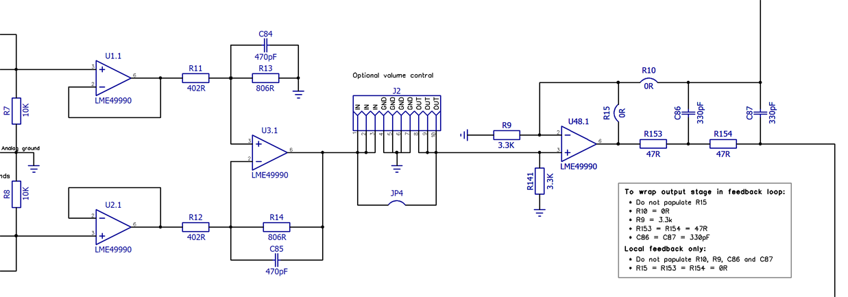

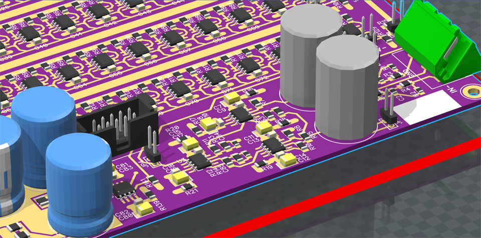

A sneak peek at the circuit board layout (work in progress -- ignore the color scheme if you will; the preview has been configured to resemble OSH Park boards 😉):
I've also been optimizing some of the resistor values to further reduce the input stage noise without sacrificing distortion performance (in the sim, at least). Plus, a couple of jumpers have been added here and there for testing and verification of isolated parts on the board.

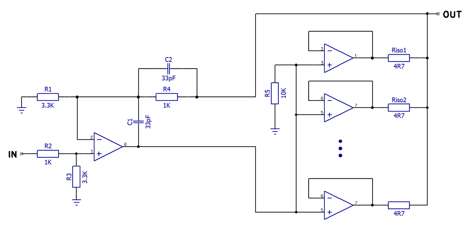

Any thread that says massively parallel should at least recognize this amp.

I've considered the option earlier on, but for my specific case the added output power is unnecessary. Of course, you'd have to double the amount of op amps in the output stage on each board, because each amp into the bridged load sees only half the output impedance (e.g., 3Ω instead of 6Ω). So you end up with four times as many op amps per channel.OP, given the design and differential input, would it make sense to drop the voltage further and go bridged?

Thanks for setting me straight here! I had a feeling it might be too pessimistic.
So, most of the heat generated will be the result of the relatively high quiescent current of the LME49720. After crunching the numbers some more, it seems like this IC wasn’t the best pick for a small signal op amp to use in the output stage, especially given how quickly these SOIC packages heat up if I want to maintain some headroom on the supply rails. All in all, something like the OPA1602 might be a better pick here. Its specifications are also impressive across the board, but its Iq is only 2.6mA per amplifier channel (about half of the LME49720).

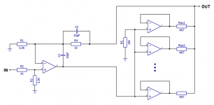

Next to that, I’m going to add an option to wrap the output stage in the feedback of the buffer op amp after the optional volume control, like this:
If I can’t get it to be sufficiently stable, I can always revert to using local feedback only. In the simulator it looks okay though.
I’m not sure what I was thinking when I put that feedback loop together, but it was a mess. Anyway, a few hours of tweaking later, the simulated small signal response looks much better. Turns out a little gain goes a long way when it comes to stability (which needed some attention because the paralleled emitter followers are slower than the buffer op amp). I’ve added a modest voltage divider before the output stage so that the output level stays well within the realms of what the op amps are able to handle. It now looks like this (simplified a bit for clarity’s sake):… In the simulator it looks okay though.
The noise at the output has gone up a little because of R2, part of the voltage divider. Its thermal noise dominates the other noise sources here but is of course still negligible. The simulator is currently reporting THD+N numbers that I don’t expect to be even remotely attainable in the real world given my circuit board design experience. 😉
Additionally, the PCB layout is done and I’ve ordered a couple of boards. Hopefully, they’ll arrive within a few weeks so that I can start building the amp and further optimize the component values. Can’t wait!
With parallel discrete output transistors we need to spend time matching them. I wonder if the same is true for parallel opamps? Btw, parallel output devices can never sound as resolving or coherent as a single output device (or opamps). The analogy is the sound of a choir vs a soloist. It's just the limitations of being able to match perfectly.
Data or pure speculation? This dosnt make sense. With the opamps the feedback "matches" them, and even if it didn't, if all outputs are in phase the currents sum together perfectly. If one opamp spits out. Io1=99(f(x))ma and the next one Io2=101(f(x))ma (where (f(x)) is the music signal, what's the total current? 200(f(x))ma. No "choir" going on.

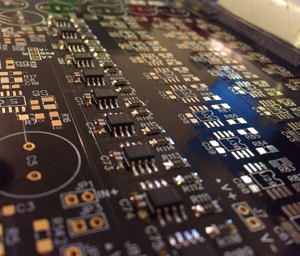

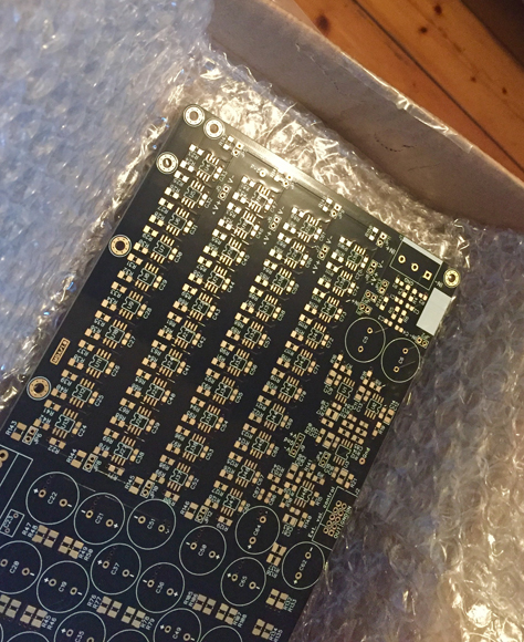

Time for some updates! A few days ago the PCBs finally arrived:
Pitch Black. 😎
Because most components are surface mount type, I went with ENIG plating so that the pads are nice and smooth. Additionally, 2oz copper on top and bottom helps to minimize track and plane impedance.

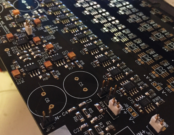

I started by soldering and testing some of the op amp arrays:
Here’s some more eye candy with the instrumentation amplifier parts populated:

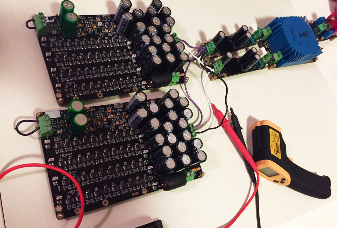

And right now, I’ve got two finished channels in front of me:
Now on to the important stuff. 1. Does it actually work? (After some debugging, removing a stray metal strand and touching up some solder joints, it does. 😉) And 2. How does it sound?
Both channels perform well beyond my expectations. I’ve already tried them with my regular headphones (HD650) as well as some sensitive in-ears. With the inputs shorted, they’re completely silent. Even with the in-ears there’s not a trace of noise or hum whatsoever.
As for the sound, one word that comes to mind is brutal. It sounds just brilliant with jazz and classical, but the authority with which it reproduces bass-heavy tracks while maintaining perfect separation is just stunning. This is definitely going to be my main amp once I’ve got it neatly packaged.

Before starting this build, I was a bit worried about keeping temperatures in check. Especially the quiescent current from the LME49720 could prove troublesome here. Switching to the similarly specced OPA1602 seems to have worked out just fine. After some 20 minutes, both boards are about 30°C above ambient at the warmest spot. Of course, this is still with the amp sitting on my desk, out in the open. I reckon that under heavy load, in a closed case, temperatures won’t exceed 70-75°C.
If I do decide to actively cool the boards in the future, they can support a 90mm fan. Also, there’s some exposed copper on the bottom layer which can be thermally connected to the bottom panel of a metal case. For now, it doesn't seem necessary though.
As the photo's show, I may have went a little overboard with the buffer caps at approximately 0.11F per channel, but I reckon it won’t hurt. The Nichicon UHW1E562MHD capacitors used here have an ESR of only 10mΩ.

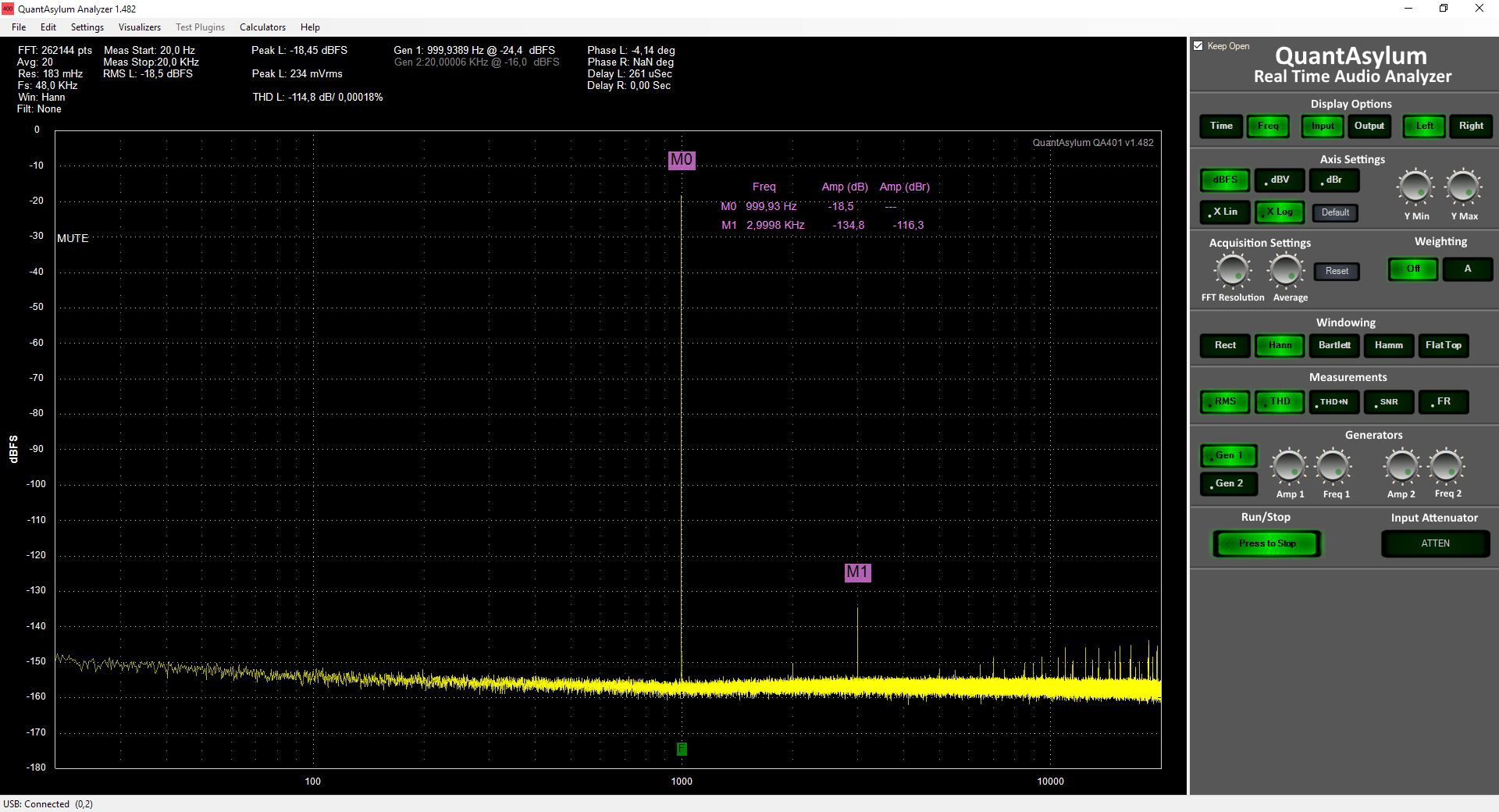

I’ve been using the QA401 analyzer to measure the performance of both channels as I was building them up. Unfortunately (or fortunately, depending how you want to look at it), the distortion is below the measurement floor of the analyzer itself (about -115dB; see attachment at end of post). Because of this, I’m not able to discern whether putting the paralleled output op amps in the feedback loop of U48 (an OPA1611 buffer) improves performance. For now, I’ve just configured the IC between the instrumentation amplifier and the output stage as a unity gain buffer. I haven’t done any intermodulation distortion measurements yet because they're slightly less straightforward to set up with this analyzer, but I expect to run into the same limitations with those given the op amps used here (OPA1602 in output stage, OPA1611 everywhere else).
All in all, I’ll probably have to build a distortion magnifier if I want to characterize the distortion performance of this amplifier more accurately. I’m leaning towards the one designed by Bob Cordell. His Linear Audio article on the topic mentions a kit that looks good.
Pitch Black. 😎
