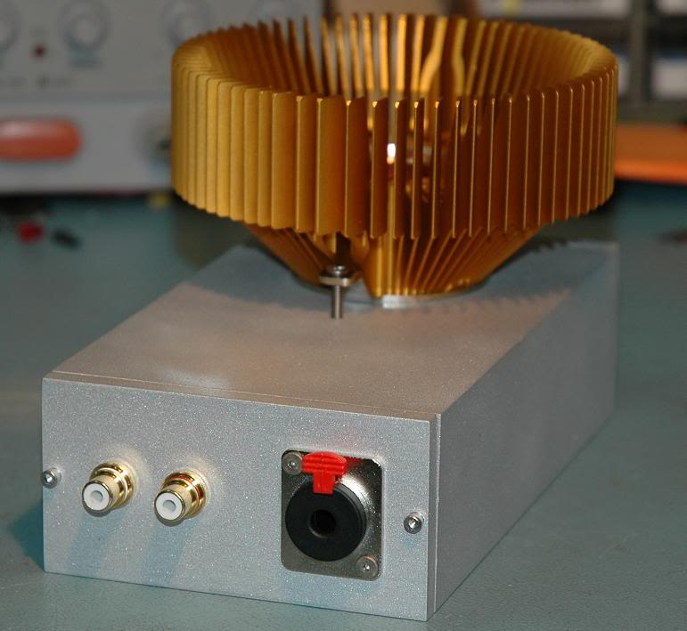

I finally got round to getting some PCBs made up for my attempt at an opamp array amp, using SMT NE5532s. I've half-populated one of them:
I'm seeing about 60C temperatures (according to IR camera) with +/-15V supply. The opamps are higher than the other surface mount components so adding a heatsinking metal plate is probably the simplest approach if I want to tame these temperatures.
The pcb underside is all +/- supply distribution.
Nice! I'm still enjoying mine--totally worth the effort.I finally got round to getting some PCBs made up for my attempt at an opamp array amp, using SMT NE5532s.
The 5532 has slightly higher quiescent current (I think it was around 4 mA per channel?) than the OPA1602 (2.6 mA per channel) that I ended up using, so you would expect the NE5532 ICs to run a bit warmer. A metal plate heat sink should work quite well, however, from a reliability perspective I wouldn't expect these temperatures to be problematic.

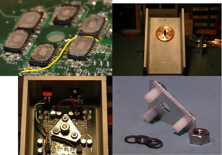

Bergquist (and probably others) produce various "gap pads" in all sorts of thicknesses that could be easily used to thermally connect the tops of the opamps to a metal plate. We used these quite a bit at work when chips didn´t get enough cooling through the underside.The opamps are higher than the other surface mount components so adding a heatsinking metal plate is probably the simplest approach if I want to tame these temperatures.
Then again I recall Jan Meier once built a power amp with many LM6171 all biased in class-A and he didn´t use any heatsink IIRC.

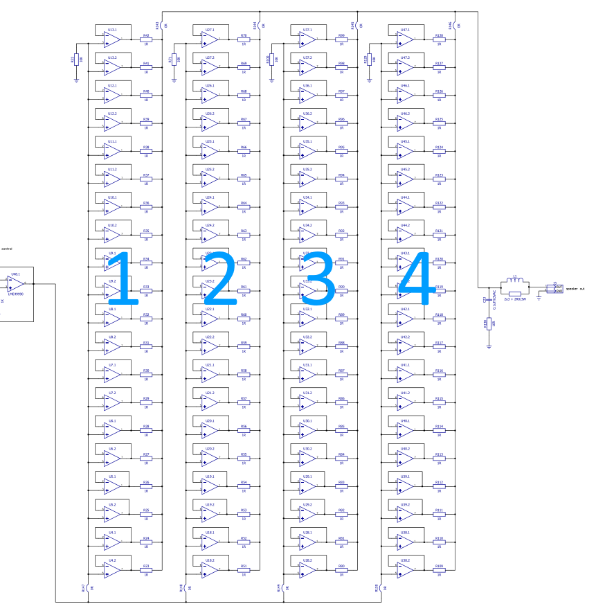

I’ve been using this ‘op amp’ amplifier almost daily for over 5 years now! When building it, I wondered if the high number of op amps would have ramifications for the life expectancy of the amplifier, but it turns out operational amplifiers are robust little wonders of modern engineering with all of ’em happily plugging along to this day.
Looking back, this is a crazy design, but I still think it has lots of charm. You certainly don’t see these every day and the performance is out of this world—a few years ago I used a few ultra-pure fixed frequency oscillators, notch filters, an external preamplifier and the QA401 to measure the distortion at about -130dB at 1 kHz and 2 kHz and a couple dB worse at 5 kHz. Too bad no speakers exist that could possibly match that. 😉
