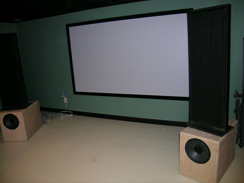

A little background: I own flat ESLs that are 14.5 inches by 42 inches that sit atop my (10 inch Peerless) 8 foot long tapered DIY transmission line. Now I love my t-lines, but my ESL stators are getting rusty, and most importantly, I am looking to get away from having my head in a vice just to enjoy the listening position. Plus I have just finished a home theater with a projector, and when I have people over, I'd like them to be able to enjoy the sound too, not just me.
Attached picture for reference: View attachment 374480

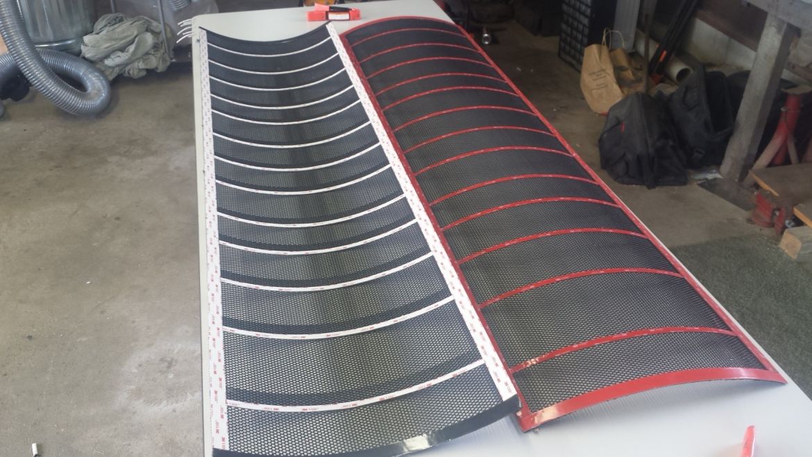

Hi Jer,
Just to clarify, it wasn't the VHB tape that shrunk, that's still adhered around the perimeter and ready to go...
The tape that shrunk or crept (not sure which) is the 'regular' 3m DST that I used for the cross-spacing that did that, that tape felt a little stretchy while I was applying it, and when I inspected the next day it had resumed it's original size I guess.
I had to break down and order more VHB (expensive), and that should be here soon..
cheers
-wreck
cheers
-wreck

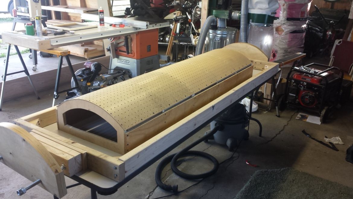

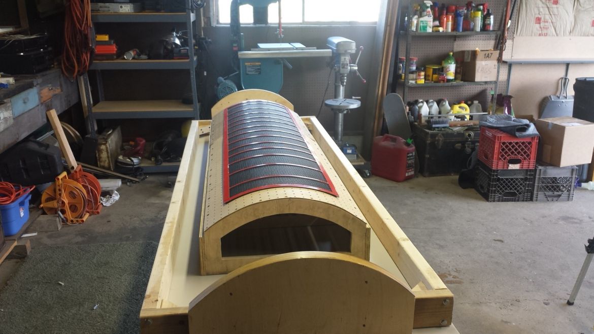

Well, a little progress here..
It turned out that the additional VHB tape that I ordered is not suitable for my project because of miscalculated thickness issues. I had to devise a way to cut down my existing tape to match width-wise, so I built a little tool to accomplish just that. (see attach #1)
The stretching jig is ready to go, and the DS tape is in it's final resting place.
(see rest of pics).
(see rest of pics).
