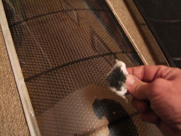

Shower is for the panels that are just pulled out of the speakers by the owner......so yes Shower bouth sides.....an thay may get better output...thay have not much to lose....if thay lose output...
i pull the panels a part so i can get to the mylar....that the front of the mylar only......glass cleaner works great for me......the ML mylar has a cotaing gos in to the mylar......just cleaning mylar well get them working agine.... most of the time
i well only pay vary littel for the ML speakers......the mylar can rip.. then there just parts.....so as not to lose $$.......$100. is the top paid......
Look when one panels gos week...as is the case on most older ML.....owner can just keep them for how thay look....pay me are others to put there new panels thay get from ML....for big $$....all panels start at about $2k. for the pr.....most dont spend the $$...thay try to sale....but the word is out on the ML panels cost.....so after thay set an are looking at them not working an no one well buy.....thay wont them out.....these are not small speakers....

Pic...1 this is not Coating coming off... an these panels had been showerd minny times......it crued an dust an you name it...
Geting to the mylar makes a big diff in the sound....
the ML coating in in the mylar......like used in making polly caps....

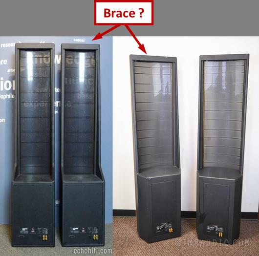

Are you talked about the brace at the top of the frame? (see pic)
You are saying that you have found this affects the imaging?
If your panel doesn't have the brace, you are suggesting a piece of tape in the same position will have a similar affect on imaging?
thanks for clearing this up.
I actually thought You were suggesting a long small strip of tape tacked in vertical direction onto the panel back-stator.
Placed from top to bottom of the panel in the middle or just slightly off-axis it sure would make a difference.
In the case here though, the brace is intended for stability reasons.
I did similar on my panels and never measured or heard a acoustical difference between the older non-braced Panels and the newer braced ones.
So I ather doubt that such a small covered strip of the membrane area could be able to change the distribution character.
Well then the brace I used didn´t cover active membrane area.
The brace used in the ML Prodigy doesn´t cover the membrane either.

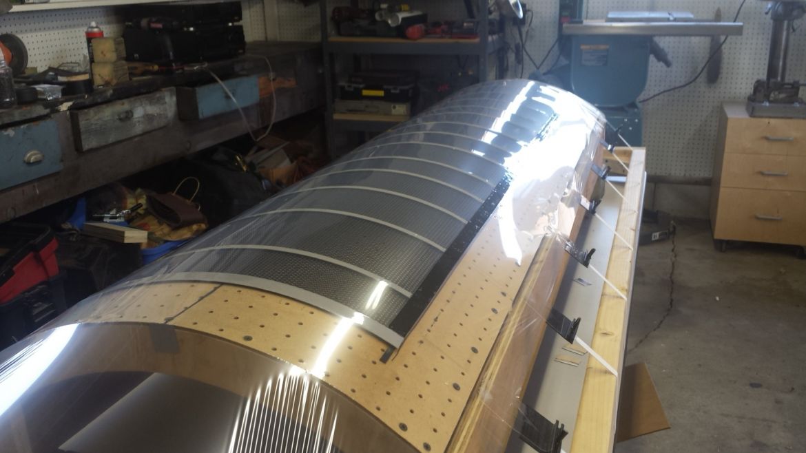

OK, I had some time to modify the stretching jig by using small strips of elastic material screwed to plastic, then only a small amount of (inflexible) shipping tape needs to be used...and it did the trick.
This time there if far less horizontal stretch being applied, and far less hourglass effect once the Mylar is adhered to the tape. (the last one ended up being tightened like a drum that's tuned too high)
I still have to wait for some more help to line up and affix the front stator, but once I do, I think the Fs will be much lower and closer to what I had in mind in the first place.
If that turns out to be the case, then I'll be forced by my 'pickiness' to re-do the panel that's already assembled... I am not looking forward to that, but I have a good plan if need be...
I took a couple of pics so you can see what's going on:
If you look close at the third one, you'll see that there's much less hourglass effect, the other two are instructive as well (I think..)
