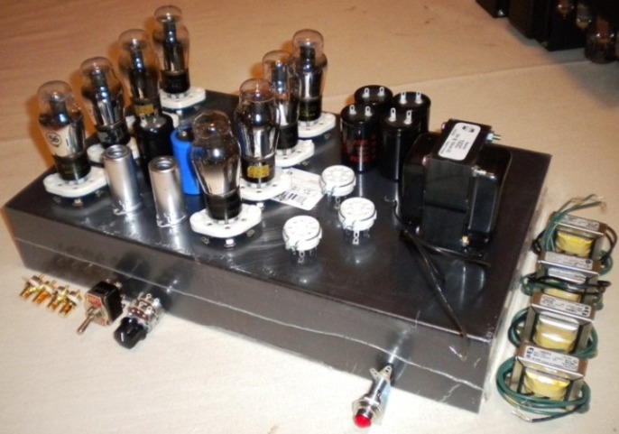

Olle,
Where you been? Have not seen your pictures in a while. This used to be your thread.....LOL , we sorta hi-jacked it lately.
Sorry.
In the meantime, I finished my build. here a link to my thread.Ron's Aikido pictures

Hi Ron!
No you didn't hi-jack my thread, you just borrowed it 😉 I don't mind at all!
And it wasn't off topic, it was just Aikido-stuff 🙂
Now it's a good thread with lots of information for aikido-builders! 🙂
Nice build! It looks cool! I must say your design is very unique!
And those round corners look good! Most commercial amplifiers I have see is often very edgy...
