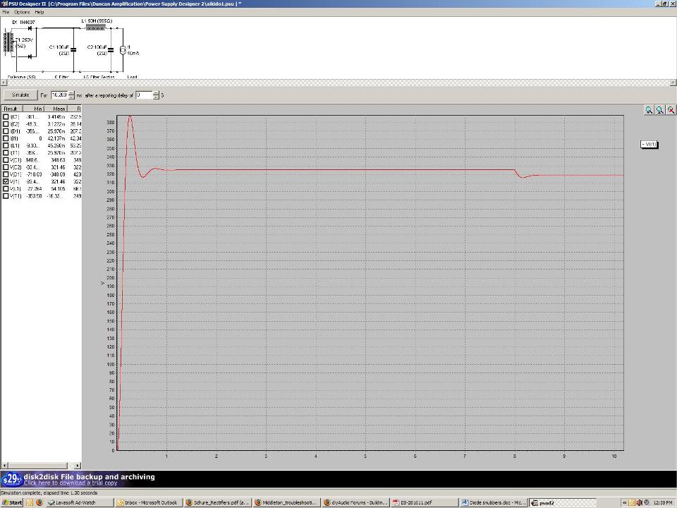

Perfect, use 51 ohms in PSUD for the tranny R.
You want the output voltage V(I1) to have minimal ripple, and little or no ringing/overshoot. Once you get the circuit modeled, click the V(I1) box and simulate.
You will need to zoom in on the voltage trace to check the ripple voltage.
After all that, you can also check for ringing/overshoot with a stepped load. You input stepped load in the constant current input box. Step it from 40 ma to 50 ma after 5 seconds or so to see if you get any ringing of the voltage with changing current. You want the timing of the load step to be during the steady-state portion of the voltage, so make sure the voltage is done rising (or settling) before applying the step (that's why I picked 5 seconds, YMMV)

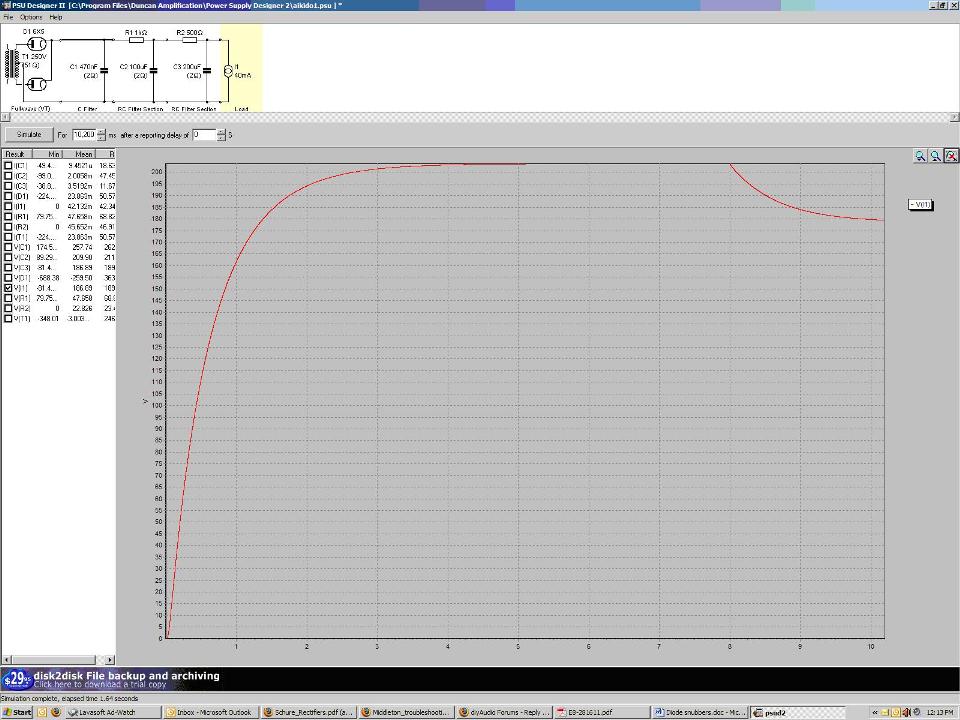

What would be a good amount of ripple?
If I use
C1: 470nF
C2: 100uF
C3: 200uF
R1: 1K
R2: 500
I get just a diff of 72 mV. This is the ripple right? The diff between the min and max Voltage.
Seems to reach 227 V after about 6/7 seconds.
This is cool stuff!
If I adjust the reporting delay to 10 secs and add 4.2 uF as C1 I only get 7 mV ripple. Almost flat.
This is all new stuff for me.
I plugged in this date as you mentioned. What am I looking at? How do interpret the downward falling curve?
Seems to drop 1.47 Volts after about 2 and a bit seconds.

Are the actual final caps on your PS board 100uf each and the final resistors are 1kohm? What is the secondary voltage of your transformer?
With your values above, assuming that your transformer secondary is 250V, I got this, which looks good:
If I try your 4.2 uf C1 value in the model shown, PSUD is giving me an error message that I'm exceeding the forward current of the 6X5.....
secondary is 275V
Current caps are 0.47/100/100
and resistors 1K/1K

Brit01: I just edited my post above. Are you seeing an error mesage when you simulate? Using 4.2u C1 with 250 volt secondary PSUD says that you are exceeding the forward voltage of the rectifier, and using .47u with 275V secondary I also get the message. You may be on the ragged edge of arcing over the 6X5. It appears to be just over the limit for the 6X5 data in PSUD.
Yes, your ripple looks good, about 20mv in my sim.
Yes I got that.
But not with 0.47/100/200
and resistors 1K/500
load 40mA
rectifier 6X5GT
275V (51 ohms)
load 40mA
rectifier 6X5GT
275V (51 ohms)
Brit01 said:Yes I got that. So I reduced this to 0.47uF and it's much happier.
It appears that you can reduce C1 (and C2) further with little impact on B+ or ripple to give yourself additional safety margin on the 6X5. Changing C1 impacts the excessive forward current more than changing C2.
