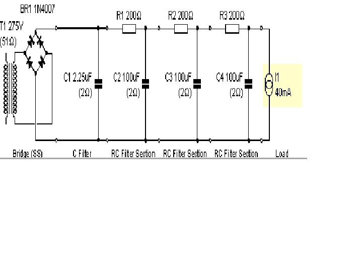

I want to build a SS rectifier now to compare. Any suggestions? Got to be simple with easily available parts (no chokes).
Also I want to look into building a power end to integrate with this now.

Brit01 said:
Not much to look at yet. All breadboarded.
Use PSUDII to model the SS rectified PS. I would do a CRC since you do not have a choke. A CRC will allow you to "tune" B+ in by varying the value of the first cap, same as your present design. A SS diode design will end up with a somewhat higher (B+) than your existing design. You'll probably end up around 300V B+ with your existing transformer.
You can add R-C sections to the CRC design for better filtering and reducing B+ CRCRC. PSUDII is your friend here.
Create the heater bias voltage divider by hanging the same two R values as your present design to ground and connecting the heater transformer center tap between them.
For cheap breadboarding I would use plain vanilla 1N4007's or UF4007's or so and for the final design I would spring for FRED diodes cheap $$ for increased performance. It's also a good practice to bypass the diodes with 10nf HV ceramic caps to mellow out the switching spikes.
Two big differences between SS and tube rectification are 1.) the SS rectification drops a lot less voltage than tubes, and 2.) it's not nearly as sensitive to the value C1 (no arc-over worries).
One downside to SS rectification is that you lose the slow warm up of the B+ (causing cathode stripping), but many folks on the forum don't think that's a big issue with B+ less than 1KV or so.

Brit01 said:
That's great info. thks.
Just to note I don't have a tranny with a CT. I created the virtual CT for the heater bias.
Do a Bridge rectifier config in PSUD, no worries.

Brit01 said:have a newbie question:
Currently I have the heater bias point from Bas's psu wired to a virtual CT on the 12.6V heater secondary.
With a SS circuit shown previously how does this work?
Would I attach the virtual CT at the top of the junction of the 2.25uF Cap? Between the C and RC section?
You need to create a voltage divider for the heater bias. Solder a 200K R and 100K R in series from B+ to ground between your filter string and the load. Connect your heater virtual center tap between the R's.
So, in between C4 and the CC load on your PSUD model, solder a 200k R and 100K R in series, be sure the 200K R is on top of the 100K R.
Example: Say your B+ is 250V
so E=IR, I=E/R
From B+ to ground, I=250V/300K (both R's)=.833 ma current from B+ to ground.
Calculate the voltage drop across each R
For the upper R, E=IR=.83ma/200K=166.66V
For the lower R, .83ma/100K=83.33V
Sanity check: 83.33V+166.66V=249.99V is the voltage drop across both R's.
Check the power dissipated thru each R: P=VI
for the upper R P=166.66V*.00083a=.132w
for the lower R P=83.33V*.00083a=.069w
The upper R dissipates twice the power as the lower, since it's twice the R.
Connecting your heater CT between the R's lifts the heater by 83.33V. You can use other values of R's to raise or lower the heater bias anywhere you want.
Large R values are used to keep from burning too much power, the whole chain is using .132+.069=.2w.
