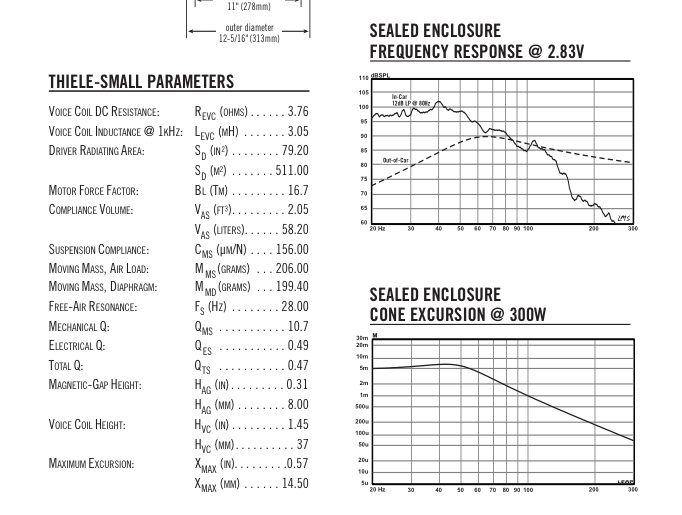

The simulation in post251 ran into a problem.
Are the L12, L23, L34, L45 correct.
Surely, L12 cannot be 200cm.
What is the nominal impedance of the driver in that post251 simulation?
Re=3r76 is too high for a 4ohm speaker and too low for an 8ohm speaker.
Is it effectively a 5ohm or 6ohm speaker?
It depends onthe enclosure used, but in general - it is named a 4 ohm driver.
What difference does it make if it would be called 4 or 5 ohm you think? It is
still the resulting box impedance that is of interest...

2.83Vac used in the simulation would be wrong. It would no longer be the equivalent to 1W.It depends onthe enclosure used, but in general - it is named a 4 ohm driver.
2V83 applies to 8ohms drivers. 2V applies to 4ohms drivers. 2V45 would be applicable for 6ohms drivers and 2V24 for 5ohms drivers.
Well, Mr. know it all...No, the simulation is not wrong! It is stated in the first
post that the input voltage is 2,83V. No one have said anything about 1W.
Read first, complaint afterwards
Any dB forecasts from the simulation will be wrong, if the wrong input voltage is fed into the data.
BTW,
personal attacks on Members are not within the rules.
Too bad Irony does not penetrate the written word. I have nothing against you
and did not mean harm, just that you should look things up first.
The dB forecast is no problem as long as you know the impedance.
1W, 1m giges an average of about 93 dB in 2 pi.
