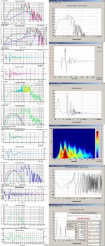

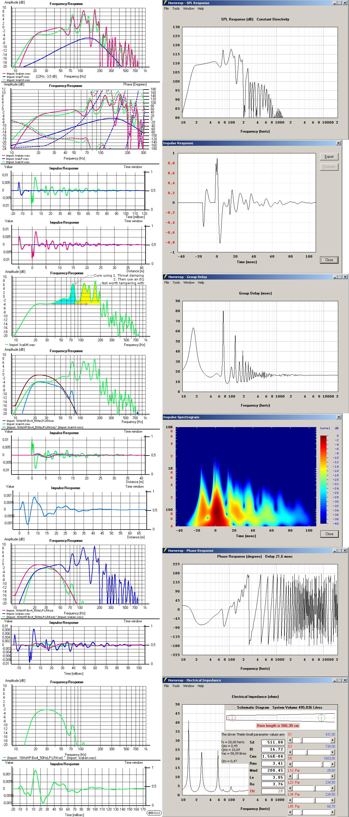

I have the sofsci measurement stuff now (+-2db 10-20 Hz, +-1db 20-20kHz) so I will be posting a more "correct" freq response shortly.

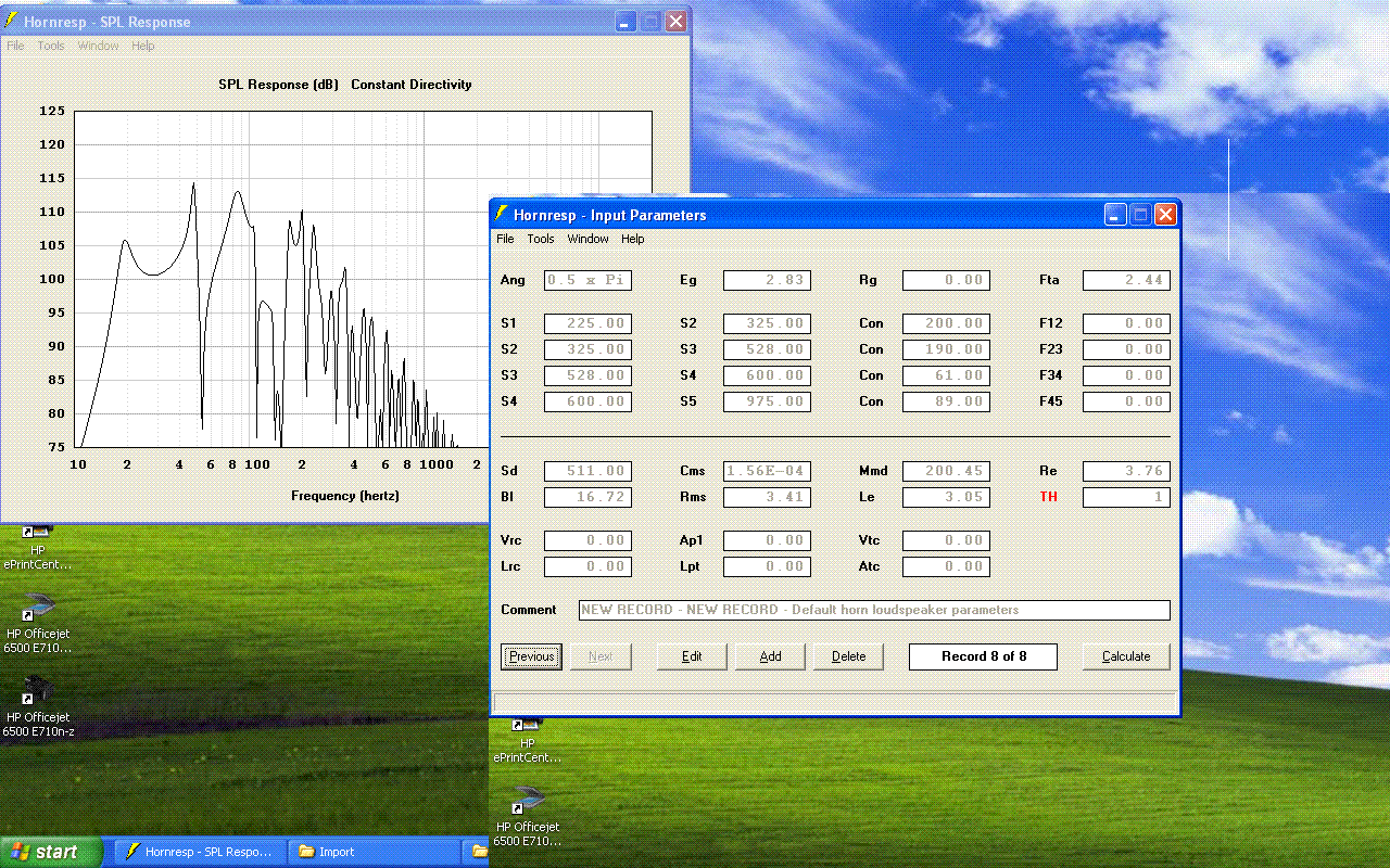

K112 SPL
I reenter the params changing conical to Exp flare and keeping the same values as one from K212 and the SPL is smoother. What is the number that is in the box for exp horn flare? It is not the distance as in the case of conical flare is it?

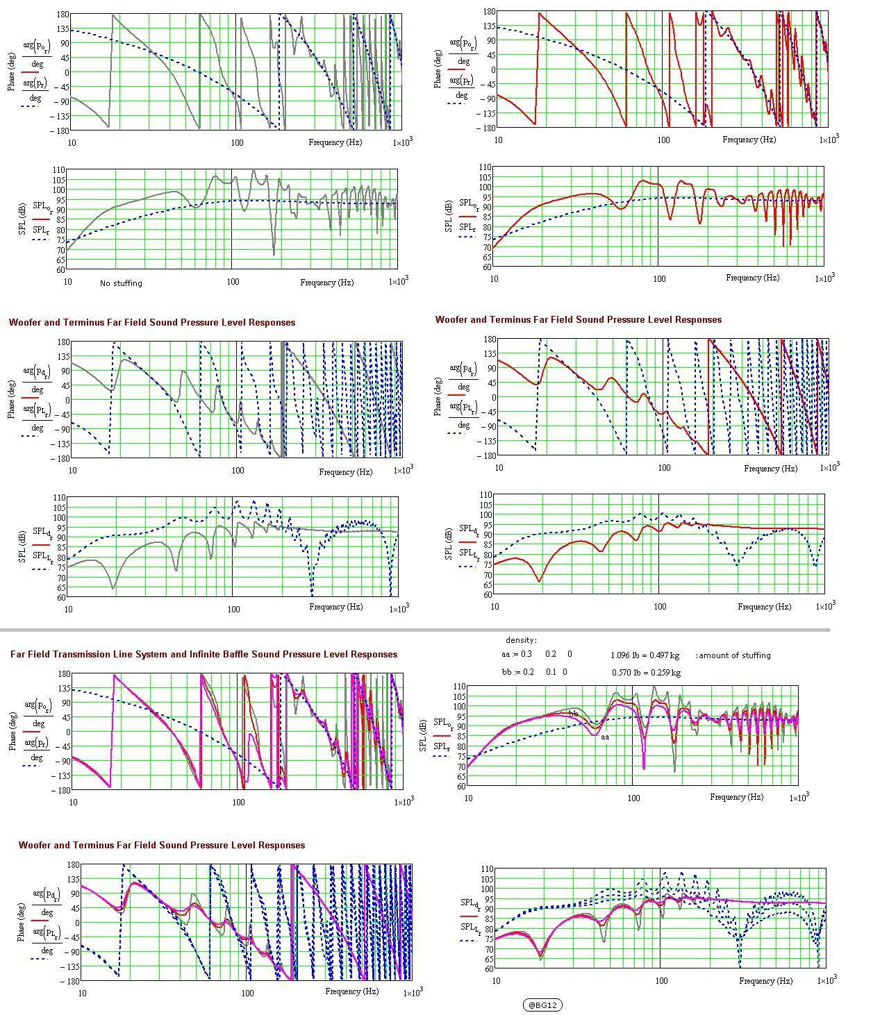

Any advice on stuffing would be appreciated, Maybe B could sim it. Please 🙂
