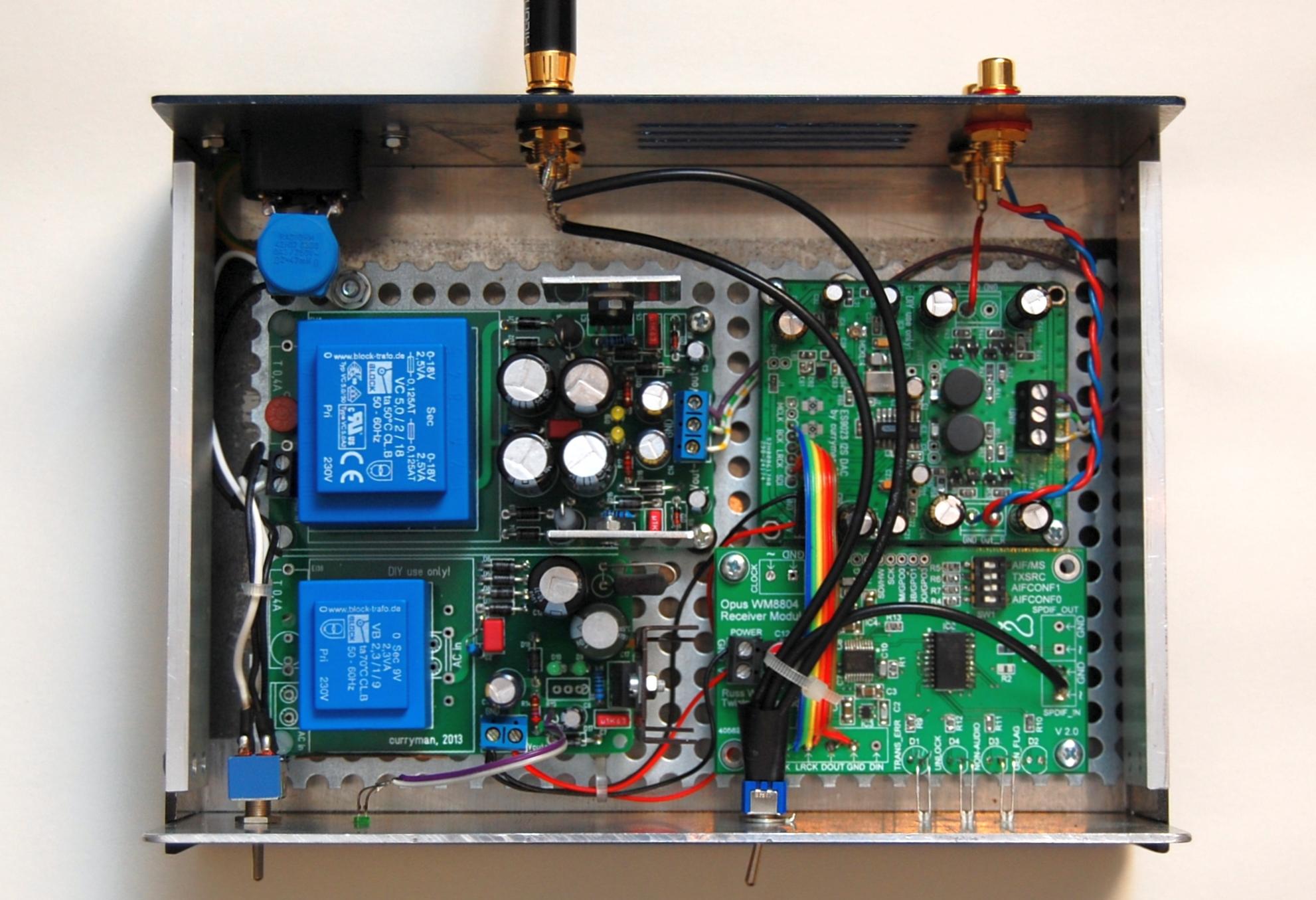

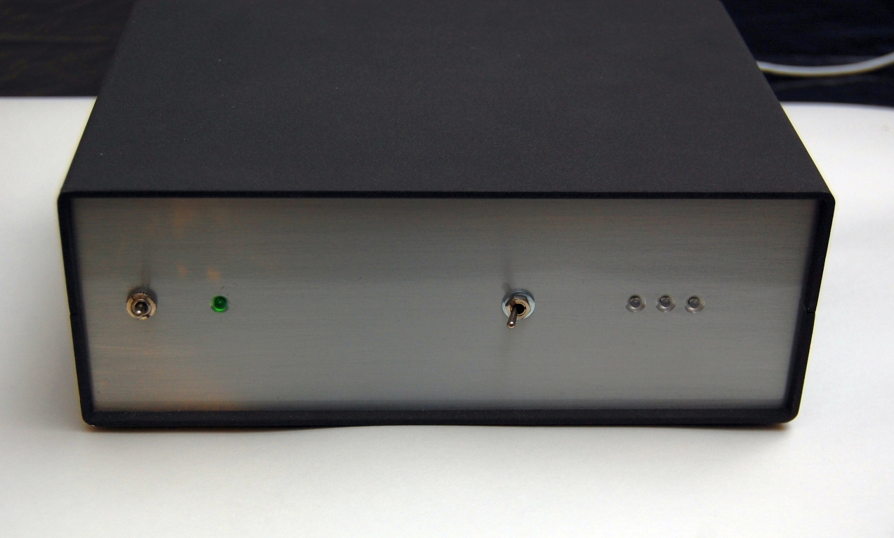

Although I was among the first beta-testers of the DAC board, it took some time to finish the whole thing including cabinet etc.
Now finally some pictures...
I used the curryman PSUs and TwistedPear SPDIF receiver board. With the input selector I could upgrade my CD player and streaming client at the same time.
Philipp

Looks good!
Only the mechanical SPdif input switch seems a bit troublesome to me. Some folks calculate the track width to match 75 Ohm, this is at the other end of the scale 😉 Doesn't the WM8804 offer multiple SPdif inputs? (for optical / coax)
Some screening plates in between the power supplies and the DAC / SPdif board could also help.
For the I2S flatcable, it will help if you take a ground line in between each signal line. This lowers cross-play and gives each signal "sort-of" its own ground.
Thanks.
I discussed the switching issue with curryman before and decided to give it a try.
The cables are 75 Ohm and the tiny switch is expected not to change the impedance very much (screen is also switched). Anyway SPDIF seems to be quite robust regarding the line parameters.

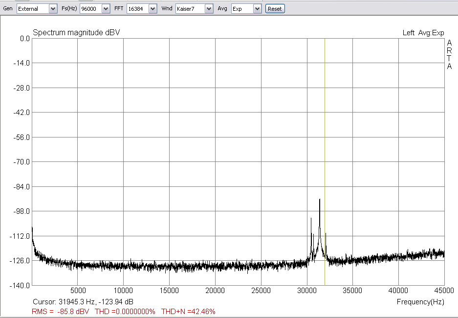

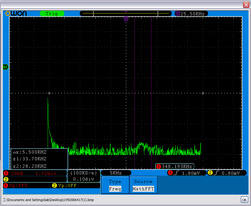

Can someone to feedback us, if there are some peak noise btw 30-35KHz?
I have attached an ARTA capture about this and an oscilloscope FFT (8bit) capture.
If you set the probe trip (without gnd clip on probe) on the ESS9023 at the upper part of dac-chip (btw pins 6-11), you can see in the oscilloscope display the peaks.

What are you actually measuring? Does the ARTA measurement show the output of the DAC without input signal?
What do you mean with "without GND clip on probe"? Is the probe "flying" above the ES9023 or touching the case?
regards, Daniel
Hi Daniel,
Yes the ARTA measurement (noise floor spectrum) is the output of the DAC without input signal. The same happens either direct output or buffer output.
I have a suspicious that this is an internal dac-chip problem because I have double THD to the right channel vs left.
With "without GND clip on probe" I meant the measurement with only the tip of probe (without the gnd clip) on touching the case. As closer to case as better the capture. At the following picture seems what I say...
Why do you measure with a floating ground? If you do not know the reference, the output is unknown as well.
The ES9023 has an internal inverter (to generate negative voltage), the noise you see can be a lower harmonic of the switching frequency of the inverter.

I also measured different THD right vs. left output channel (right is a bit higher though not doubled), however this is mainly due to different 2nd and 3rd harmonic. Can't remember that I measured that noise peak arround 30-35kHz but I will check.
This indeed seems to be a "problem" of the ES9023 since I could measure this in several different implementations (curryman DAC, Subbu DAC v3, ES9023 on SOIC to DIP adapter).
I agree with Hobbit13 that it doesn't make that much sense to measure with floating ground 😕
kind regards, Daniel
First I had seen the result from the ARTA and I observed the range of noise that we talking about.
I was thinking to find if there is area on dac that the fft has the same pattern of noise on this frequencies.
I see that if I have the probe tip over the dac-chip (near pins 6-11) the FFT lifts the same frequency region like ARTA...near to pin 1 there isn't this noise pattern.
The noise is out of acoustic range but it was strange to me! I haven't the appopriate technical documentation for the internal of 9023.
I have measure and another ESS9023 based dac and the right channel had more THD vs left, but was little. At the left channel mine is 0.0029 at the right channel 0.0058.
Daniel, I ''ll be so glad if you can check it to another dac-chip.
