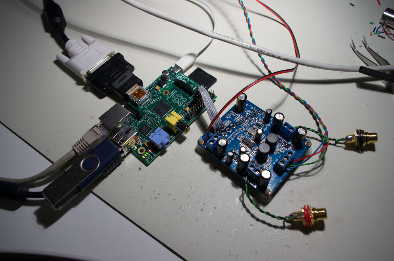

curryman DAC with Rasberry Pi
Today I tested the DAC with the Rasberry Pi. Works like a charm 😀
I am using RasbyFi with modified Kernel 3.10 for I2S output at P5 Header. Used my own setup however it is quite similar to the HifiBerry implementation. Currently I am using the ES9018 sound module which works good so far. Tested playback up to 96/24 FLAC, 192/24 will be tested next week 🙂
@Abel: One Filter for all will be OK. Most of the Filter effect at SMPS switching frequency and above (>100kHz) is coming from the common mode chokes and R's only add some additional filtering at audio frequencies (where PSRR of regs is quite good).

I tried with usb to waveio to I2s and works good, I would like I2s direct to the 9023.
Can you post link to the modded kernel?
thanks
thanks
In my above post you'll find the link to the Hifiberry homepage where you can download a modified kernel. Just did a short test and it worked for me too. I changed the soundcard driver to ESS9018 but this might not be necessary.
regards, Daniel
