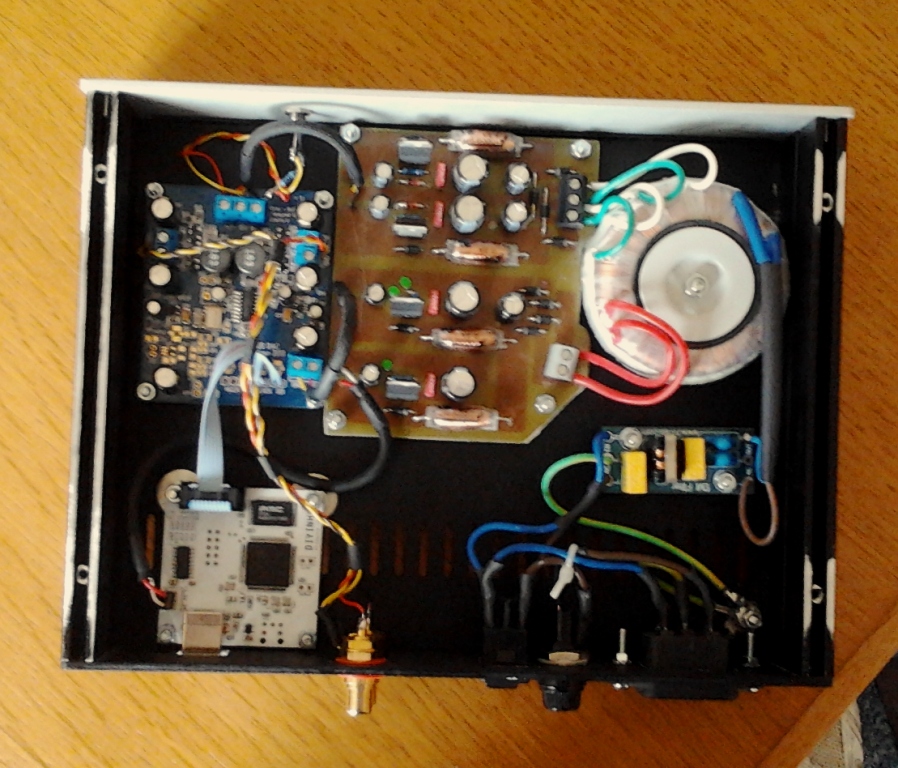

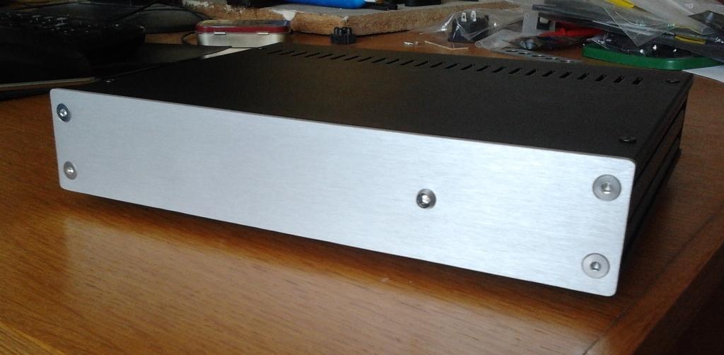

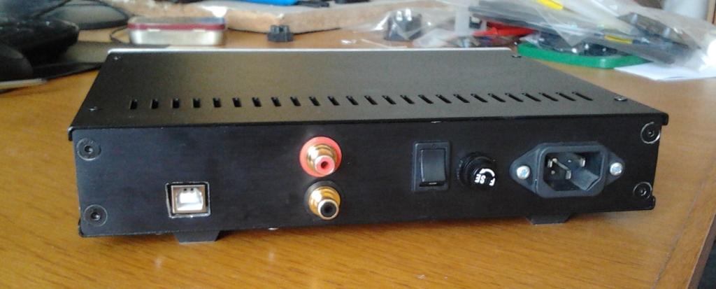

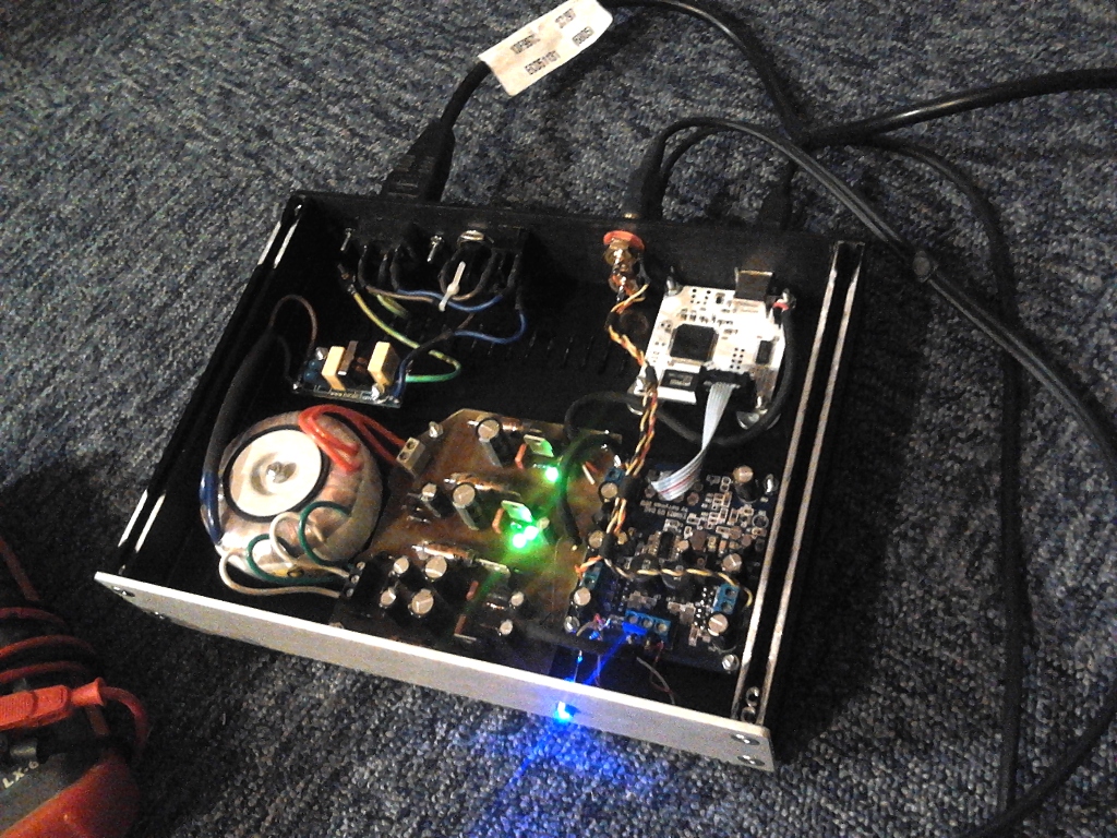

Just finished one
A very straightforward build, without any problem. A big thank to Daniel for designing that board and making it available. And another thank to Mullet who suggested me this DAC.
It sounds really good. The built was for a friend (he pays the parts, I play with them), so it'll go away soon but I could certainly live happily ever after with it.
The supporting parts are rather straightforward, the total cost was somewhere around 220€ iirc, shipping included:
- Power supply is based on C-L-C filters (470uF-10mH/14r dcr-1000uF) followed by lm317-337.
- USB input is provided by the CM6631A board from diynhk, which has isolated I2S outputs. Getting the driver to install was however a bit of a pain, no automatic setup would work (on vista business).
- Case is a galaxy gx247, rca are from Neutrik. I tried to make the build a bit cleaner than my usual wire nests.
Btw, DC offset is 2 and 3mV, which is quite ok. It's a pcb bought on audiophonics last week, from the new minidsp batch.
I attach a bad phone pic with bad lightning to illustrate the description. I'll try to make better pics at daylight.

I said I'd try... my phone's camera is really awful though. 😱
