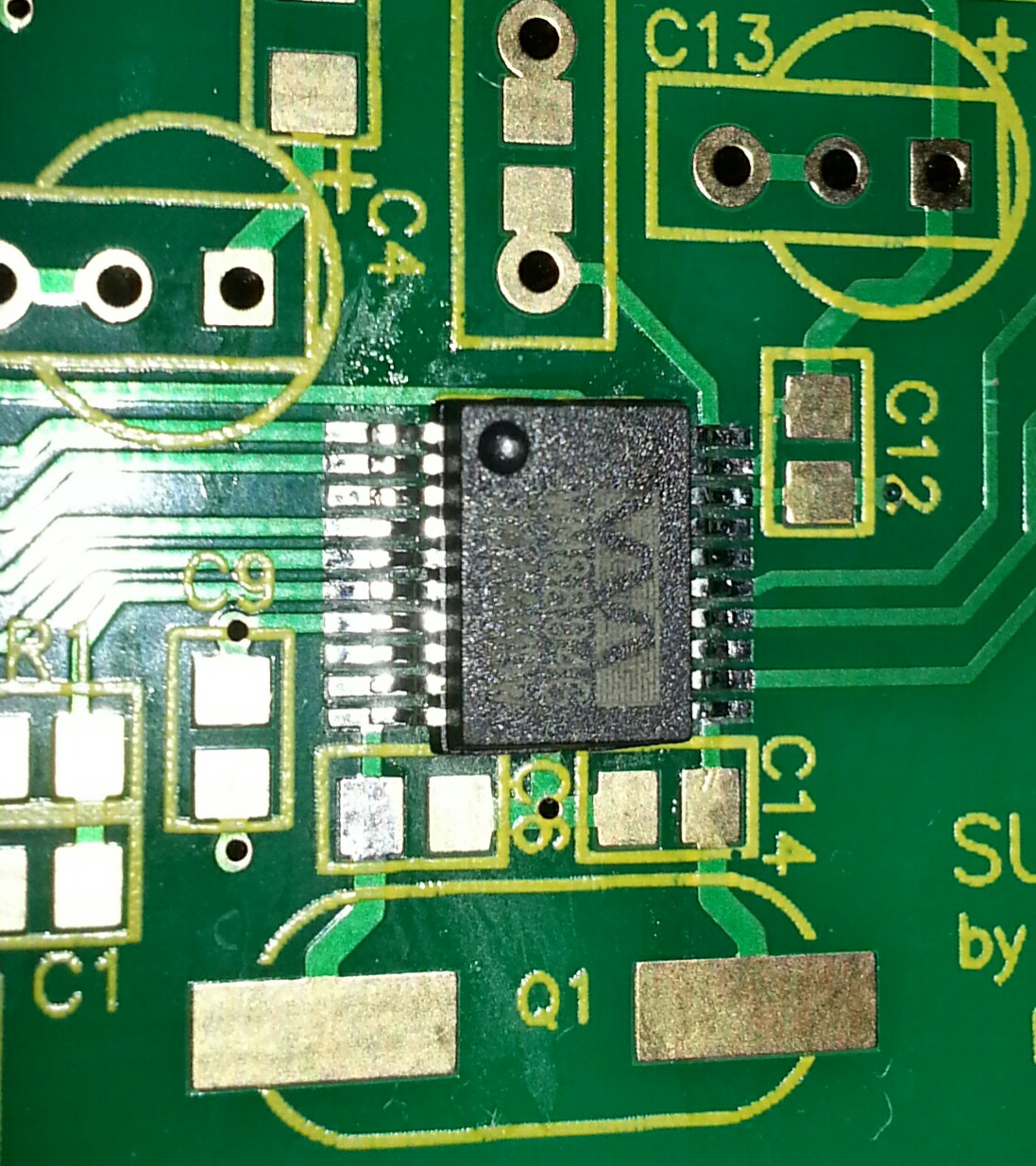

Now on we go with the DAC-board! Just soldered the WM8804, by drag-soldering, worked sweet!

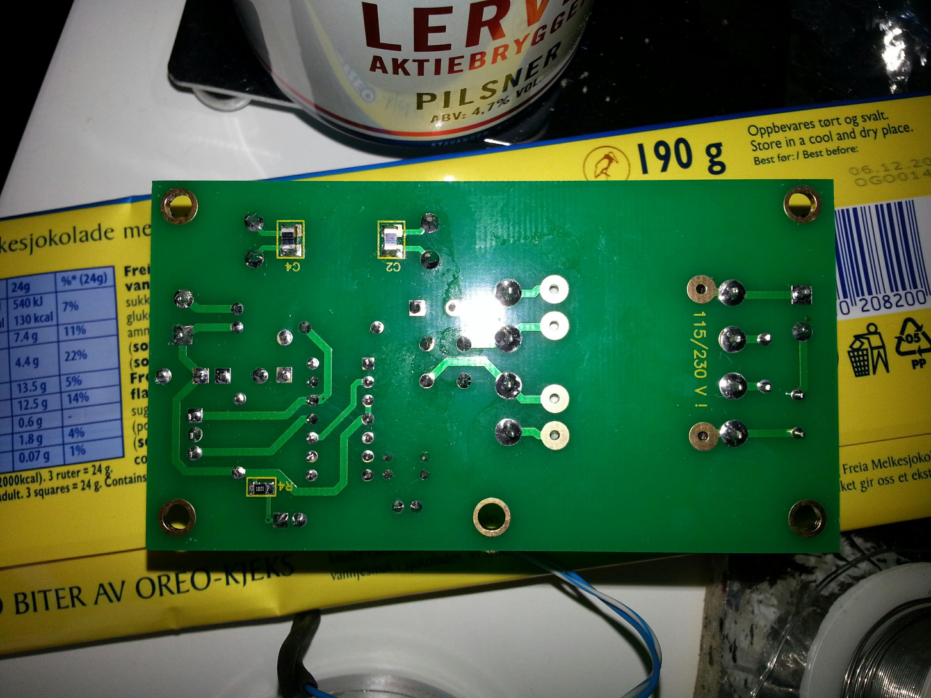

Only work I'm doing on the PSU, is changing the CLED, and I'll manage to do that with the cable attached. The cable and led are measured to length to go where I want it on the chassis-front. ;-) I got all my parts through Phil, and he did not provide the molex-connector for this led, so I figured I'd just make it permanent the first time, so I wont have to solder it again.
