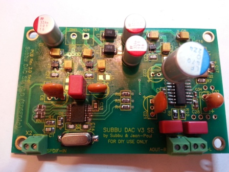

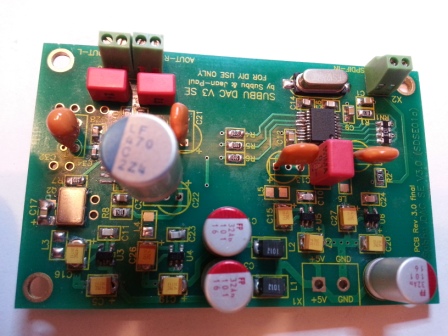

Guys I am facing a problem with 2 dac builds.
DAC 1:
- PSU working properly and outputting 5v.
- When I connected the PS to the DAC board to check voltages at L2, L3, L4 and L5 I found that the power was not entering the DAC. On doing a continuity test on X1 the buzzer rang.
What could be the problem?
Below are some pics of this DAC. C22 is soldered temporarily. Once L4 checks out and is soldered C22 will be soldered flush to the PCB.
DAC 2:
- L5 voltage is showing 3.1v. L2, L3 and L4 shows correct voltage.

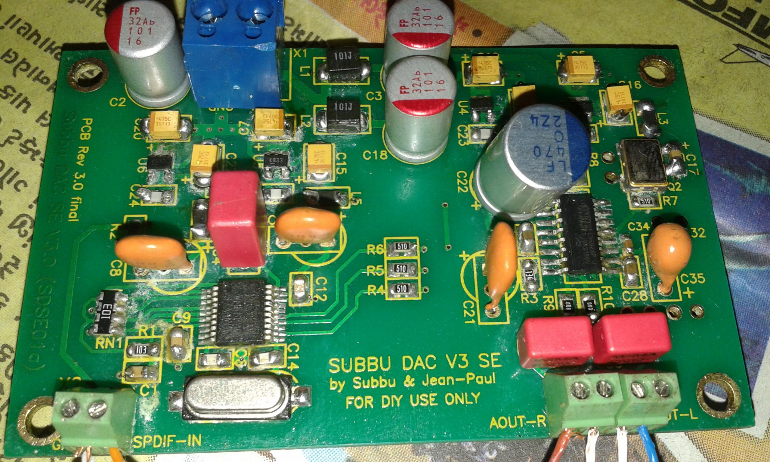

Hello All
I completed my build but to my dissapointment it is not working.
My PSU is showing correct 5.0v
Before soldering L3, 4, 5, 6, i had checked and all the values were correct.
All parts were used given by Korben except C17 and C22.
Attached is the picture of my build. Can someone suggest how can i proceed further.
For testing purpose i have used cat5 cables for spdif in and analog out.
Some of your solder joints are looking a bit dubious (cold) and you have used way too much solder on some of them.
I would check the voltages around the two IC's... someone has posted nice tables with the voltages earlier in the thread.
I suspect that you have power at the regs but something down the way is messed up.
Also C22 is damn close to some solder pads nearby and could be making unwanted contact...
Hello all,
I got the kit from one of my friend and built it according to the guide.But my problem is after taking all the correct readings,when I tried running it,there is no sound.I am not able to find out the fault.The only thing I found is my spdf input shows continuity.That is +ve and -ve and shows connected to each others in the circuit.I thing my spdf signal is getting grounded.I could hear the click sound when I turn on and off the DAC like any circuit make a sound.
So please help me to find out the possible problem.
Thanks.

connecting your first DAC to the psu you don't have any readings on the mentioned L-pads?? That is a very short way from the input X1 to L2... so I wonder what went wrong here? :scratch:
Your images are way too small to do any troubleshooting, pls. post some higher res images. Other than that you can only proceed with the usual steps: visually inspect ALL solder joints with a magnifying glass, carefully reflow the ones that look iffy and try again. You should at least have readings at all inductors before you take the next steps.
PS. I don't have any experience with the used regulators so can't comment whether 3.1V is acceptable. Have you checked further down, like around the chips (see what I said to Darshanjoshi)?

DAC 1
Have you 5V on the 5V mentioned screw of X1 when GND voltmeter is put on the other screw ? Look at the PCB screen picture if the connector hide the "5V" mark on the PCB.
(problem with wires between the PSU and main board ? shortcuts on X1... argh ?)
DAC 2 : offical BOM for the LDO regs ? I have a similar problem with one pin of a reg which lake of soldering... check also if shortcuts on the regs pins with X10 glass and DC buzzer... but I think if similar to my problem there is one pin of the five wich lake soldering...

DAC 1:
PSU is outputting 5v at X2. LED of PSU lights up. As soon as I connect PSU PCB (X2) to the DAC (X1) the LED of PSU switches off. X1 5V and Ground connected properly but current not flowing from PSU to DAC hence I am unable to check the L values as no current seems to be flowing into the DAC and X1 shows 0 volts when connected to PSU.
When I did a connectivity test on X1 without connecting to the PSU 5V I got a buzz. Maybe something short somewhere.
DAC 2 (my friends Dac):
I managed to get the correct reading on L5. One of the legs of U5 wasn't soldered sufficiently. Re-soldering it corrected the problem.

Ok, i can start to help you for some basics check, others will follow for more complex check.
So i suppose you don't make mistake with connecting X2 +X1, because the other PCB of your friend is working with the same connection with the same powersupply PCB.
On X1 (without the powersupply) : when you test with the voltmetter buzer DC function : have you a sound when you check the 2 hole pins of X1 ?
If yes, shortcut somewhere...
First regs near X1, three legs side of the regs : any shortcuts ?
solder flux below tanatlum caps which join the two polaraty (= shortcuts) ? easyly checkable with the DC buzer.
Checks all the regs with DC buzzer after read the datasheet to look for shortcuts.
You use too much soldering...need maybe a thinner Ironstick (read the entire thread if not already) and the youtube video about smd soldering...
that's all I can advise with my few knowledges...
