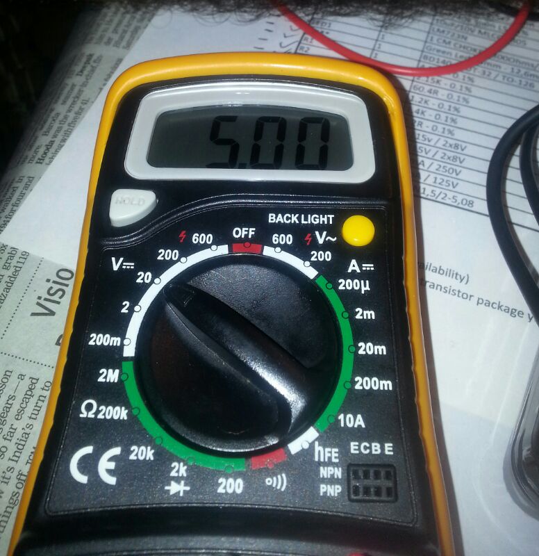

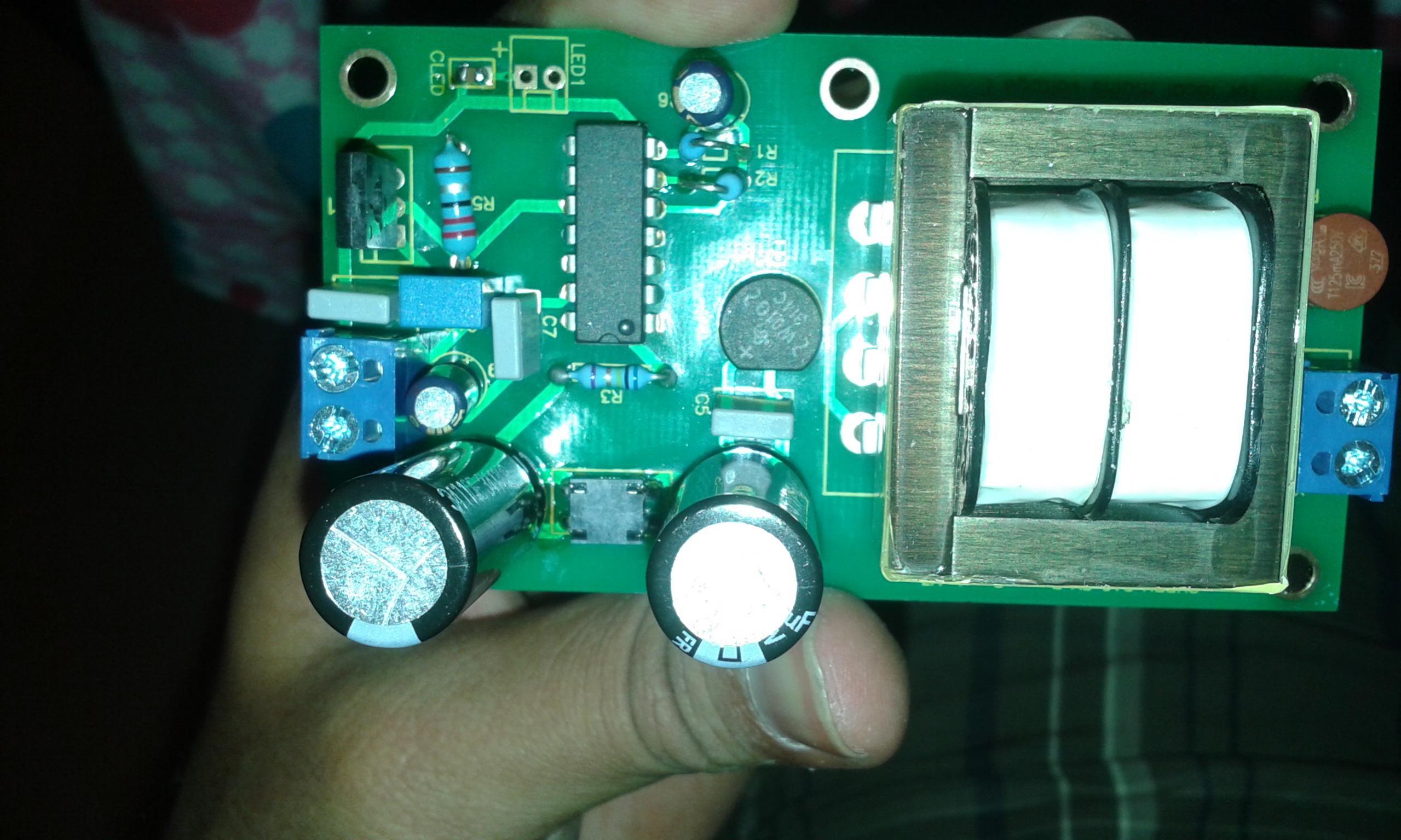

This is my first DIY build ever. Hence going slow.
Just managed to complete the Power Supply. Checked 5-6 times and got 5.00 V reading. Guess I am good to go for DAC board.
