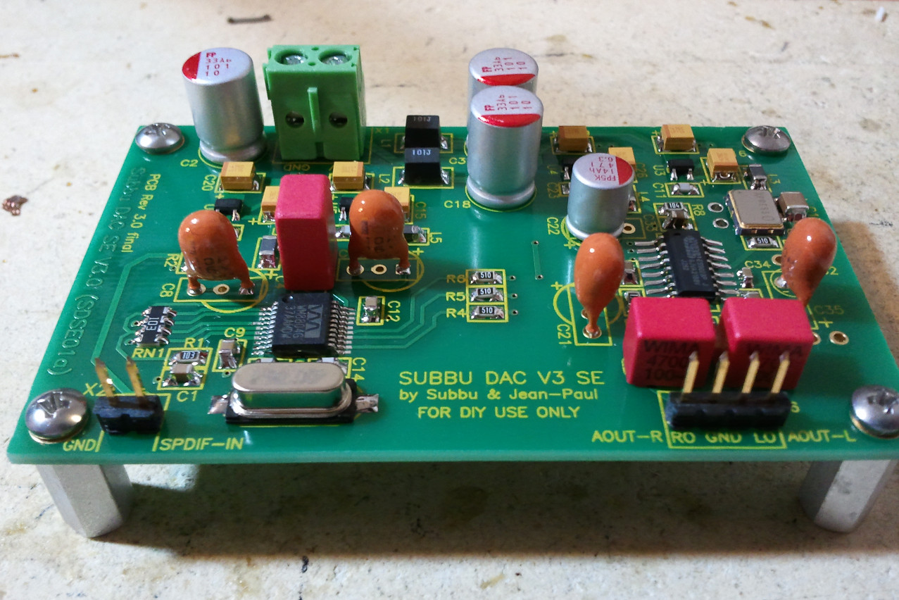

i've finished mine a couple days ago (well, except for the enclosure). initial impressions are very positive.
i went with a 9.4uF specimen of the sal-rpm for C35; also using 1uF at C34. would it be worth it to sub out a 4.7uF wima polyester for the sal-rpm? i have the 4.7uF EEUFC1H4R7 on hand too.

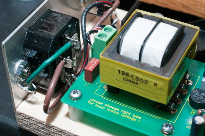

What transformer did you use
I was using an older 8V EI-transformer I had on hand... generously overspecced.
Any 9V 10VA print transformer should do the trick. But let's try not to pollute the DAC thread with Salas shunts...😉

You could but I haven't directly compared my V3 SAL-RPM with the Wima versions so I can not give a guarantee it will perform a tiny tad better. It could just be that the DAC performs better with 10 µF SAL RPM than with Wima MKS 4.7 µF. You could try and test that. If the board was heated a few times already I would leave it like it is now.
BTW I like your build. Nice soldering with care for details. I know I will be laughed at but I solder the Wima output filter caps "direction" sensitive so one with text at the front and the other with text to the other side.

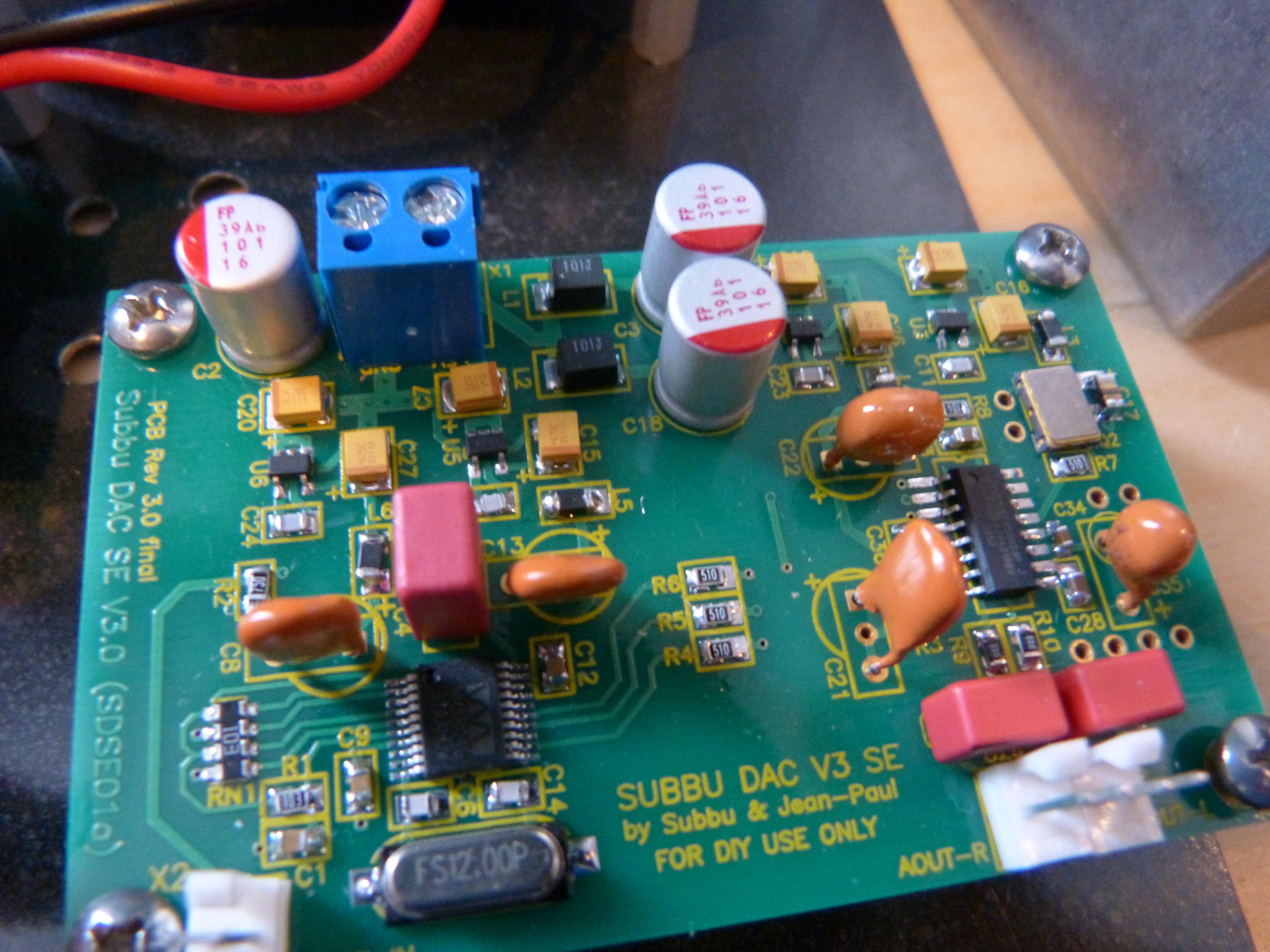

SB V3 with battery powered JG buffler/filter

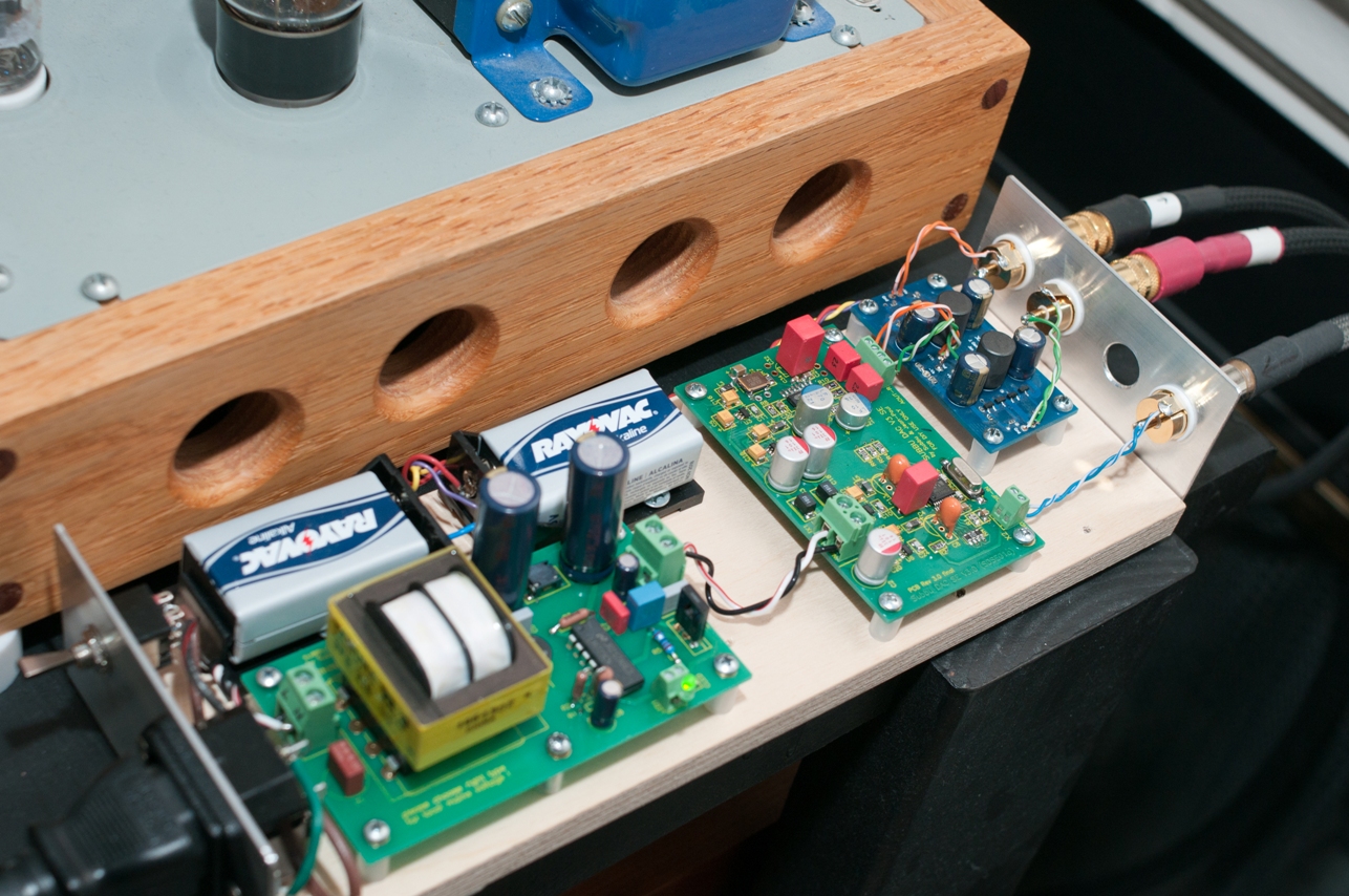

I finally put the JG buffler/filter in one of my SB V3 dac. My impression are very positive and delight. The music give me a more relaxing and three dimensional presentation.
I have tried several type of cap for c35, the one that pair with the JG buffler/filter with the Wima 4.7uF. c17 with the 1uF MLCC, 470uF for the c22.
The other board build base on the BOM with SAL caps. later I changed the c17 with 1uF MLCC, 470uF for c22 and c5,c7,c19 & c20 with 1uF MLCC. These 4 caps give me very subtle change so I decide not swarp these cap on the other board.
Here are pics from my build:

i knew there was something i forgot!BTW I like your build. Nice soldering with care for details. I know I will be laughed at but I solder the Wima output filter caps "direction" sensitive so one with text at the front and the other with text to the other side.
with regard to soldering, i've found a method that works well for me. i do not tin the pads beforehand; i carry a small amount on the tip and tack down one end, add some flux to the other, and then finish the part. if i find the initial tack isn't good enough i add more flux (and maybe solder) to that side and reflow for a nice taper. i think pre-tinning one side leaves potential for uneven part placement, since you have to move / align the part through the molten solder; and, it can potentially require more heating of the part. quickly removing the iron helps prevent any stray "solder tails" from occurring during the cooling process. i cheat a bit for the es9023/wm8804 and xpresso crystal. a small sliver of electrical tape is placed over the part and the part is aligned to the pads as well as i can see. i then user a jewler's loupe to ensure the best alignment possible. the stretch of the electrical tape allows rearranging the IC a bit (versus say, kapton tape, which has no stretch at all). for the capacitors, i used to mess with a third hand and various stacks of index cards to align the part straight on the pcb. but for this i just held the PCB and part in one hand and tacked down a single lead with the other. it worked well here. ymmv of course.
i will leave C35 as-is unless someone offers more evidence otherwise 🙂

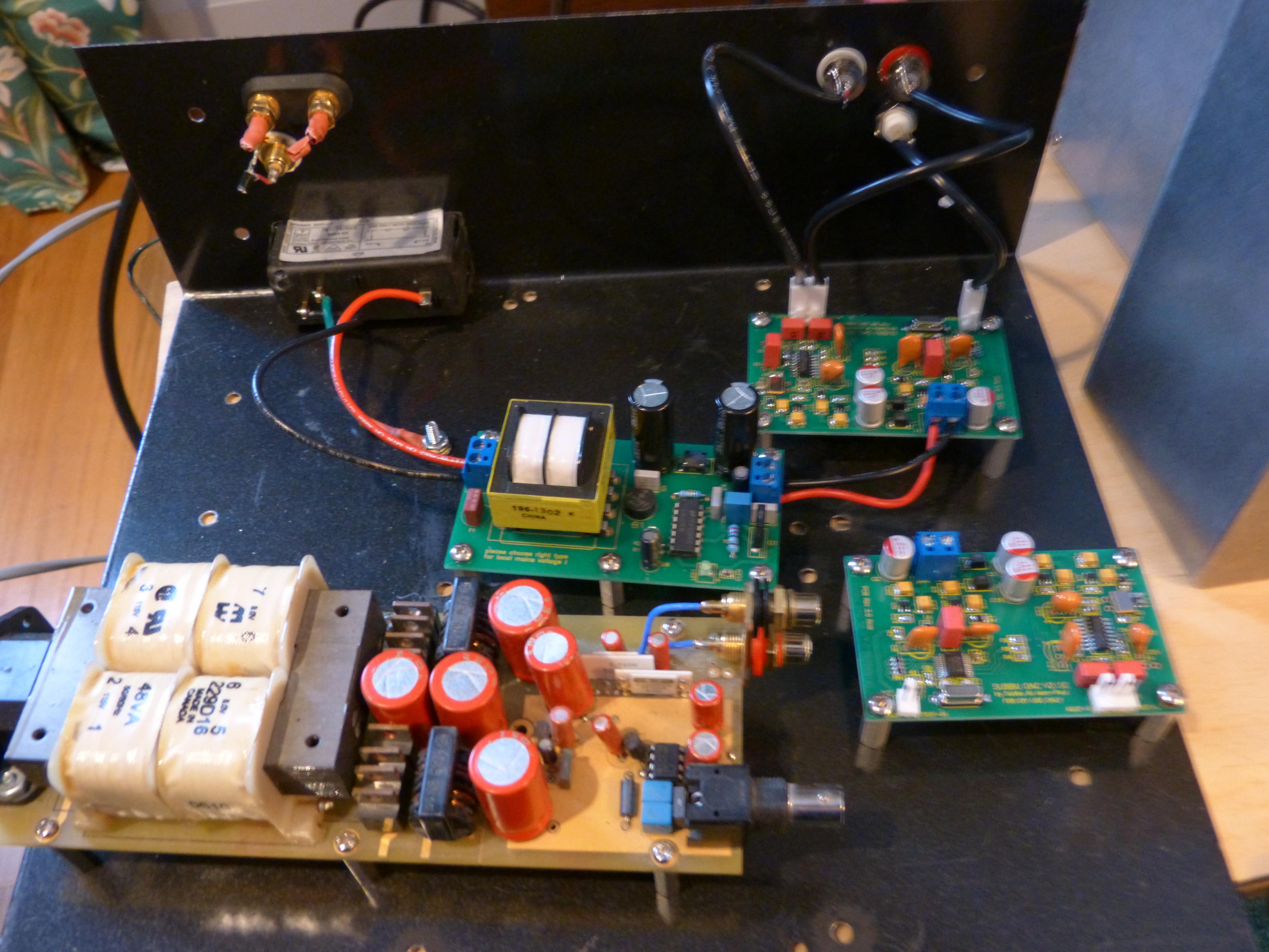

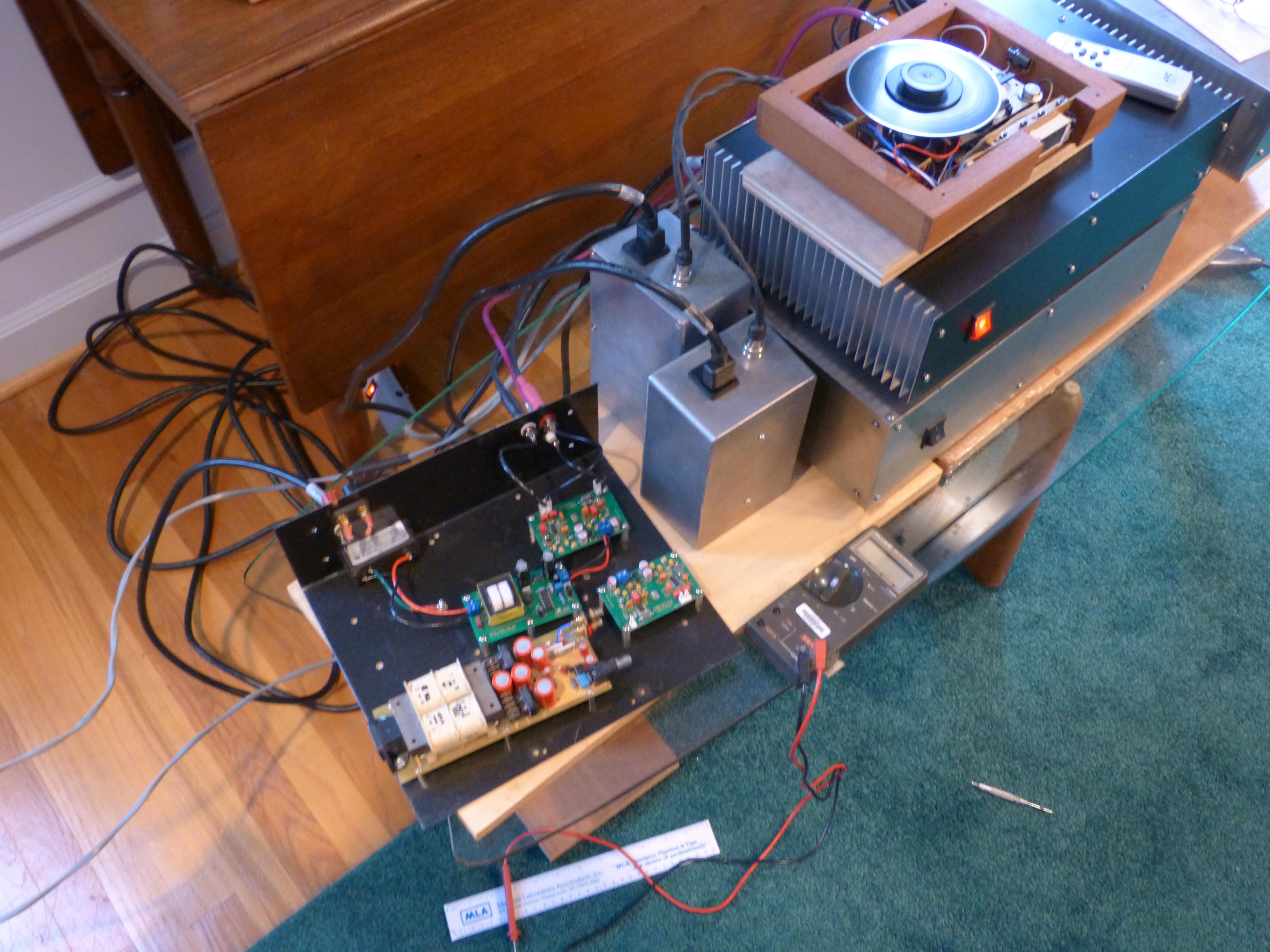

DAC Shootout

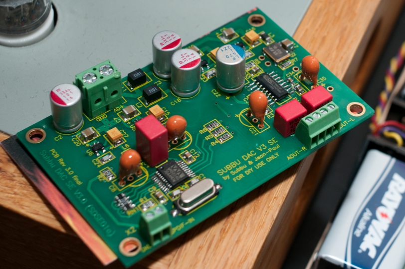

Hi all,
I have two versions of the Subbu V3 and comparing both with my TDA1543 NOS Dac. You can see all three competitors below. As you can tell this is my first SMD project.

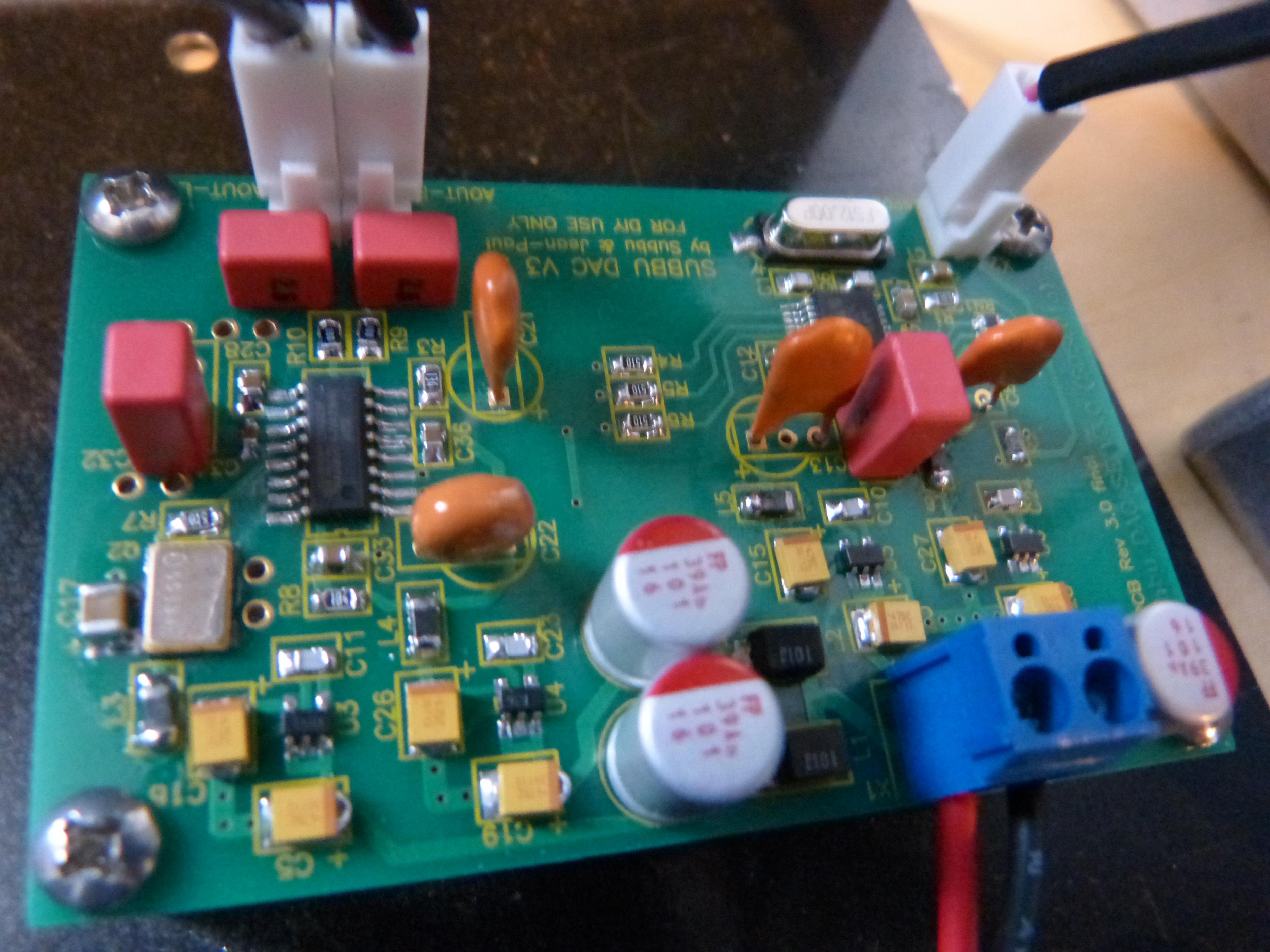

The third photo is my first Subbu with the GB parts. SAL-RPM 10uf for C35, a 1uf X7R for C34, and C31 not populated. I prefer this over the NOS. There is more detail in the midrange and the bass is slightly more recessed yet deeper and more detailed. It is more relaxed than the NOS.
The fourth photo is my latest Subbu. It has only 10 hours, but is already my favorite. The midrange is more detailed still, especially vocals. The bass seems slightly more recessed, but it may be because the midrange is more smooth and detailed. The difference is Wima 1uf for C32, 1uf X7R for both C31 and C34, as recommended by Jean Paul.
To go off topic, I experimented with use of my DCB1. I used it as buffer both before and after the volume control, and then removed it altogether. My favorite setup is the Subbu-VC-B1-Amps.
Thanks to Subbu and Jean Paul. My ears are very happy. I have a case on order too.
I'm ready to mod the first Subbu Dac. Any recommendations on what to try? Thanks everyone.

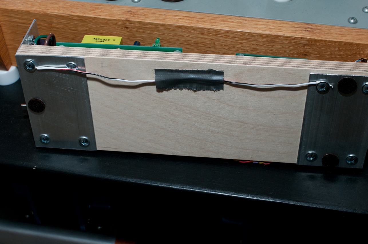

I wired a single 22awg strand wire from the bottom of the aluminum angle that for the RCA jacks then bridge to the other aluminum angle that hold for the IEC power entry. One of the bolt/nut of the IEC tight down the wire eyelet then solder that wire to the IEC ground pin. Since this is for my own use and I know it 's not up to the code but I do have the intention to play safe first.
Here are pics for the ground layout on my own build.

For those that would like to try this "Wima 1uf for C32, 1uf X7R for both C31 and C34" setup for Vneg (don't do it if you had difficulties building the DAC). You will need a 1 µF 0603 X7R as in the BOM, a 1 µF 50 V X7R 1210 and a Wima MKS2 1 µF 2.5 mm pitch...
This is the Wima that fits exactly on the PCB, it has 2.5 mm pitch and is far enough from the XO because of its smaller size compared to 5 mm models. Bonus is that you don't have to fiddle around with too wide lead wires.

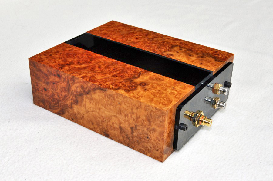

The only thing that bugs me now is that I have to build a really nice case for the JP-DAC to match my Peter Daniel NOS 😛
Wow, Stixx. That is the finest case I've ever seen. I was also thinking about the NOS upgrade but will now concentrate on Subbu tweaks. I liked the NOS concept and would not have minded if it triumphed in my listening sessions. I get too emotionally attached to gear. Plus I had a lot invested in BG caps and caddocks. The NOS plus shigaclone was a huge step forward for me. But now Subbu is king. I'm wondering how it compares to the other top dacs.
