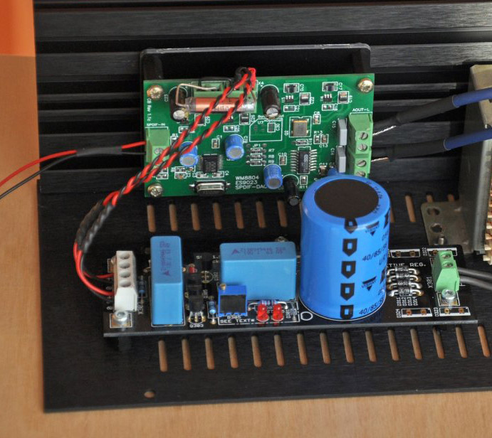

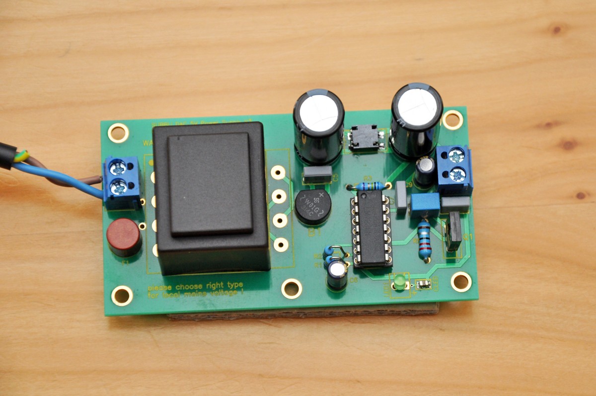

Finally got around to connect the ES9023 DAC to play some music...
I finished my build with the parts from the GB except a few changes due
to parts I had in my bins. C2 is a 330uF Sanyo SVP, C4 is 1uF MKT //
with a 3.3uF, C21 is 10uF Wima from the bottom of the board and C22 is
0.1uF 400V PP // with a 100uF polymer for now.
I am glad that it works trouble free (this being my first SMD DAC), and since
it is connected with flying wires and without the JG Buffer that is planned to
go with it I don't have a final verdict, yet. But after a few hours of running it
and two hours of listening I can silently utter 'holy ****'.
For such a small investment and after such a short waiting time 🙂D😀😀) this
really is a winner. In my world of audio I'd call this sounding relaxed, uncoloured,
absolutely open while revealing ALL the subtleties, and natural.
Bravo!
:worship: to JP and Subbu
