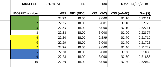

MOSFET matching results
Hello,
I've been slowly gathering the required bits and pieces to build the NTD1 and I've finally finished matching the mosfets.
I have the V4 PCB with all SMD components so the mosfets are those specified on the newer BOM: the FDB52N20. I only ordered 10 of them for now to test the matching process. I used the matching instructions Owen posted, with a lab power supply set at 45V and a signal generator at 1kHz. The D2Pak format of the mosfets was a little challenging to work with (tried to avoid soldering/desoldering each one while still having it on a heatsink).
The results show a smaller transconductance than what was measured for the FQA32N20, so I'm wondering if my measured values look ok?

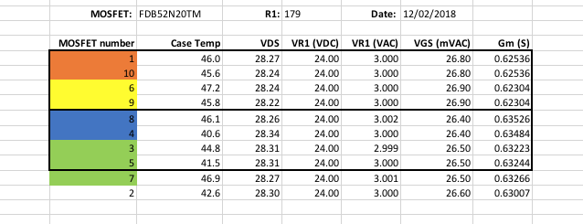

I just noticed that I didn't adjust the testing rig to account for the decrease in supply voltage from 45V to 38V for V4 of the NTD1.
Given that we want about 100mA of idle current, I would adjust VR1 to 18 VDC (Vds of 20V) and keep everything else in the rig the same for the measurements of Vgs and matching for Vds?
To follow up on my question, for anyone else that may be wondering the same thing, I can confirm that Vds should be 20V and the voltage should be adjusted to obtain 18V across R1 when matching mosfets for V4 of the NTD1. Those were the exact measures I got after finishing the NTD1 and measuring everything on the board.
These are the values I got with the appropriate settings for only 10 FDB52N20. I used # pairs 6-7 and 5-9 for my NTD1, so would have #1-2-3-8 that could be used for another V4 NTD1 if anyone needs them and doesn't feel like matching mosfets.
