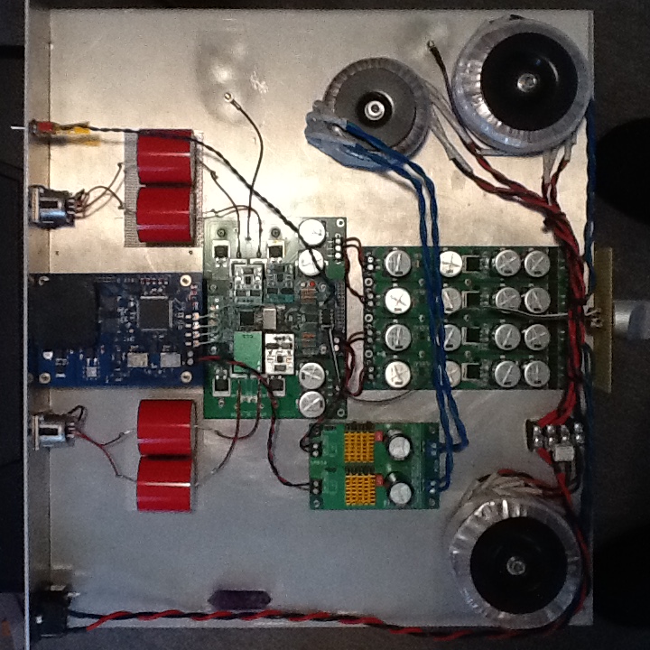

side note: few pics of your NTD1 maybe?
Yup, it is usually impossible to do true apples-apples comparisons! Especially with the 9038 as it requires a different output stage. But I look at the specs of the 9038 and know it is better than 9018 (and the ESS guys use a golden eared listening panel to inform their changes in addition to measurements), so now the task is: how to get the best out of the 9038. I know Russ worked on hard on this, and Mercury is the current result, so that is what I am working with.
My NTD-1 is V.4 with power supply, and Clarity CMR 3.0 µF coupling caps. The coupling caps are another variable, as I tried a few different approaches before settling on the CMRs. Each different cap choice changes the sound, transparency, and tonal qualities. At least with Mercury I need not worry about that!
Looks like there is no way to directly add photos here without first hosting them somewhere. That gets kind of convoluted. I did take a quick iPad snap of it for you, so if you want, PM me your e-mail address and I can send it out.
Damn, another variable in setup! 🙂
Strange I can upload pics with the "Manage attachments" box under the text window, maybe system/browser dependant.

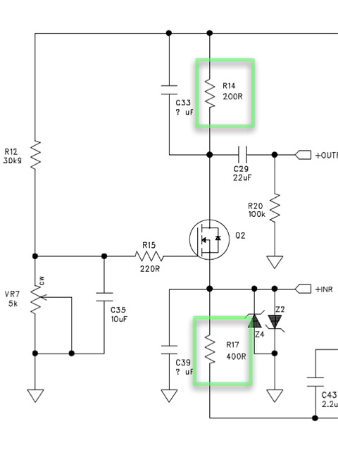

Guys,
I'm out of steam when it comes to the circuit itself (V4 in my case), and my memory is a black hole.
Owen about the V3 said:
(...) Rails have been reduced to +/- 38VDC. This is a tradeoff between going to far better regulators, and slightly reducing bias current for the same given gain. Idle current is now 101mA if you use a 180R/390R resistor combo. It's slightly lower at 99mA if you go with the usual 200R/400R combo. (...)
There was that shet to calculate power and bias current, ok, but when I put what I do have, 200R/470R I got a lower 85mA when it seems best is around 100mA. It may change gain also. Anyone can explain me the parameters we balance here again?
Matthieu
Guys,
Matthieu

Right, I've been busy! I ended up going for option 1 which was a literal swapout of the 9018 boards for 2 x 9028pro boards. Russ and Brian produced a test dual mono firmware which Brian kindly included with my order. It didn't take me long to do the board exchange although I needed some help from Russ as I didn't realise that I needed to connect the DAC reset pins together along with the other tweaks to get dual mono to work.
I was worried when Russ stated that boards can have up to 14% differences in output levels. However, subjectively this doesn't appear to be a problem.Maybe I was lucky.
The DAC itself is now made up of:
Sonore USB board > Ian's McFIFO with Pulsar clocks > 2 x 9028Pro boards > NTD1 > duelund coupling caps
Everything is powered by Paul Hynes regs.
The hardware in this listening test was a constant except the DAC boards. Some listening was done at 44.1 but mostly PCM oversampled to 352/382 using the (excellent) upsampling facility in the USB card. Also, all the DAC board filters etc have been left at default for now.
I was hoping to finally be able to play some DSD given that now the FIFO is DSD-compatible and the DAC boards are effectively DSD plug-n-play but for some reason I cannot get any DSD to play. I suspect it's an issue with the USB card firmware but I'm investigating that separately.
Anyway, what do I think...
In a word, great! It is not a night-and-day difference but a glare or digital shimmer has been removed from the top end. This takes a little getting used to and a couple of tracks sounded a little bottom-heavy to start off with, but there is now much more nuance and detail across the frequency range. There is an increased precision and immediacy to the sound - I think caused by better transient response. This increases the naturalness of acoustic instruments😛ianos, voices, guitars all sound more real - my wife commented that Ben Webster and Oscar Peterson could have been sitting across the room from us. My acid test of some ACDC and Pantera now has increased viscera. The soundstage has increased in width and depth and separation is better...again, not huge changes but noticeable and appreciated. Worth it? Definitely.
At some point I will probably buy a couple of 9038's and build a separate DAC but I want to wait until there is a decent selection of output stages. Perhaps Owen will come out of 'retirement' and upgrade his excellent NTD1. As long as I can get DSD to play then I will have scratched the itch for now and this upgrade will more than suffice for the time being
Hi Crom and fellows,
my request is for R17/R14 and siblings from Owen's schematic's pdf from here:
Build Thread - A New Take on the Classic Pass Labs D1 with an ESS Dac
I guess these are the "gain resistors" from the wiki here:
opc's NTD1 project
and these values are used in the sheet pointed in the wiki also, computing power dissipation.
And 200R/400R matches with values given by Owen here, 100mA current:
http://www.diyaudio.com/forums/vend...lable-bal-bal-se-se-lpuhp-70.html#post4284231
Maybe someone has links (stupid me, no memory and never bookmarked useful posts!) to how one choose values according to gain/current targeted. I want to understand, without learning all from scratch (transistors and such...), why in my circuit I have 200R/470R, so 85mA, which is less heat but away from the 100mA point (99mA with 200R/400R and 101 with 180R/390R), and maybe some gain issues I don't remember.
Hope that someone can help! That bugs me very much...
Thanks!
Matthieu
