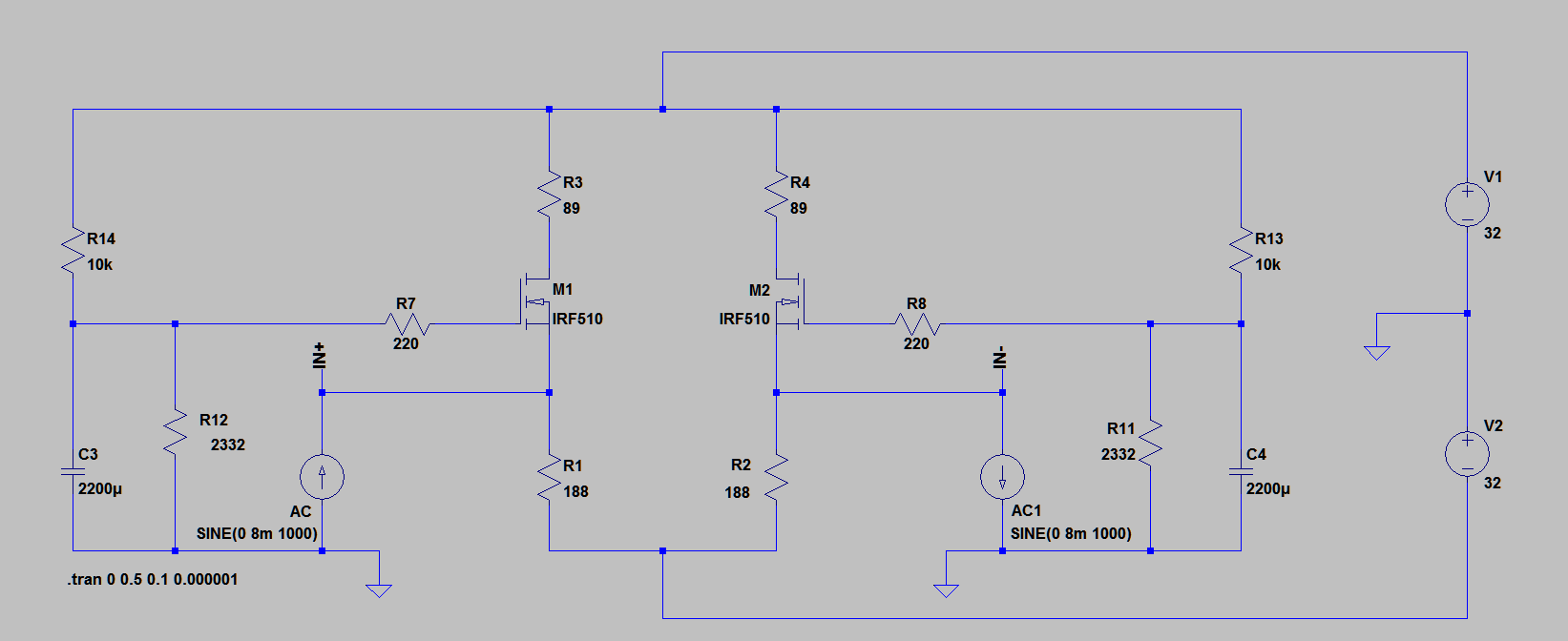

2) I would like to try dual mono by bridging the outputs of each of the BIIIse's and using a single NTD1 board. I think the excess heat/space/FET matching requirements for dual NTD1's is probably overkill ;-) With this in mind, this has been discussed before and I understand that I need to halve the gain and IV resistors, which I am assuming are R13,14, 16, 17, 25, 26, 28, 29?
That is correct. You need to roughly halve each resistance value to get half the gain. This will double the current draw given the same rail voltage, which in turn doubles the power dissipation to nearly 100W. If I were to build such a thing, I would reduce the rail voltage down to +/- 32V and use two PSU V2 supplies instead of the on-board supply. This will make power dissipation a little more manageable, dramatically improve the supply performance and noise, and will also improve overall performance thanks to the higher idle current. I would consider the above arrangement as the "ultimate" NTD1. I can provide the NTD1 boards with the supply cut off for exactly this application.

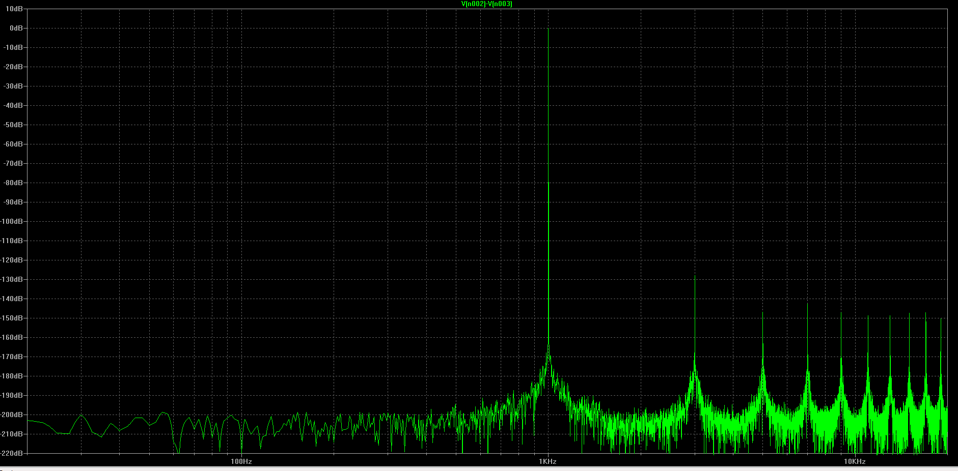

Attached is the schematic for the lower gain version using 32V supplies. This setup gives exactly 2VRMS out at 0dBFS with a mono ES9018 DAC. It also draws 180mA for each leg, giving a total dissipation of 46W which is pretty much what the original version does.
Also attached is the simulated distortion plot at -6dBFS. Since it's a perfect simulation of a differential circuit, the even harmonics are non-existent, but in the real world small imbalances between each leg will result in some even order distortion. Based on measurements, the even order products are about 10dB lower than the odd order harmonics, so you can use your imagination to fill in the blanks.
In the end you get a better power supply, lower noise, lower distortion and you don't give up anything in terms of dissipation.

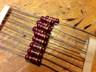

Thanks for the Schematic. The closest I can get to for R3& R4 is 100R (Caddock MP930). Also for R1&2 the closest would be 200R. Does this level of accuracy matter?
I'm also having a challenge matching the components from the main schematic and it also looks like some values of other components has changed between the original schematic and this one. Is the below is correct?
Using the schematic here as a reference to compare with the above schematic: http://www.diyaudio.com/forums/atta...-classic-pass-labs-d1-ess-dac-opdac-final.pdf
New schematic opdac-final.pdf schematic
R13,14 10kR R12,30 30k9R
R11,12 2k3R VR7,9 5kR
C3,4 2200uF C35,C45 10uF
Do I follow the new schematic for these other component values or the original?
If I can only get 100/200R values is it possible to re-run the simulation with those values and will this give different component values for the other components?
Sorry, probably stupid questions but I'm still learning ;-)
This problem has been solved. texas components will create custom values, which is great. This means that I can get the exact values that you specify for the gain and IV but need to understand whether I need to source difference values for the components above as well, or, stick to the original bom.
Hi Crom,
The circuit I posted was only for the voltages and the resistor values of the 4 gain/current set resistors.
The rest of the changes are only for simulation purposes, so you should follow the main schematic.
As for the resistor values themselves, it would be best to have them custom made if possible, but using a 100 and 200 resistor wouldn't be too far off. It just means less current and a little more gain, neither of which are good things...
As an alternative to the custom parts, you can order the 100 and 200 ohm resistors, and just parallel a 1206 thin film SMD part between their pins that would give you the exact value you're looking for.
Owen
