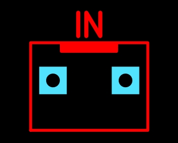

Continuing, here is the revised layout that follows UMS guidelines (80 mm x 40mm mounting holes and Mosfet mounting at 15mm away from mounting hole.) Also included cap pitch options for C1.
regards
Prasi
Nice work Prasi. Thank you for yet another great layout and for clarifying what "UMS guidelines" are.
Now...let's get those input terminals spaced at 5mm apart like they should be instead of 2.5mm.
You should know that farther apart LS is better and easier for most DIY folks to solder.🙄
