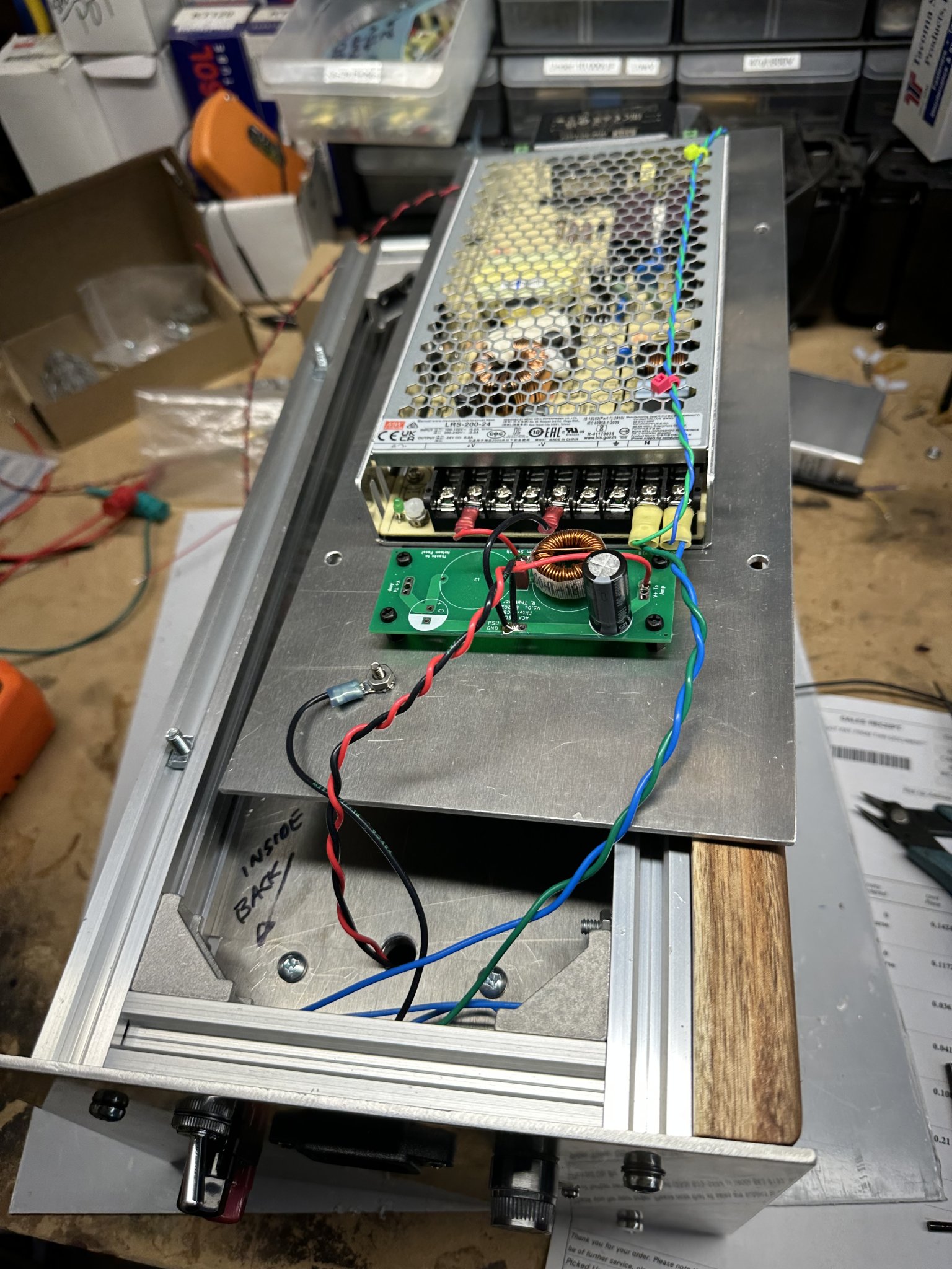

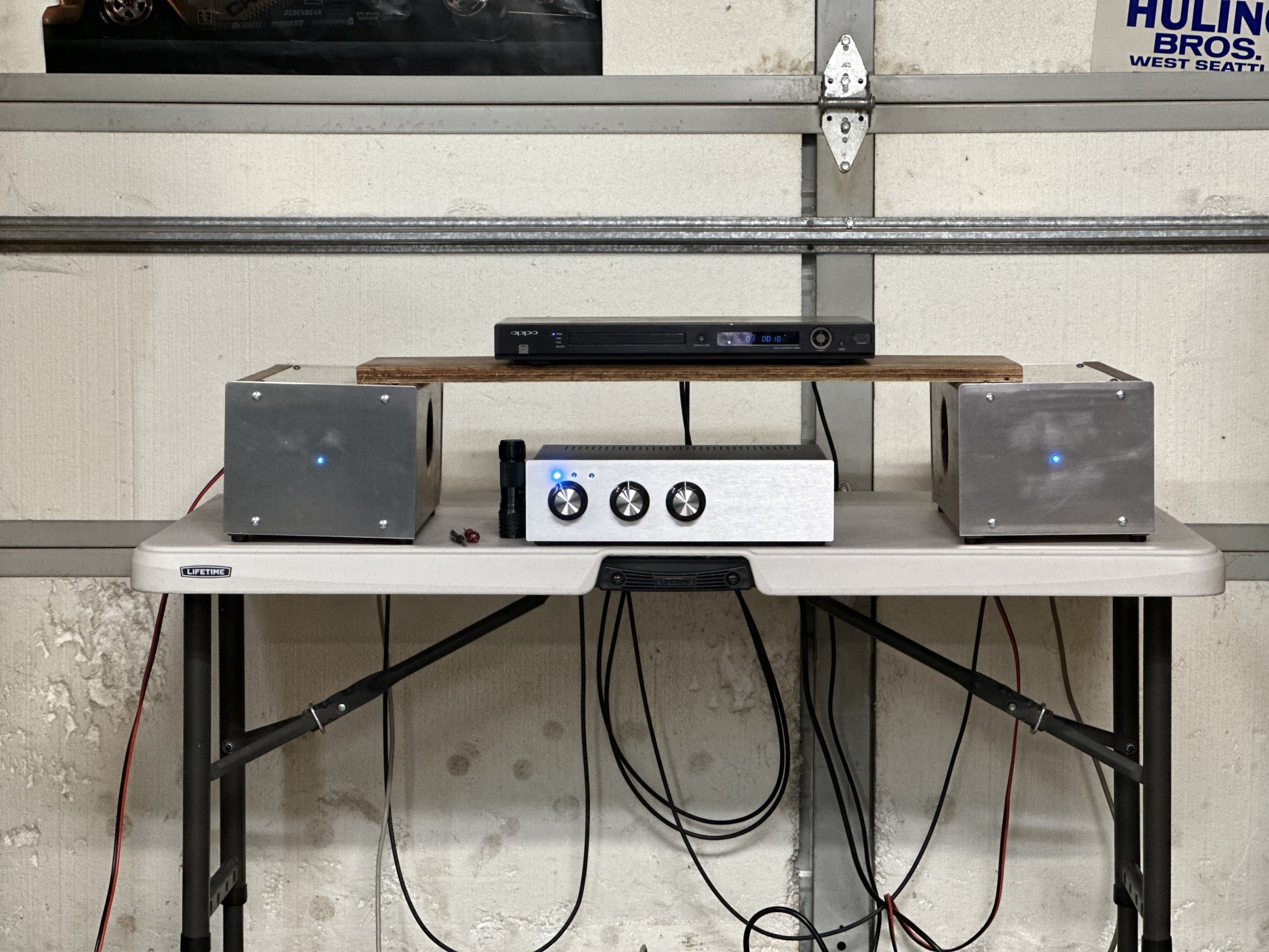

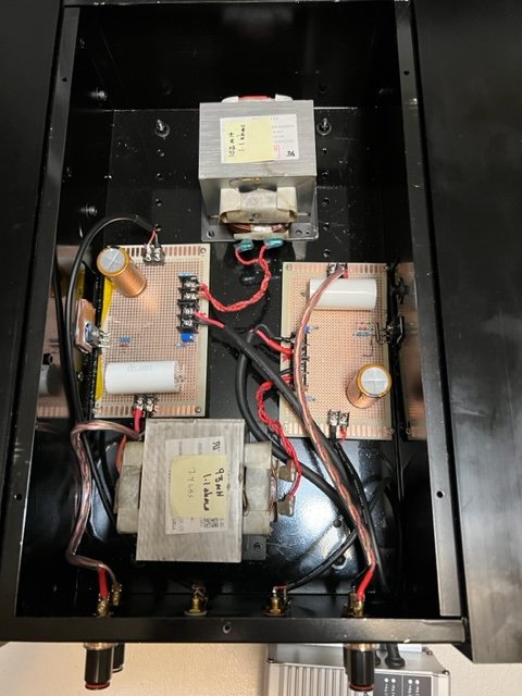

Okay, it still needs some tidying up. Plan to put in the NP 2022 Front End, redo the MeanWell HLG-480H-24 power supply input (a filter and longer cord) and it needs a front panel as well as cut an appropriate top to keep little hands out. I noticed the temporary top aluminum cover helped dissipate a fair bit of heat from the chassis. It runs pretty hot at 55 C. Not a summer amp in Sacramento for sure. Okay, here are the photos:
Monk55, yes they are. I used a Bud Box alum chassis as a "frame" for the heat sinks but cut holes out of the Bud Box to allow direct mounting to the heat sinks. Heat sinks are 17.25" long by 4.75" high and 3 1/8" deep which seemed to be adequate for the MoFo.

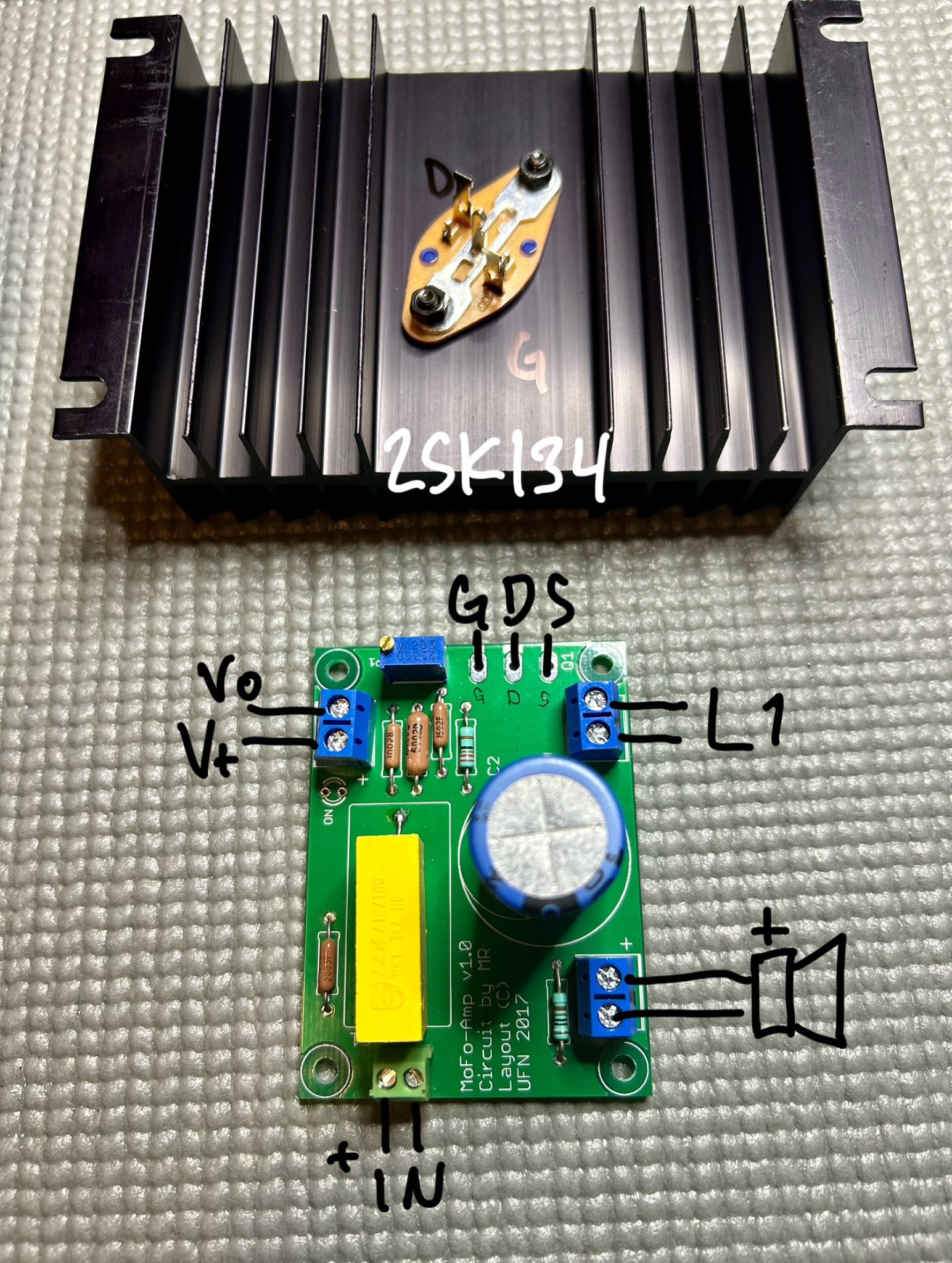

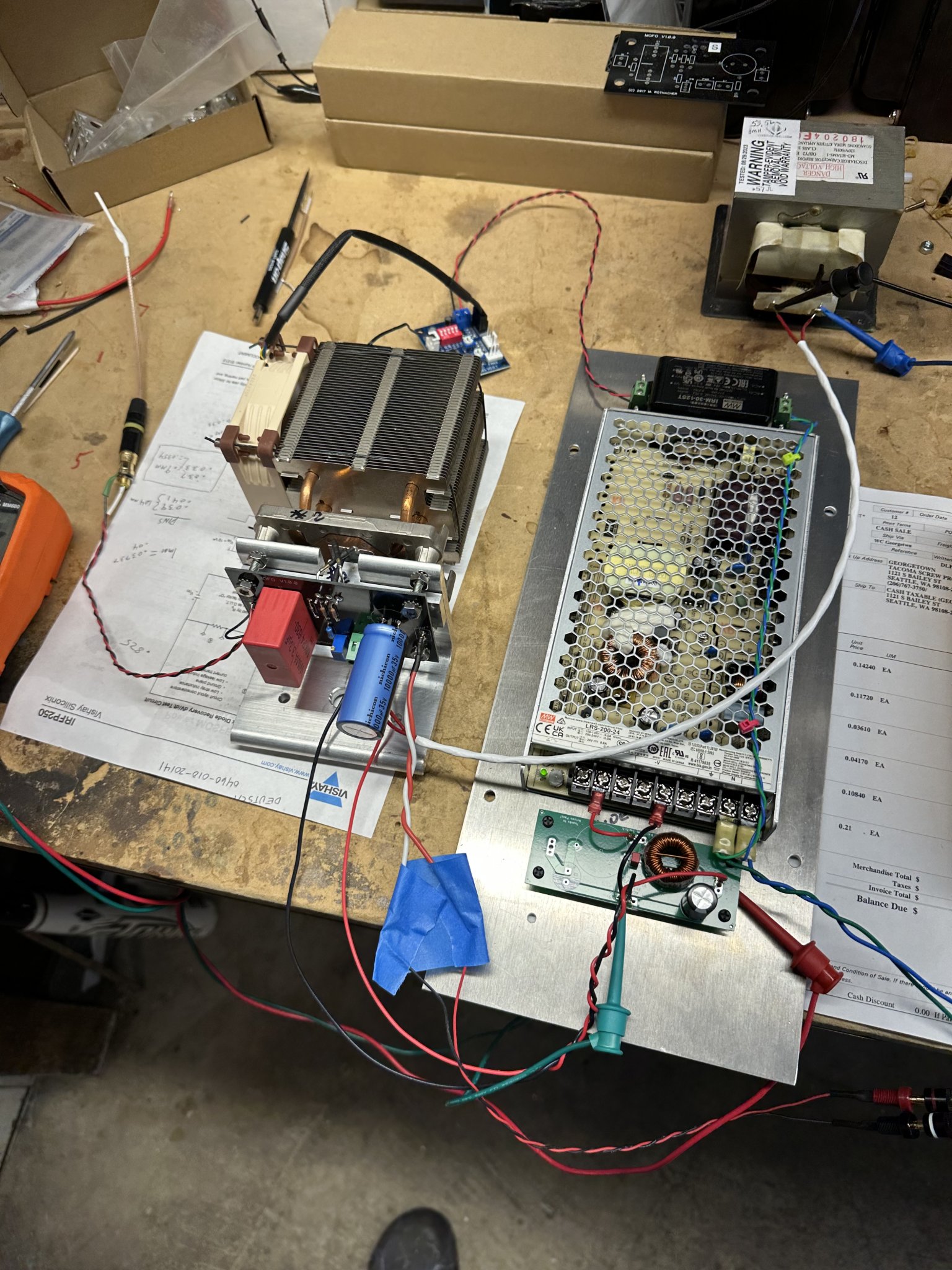

New MoFo greenhorn here…
For S&Gs (sources and gates
), I want to try some 2SK134s with the boards I just got.
The sinks are undersized, but I will have fans blowing on them for testing.
I will be using 19.5VDC laptop bricks and big MOTs.
Does the attached picture check out for the board connections?

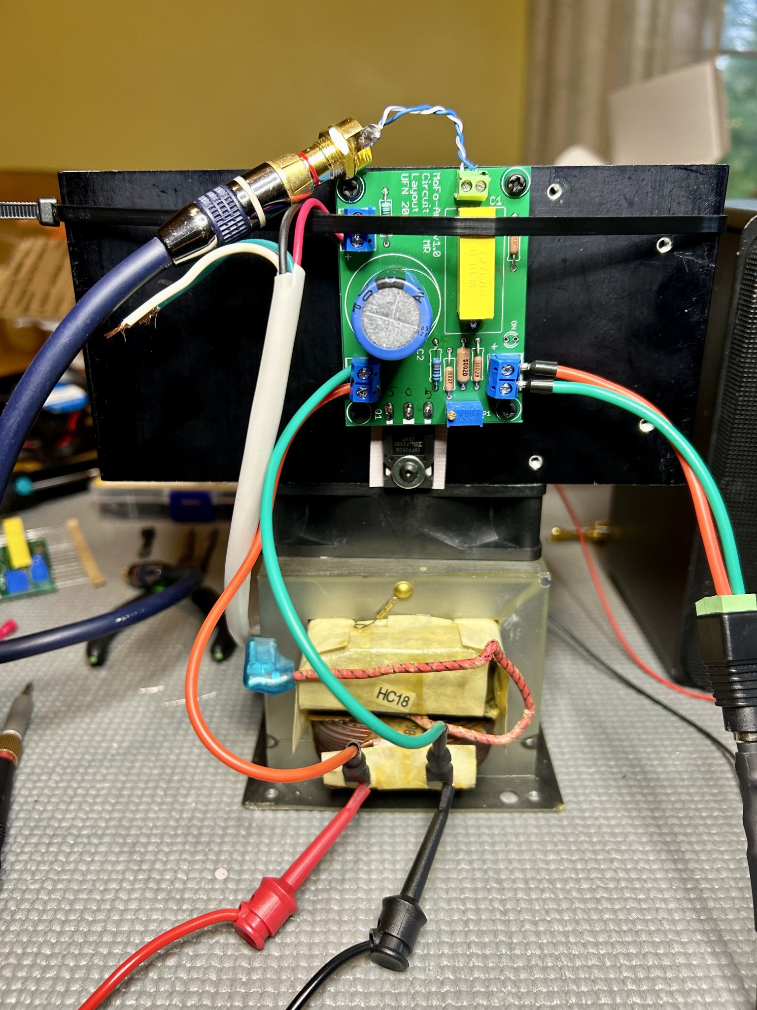

Not sure what I did wrong, but I ended up cooking the gate resistor.
Backing off for now and will sleep on it.
If the gate resistor cooked, there must be a wrong connection somewhere.
For trouble shooting, please post pictures of your amplifier showing all of the wiring. The pcb is not the MR diyAudio version so information is also needed in order to check the circuit and connections.
Hi MarcNot sure what I did wrong, but I ended up cooking the gate resistor.
Not sure you can drive LatFet with this circuit without modifications. FYI, there’s a more recent version of this PCB (v1.1) that has the zener diode protection. See here Slowdiyer.
Hope it’s easy to troubleshoot, let’s follow Ben’s recommendations.
Eric
Burned gate resistor? Maybe parasitic oscillation. Gate/Base/Grid resistors need to be very close to the active device itself (the closer the better), not on a pcb unless the two are very close together. Hopefully your FET is not shorted / defective.
Thanks, gents. I’m not sure what it was, but the latfet wasn’t agreeing with the setup.
At first I thought it was a loose connection on the inductor. I fixed that, jumpered the gate resistor pads on the board, and connected a new resistor at the fet gate.
Same result. Gate resistor smoked.
So I replaced the gate resistor on the board, attached the correct IRFP250 to a test heatsink and soldered it to the board.
No smoke. My inductor measured 60mH and 0.6R previously. 1.02V measured at the inductor produced audible distortion, so I dialed up the bias until the distortion went away. That was right about 1.4V.
The sink was getting up to 60C without a fan, so I turned the fan on. Sink staying under 40C.
It’s been running fine with my test speaker. It sounds pretty clean. I’ll use the latfets for something else.
