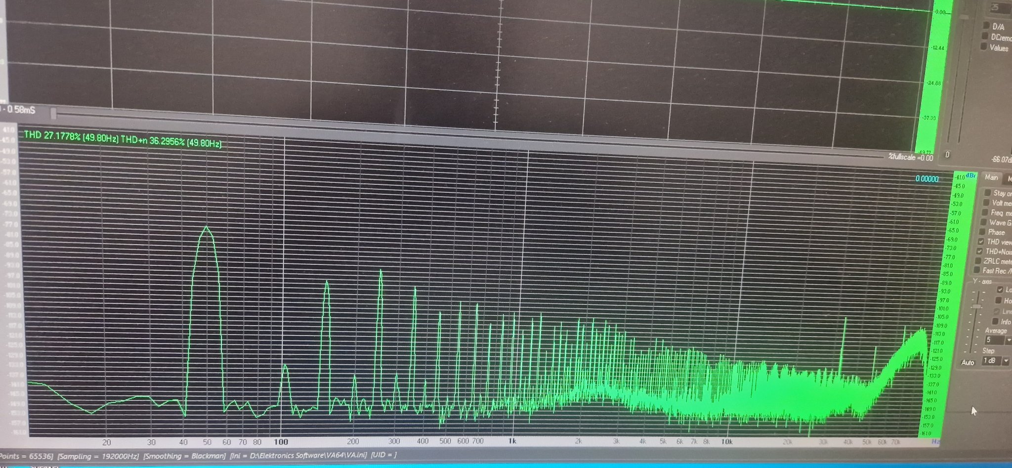

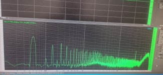

I dont have any 100hz noise, only 50hz and its harmonics 150, 250 ...

At the amp’s LS output sockets ?
If so, that’s totally wrong, it should be a flat noise floor with minimal signs of 50hz.

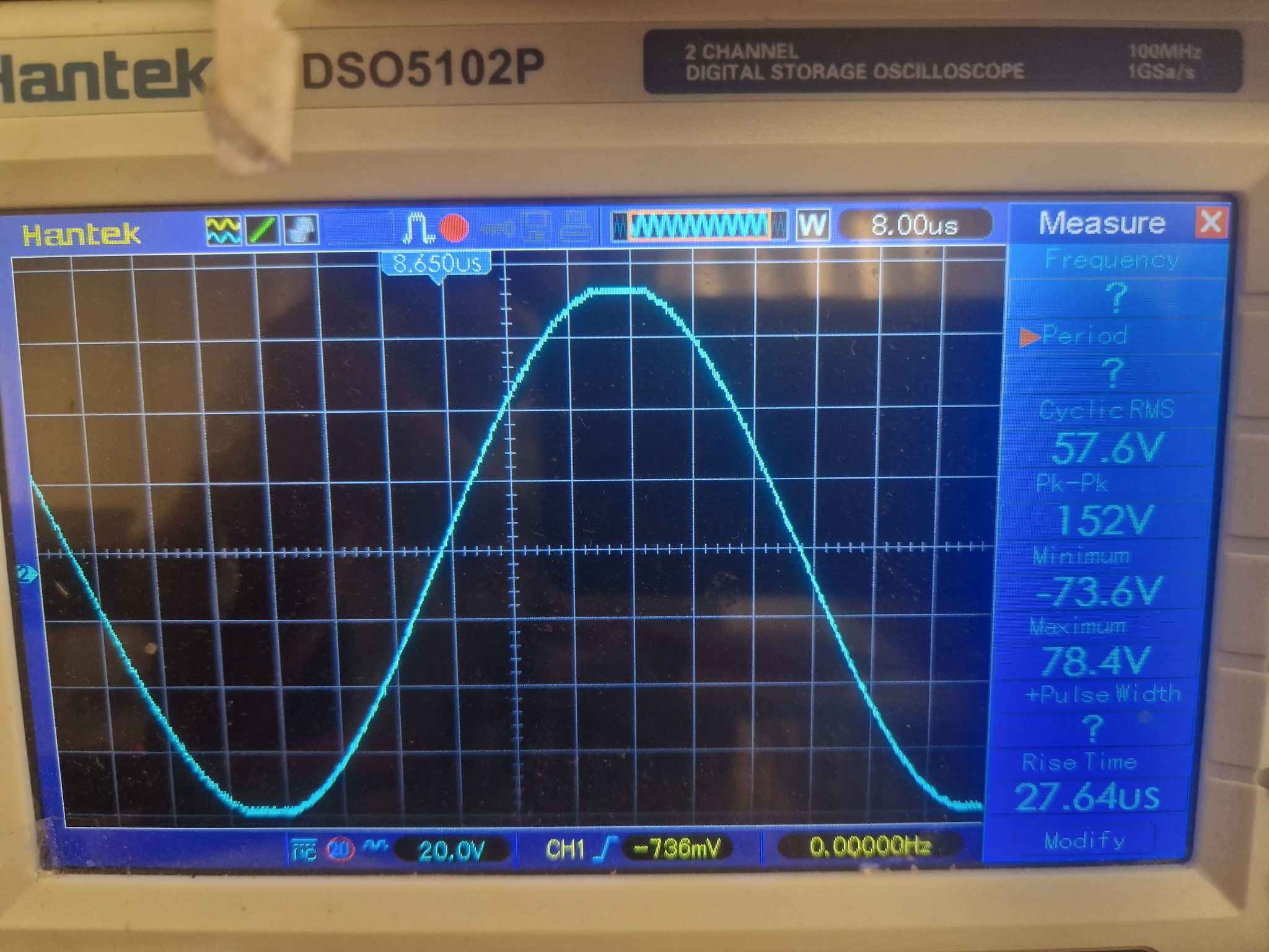

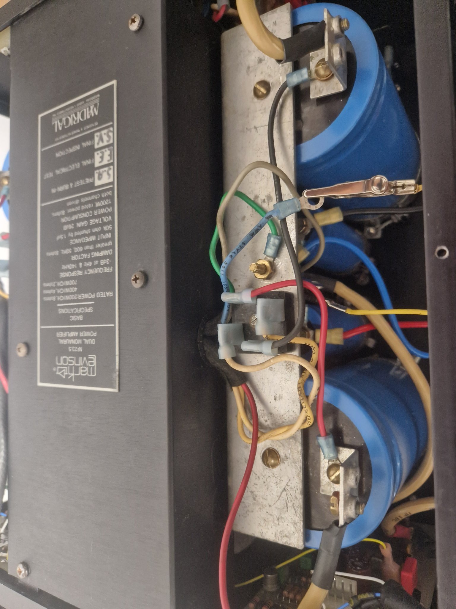

That’s why I ask you again to make scope pictures in AC mode on your 2 big and the 2 slightly smaller blue caps, to make sure they are o.k. all four. That would be my first thought as being the cause.
Hans

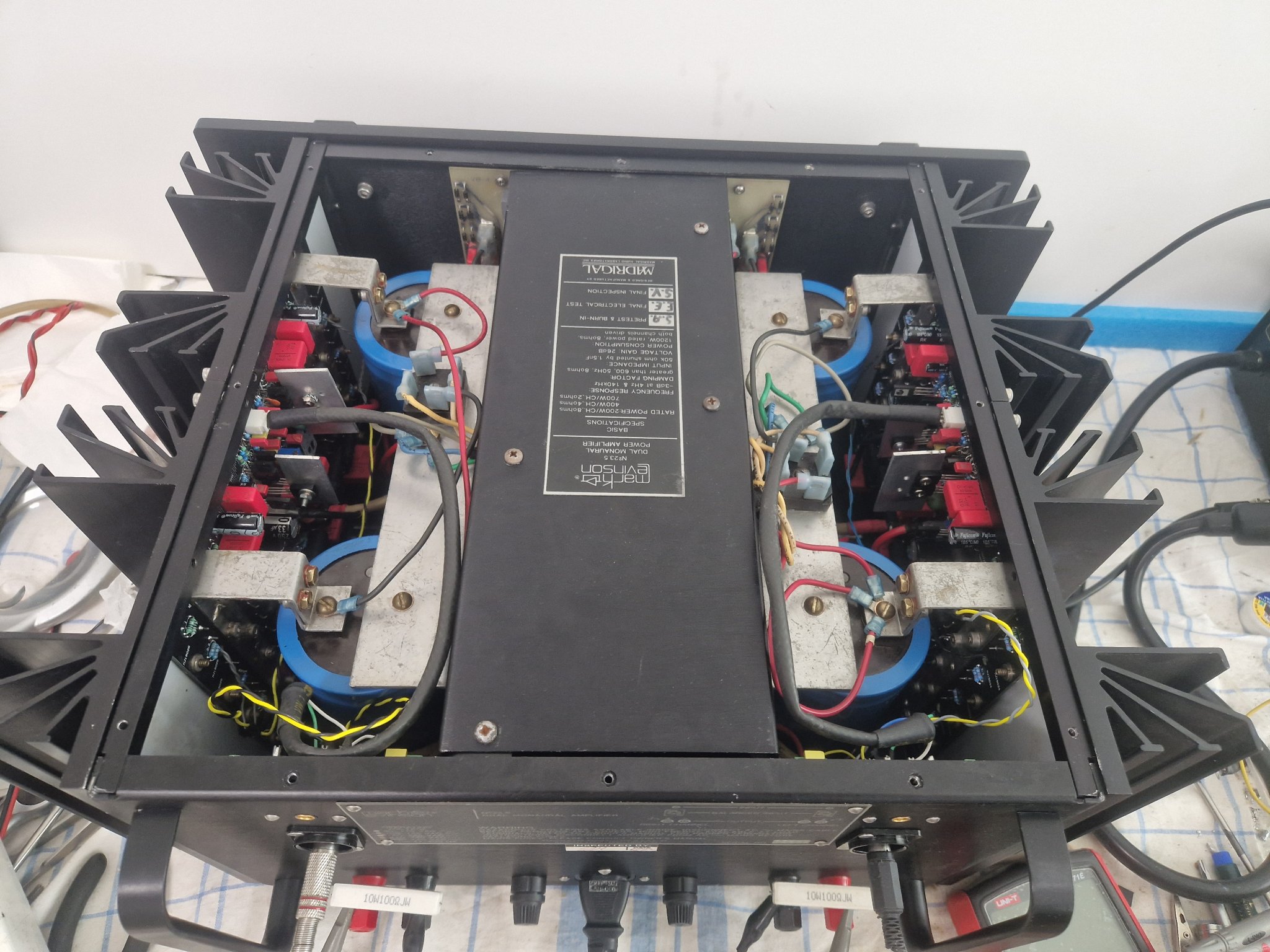

Hello whitesnake,
I assume that you are making the measurements with the heatsinks+ PCB disconnected from the chassis?
We found out with Hans that there was a lot of oscillations if the chassis was not connected to the heatsinks. One extra cable is needed for that.
