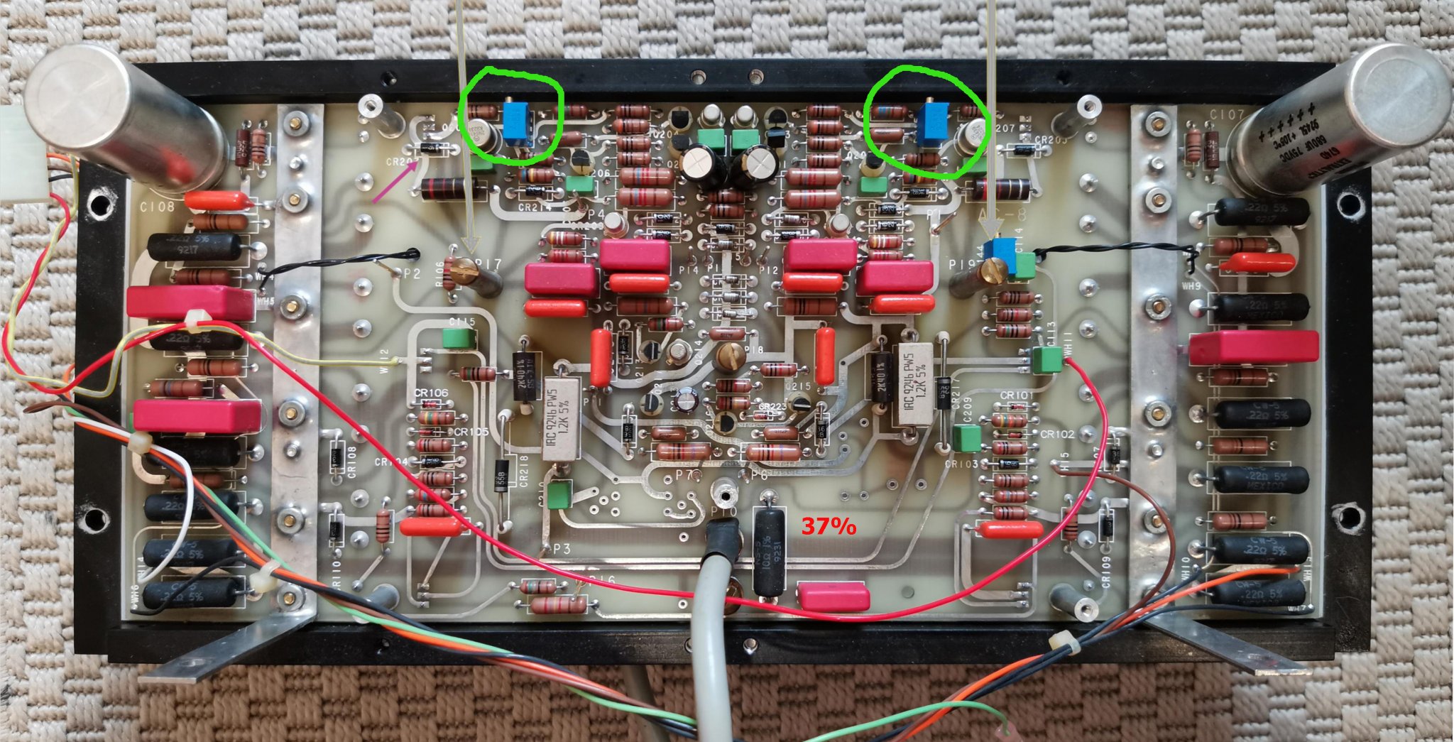

I can see what looks like two PCB boards that looks like they are repeated twice but with different numbers. Is there a difference or why both board repeated twice?
What do you mean with "working on".I'm working on a 23.5 now and welcome any documentation the group can post here... thanks!
Are you repairing one ?

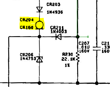

I have to say that I did try to search for CR160 and a lot of other things, about 98% of what I have done until now is found out in that way. When I did search after CR160, did I get thousands and thousands of results, and by refining the search, did I still end up with about 25 different types of components, 10 of them could I easily ignore.
I am a beginner out in this fantastic hobby and spend hours and hours on reading, watching videos and trying to find things out. Unfortunately, do I stumble upon things I do not have enough knowledge to solve by myself, and I try to ask you.
Please believe me when I say that your help is very much appreciated and helps me over "bumps" I can't get over by myself, but before asking you have I maybe spend a week trying to solve the problem myself.
May I please ask why a current limiting diode is used between a zener and a diode? I did think that they had about the same "one way" function and one of them would be enough, unless you need some voltage drop?

To answer you question concerning the zener.
A zener is a voltage limiter that starts conducting once the specified voltage is reached.
But as from this point, because it will try to keep the voltage fixed, current is undefined and the thing will blow itself. But with a simple resistor you can limit the zener current. Even more so, when using a current limiter instead of a resistor will result in a very stable voltage on the zener independent of the value of the voltage source.

Thanks for your Zener explanation! I have seen the Zener used in reverse from negative to positive to set the voltage on a exact level, I have never seen a Zener been followed by a resistor to control voltage... does that not give a short if the Zener is just placed on the main leads if voltage goes above the Zeners max voltage?
I have thought that if you placed a Zenor would that decide the voltage and as you say let the current go through as it wanted, but if you then placed a current limiter, would the current set max current while voltage got to run amok. <meaning that to combine both would be two functions, fighting each other, just as if you placed a conductor and a capacitor in series, would block both AC and DC.

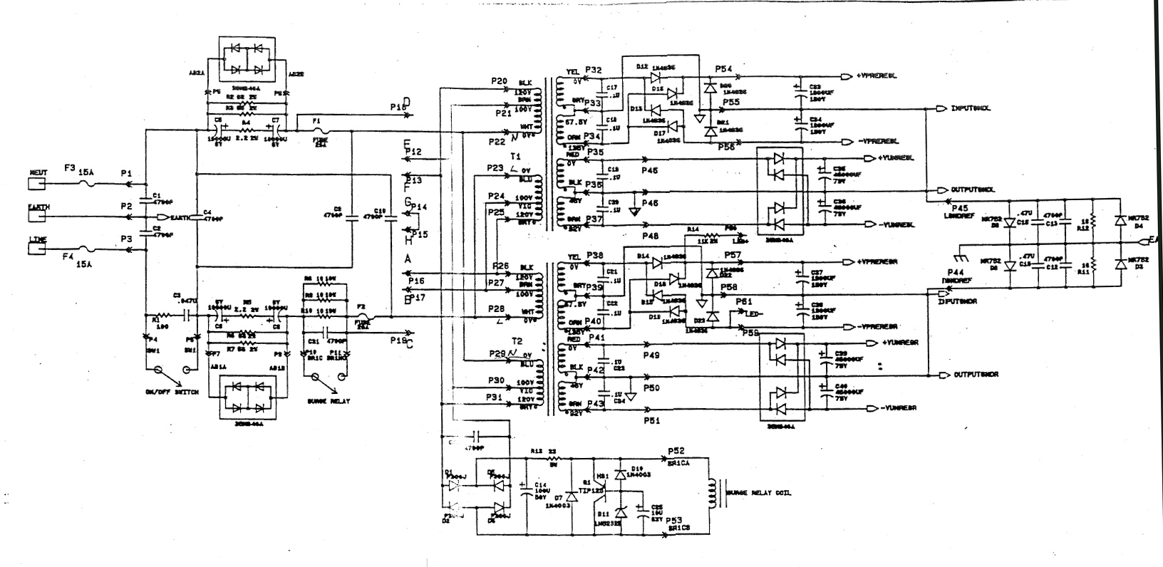

By the way, it looks to me as if they have not a schematic for the last PCB in the documentation?

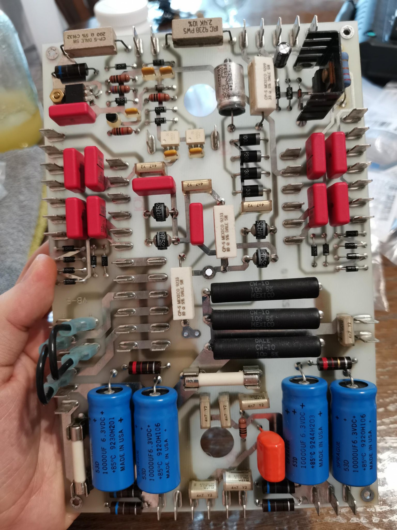

The schematic and the PCB that are in the documentation belong together and are correct.
Here you have some pictures.

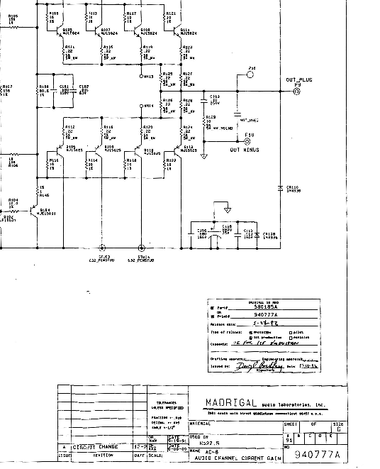

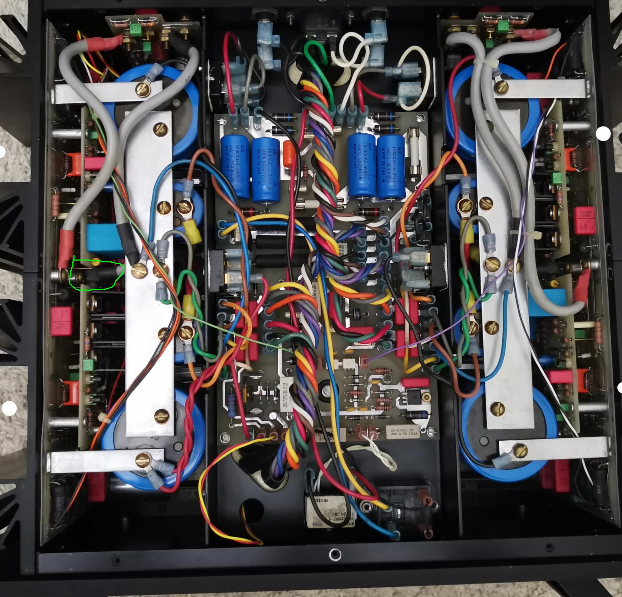

Hello everyone! I have a Mark Levinson 23.5 amp that doesn't work at all. Both channels are broken and I'm trying to get them back but someone before me tried to fix it with no luck and there are some missing parts and mods. I checked some circuits from internet but they are different to some extent.
I was looking at some pictures of the inside and realized that there are different versions of the board.
My version has two boards per channel and on the one of it(the botton with power transistors) there is an electrolit capacitor 470uF/100V with diode and resistor which are connected to the top board. Is this an original? I will add some photos.
Does someone already have the full schematics of the amp?
