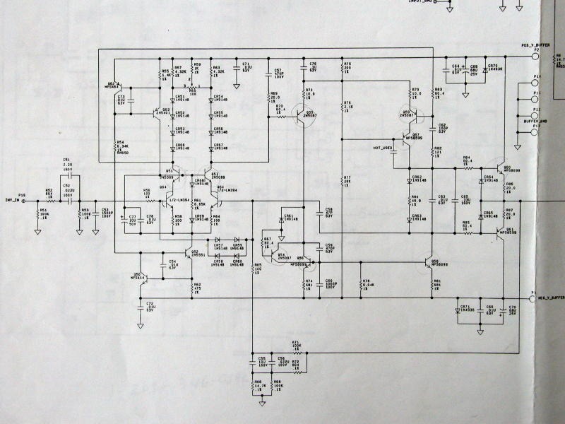

But is it even possible, I have found this document, but is it enough to a complete build?
(please ignore that the component values is impossible to read)
https://www.audioservicemanuals.com...1369889-mark-levinson-27-5-pwr-service-manual

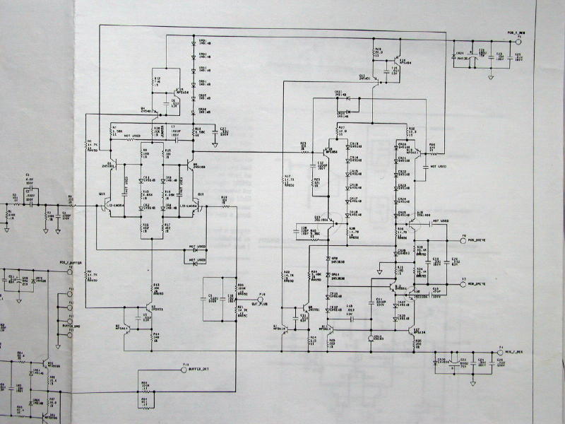

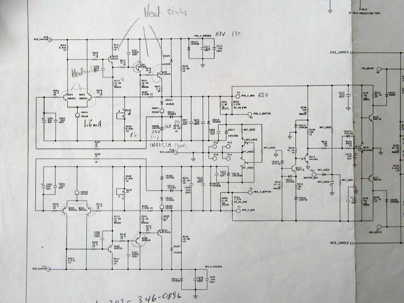

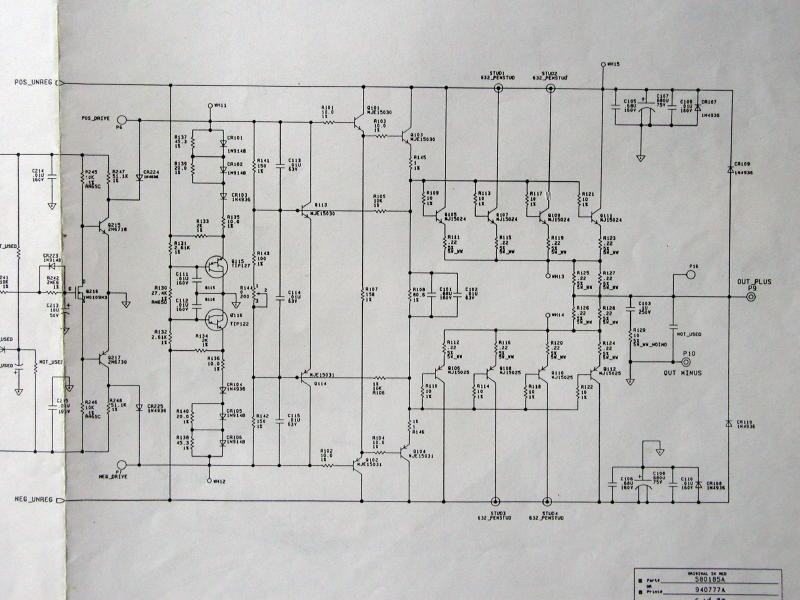

I am assuming that picture 1 and 2 in post 3 is the amplifier circuit, but I do not feel so sure about picture 3 and 4, to me does it look like two separate circuits, connected by a few traces?
Could you maybe please try to identify them?
There you go, wrong.
Picture one the regulated power supply and two is mainly the output stage.
But as mentioned before, all belonging to the 27.5.
So before answering your questions, what do you want to build, the 27.5 or the 23.5.
It would not be bad to select the 27.5 because it is simpler and well documented, including with PCB layout.
