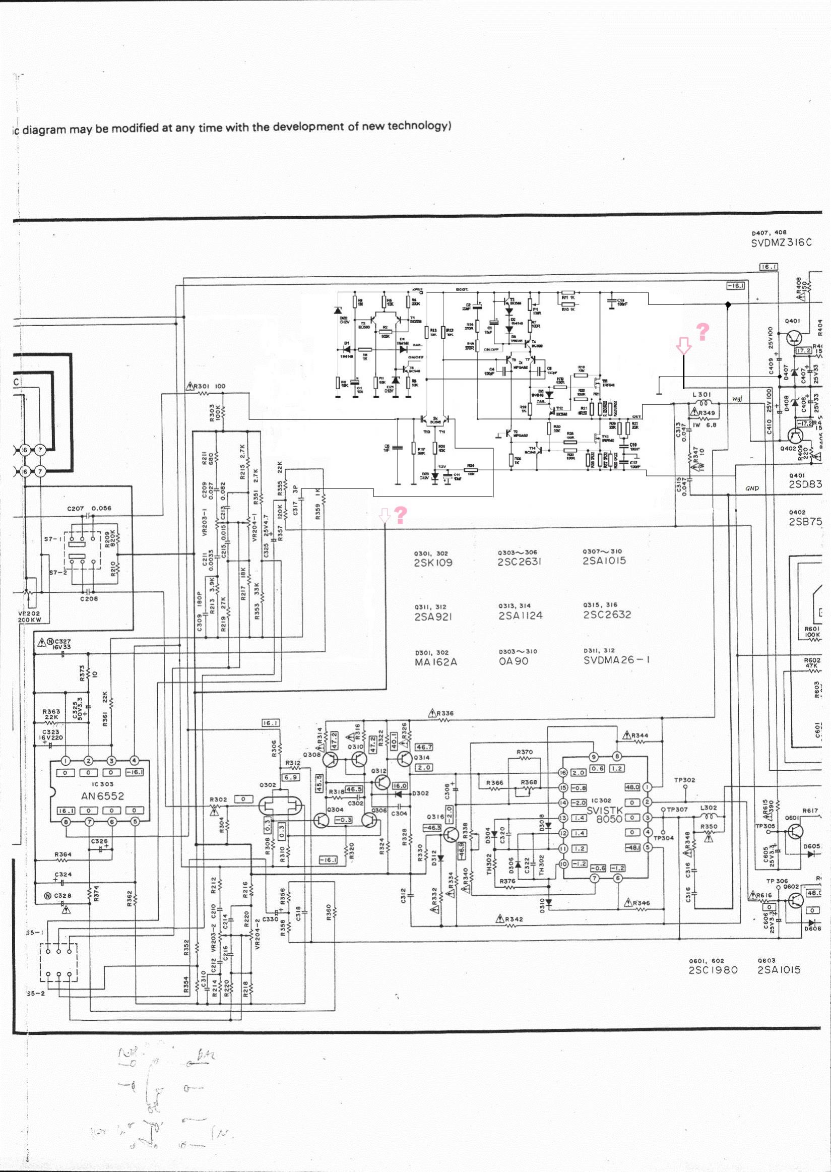

Hi Depaj,
I don't have the schematic in front of me, so I can only ask you. Are the tone controls using an op amp for gain, or the output stage (like the Yamaha A-500 for example)?
If they use an op amp, no problem, you don't have to do anything. If they don't, then you are looking at the amplifier as a tone control gain stage. Then you should probably us an op amp instead of the amplifier. You just take the signal from the output of the op amp. Of course you could always delete the tone controls all together.

Ignore IC303. It's a DC servo.
The SVI chip is an output stage only and it is driven by a discrete voltage amplifier stage using the DC servo. The tone controls are in the feedback loop (uncool). So they hampered the amplifier stage with a tone control circuit built in to save $$. Not many $$ either.
Go ahead and build it the same way. You're using the same voltage amp stage so the output stage change should have a lower effect on stability than as if it was the entire amp on a chip. This still means that you watch out for oscillation with your scope.

The thing is, I'm not using the svi chip but a complete MX50 power amplifier kit (sorry if that was unclear). I will take my input directly after the volume control as shown in the images in post #34.
Okay, but the tone controls may make the kit unstable. All you can do is try, and if they do, you'll have to omit the tone controls for the time being.

I've swapped one complete amplifier section (from R301 to the output of the stk) with the kit I ordered and it works great. Relay kicks in after about 5 seconds, and I have a nice and clean sine wave. now for the tone controls, I disconnected the feedback resistor on the side connected to the diff amp, fed it through the tone controls and back in where the other leg of that resistor used to be. The tone controls work as they should but as you predicted the top and lower parts of the square wave are a little shaky but it doesn't look like it's oscillating (with a normal volume level I didn't notice it on the oscilloscope but when I turned the sensibility up and the volume of the amp down it became visible).
Back with some news, I started with just one channel and it turns out to be working really well without the tone control, protection circuit works perfectly, as does the power meter. Now with the tone controls in the feedback it does work and the controls affect the square wave as they should but as predicted the top and bottom part of the wave are somewhat shaky. a slight adjustment might be enough cause as soon as I turn the volume up a bit and thus lower the sensibility of the oscilloscope it becomes rapidly invisible. Would it help to leave the first differential stage in there and hook it up
to the mx50 like this or will that completely mess things up ? :

Leave the diff pair alone. Why not try and put some resistance in series with each end of the pot to restrict it's range a little? That will probably solve the instability issue you are seeing. Personally, I'd restrict the tone controls to a range of +/- 6 dB. Any more than that and the tone controls are being misused. Just a thought.

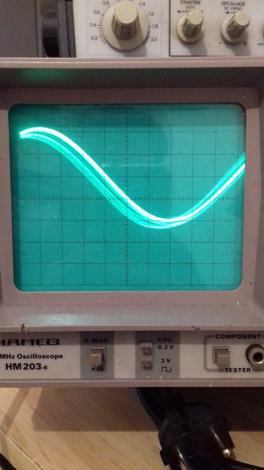

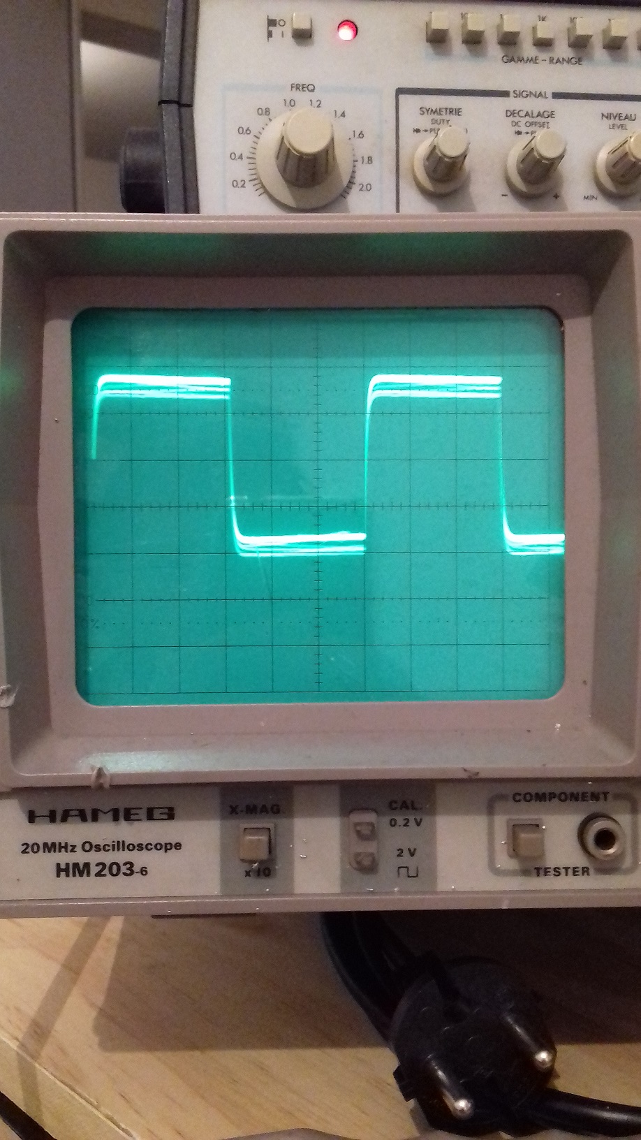

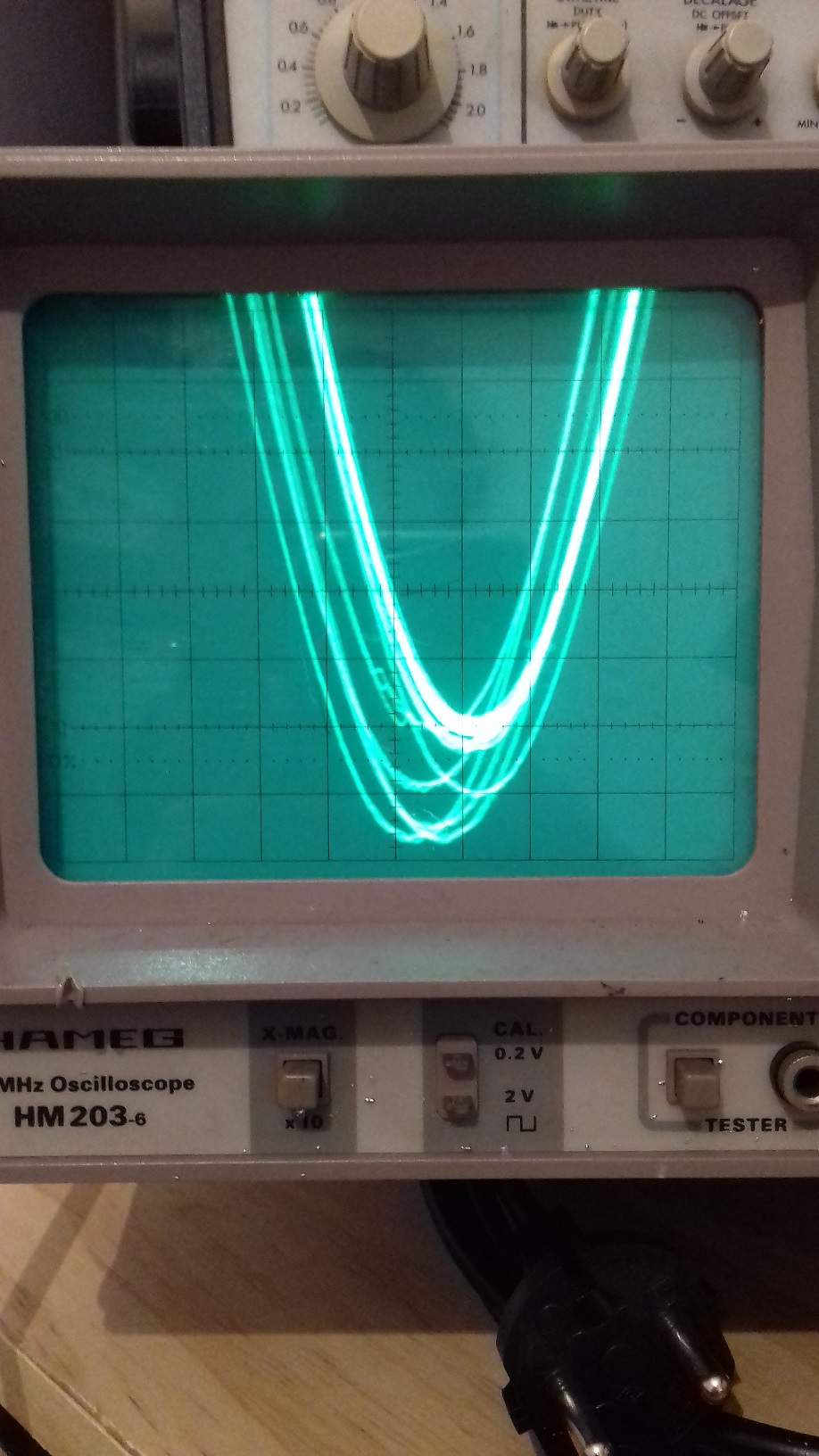

That definitely makes my life easier because adjusting the pot doesn't create the instability, it's there with all controls flat and even with the straight dc (tone control bypass switch) activated. I might restrict them anyway but that doesn't seem to be the problem.
I forgot to mention that the higher frequency hum is only kicking in when I increase volume but then stays at the same level from about a third of the way up. The lower frequency hum is there no matter the position of the volume. Both frequencies are sensitive to bass and treble adjustment and activating the low pass filter gets things way worse even if that one is before the amp section.
I'm about to go pick up a pair of ditton 66 in pretty bad shape but working 😀 and will posts some photos of the square wave when I get back.
