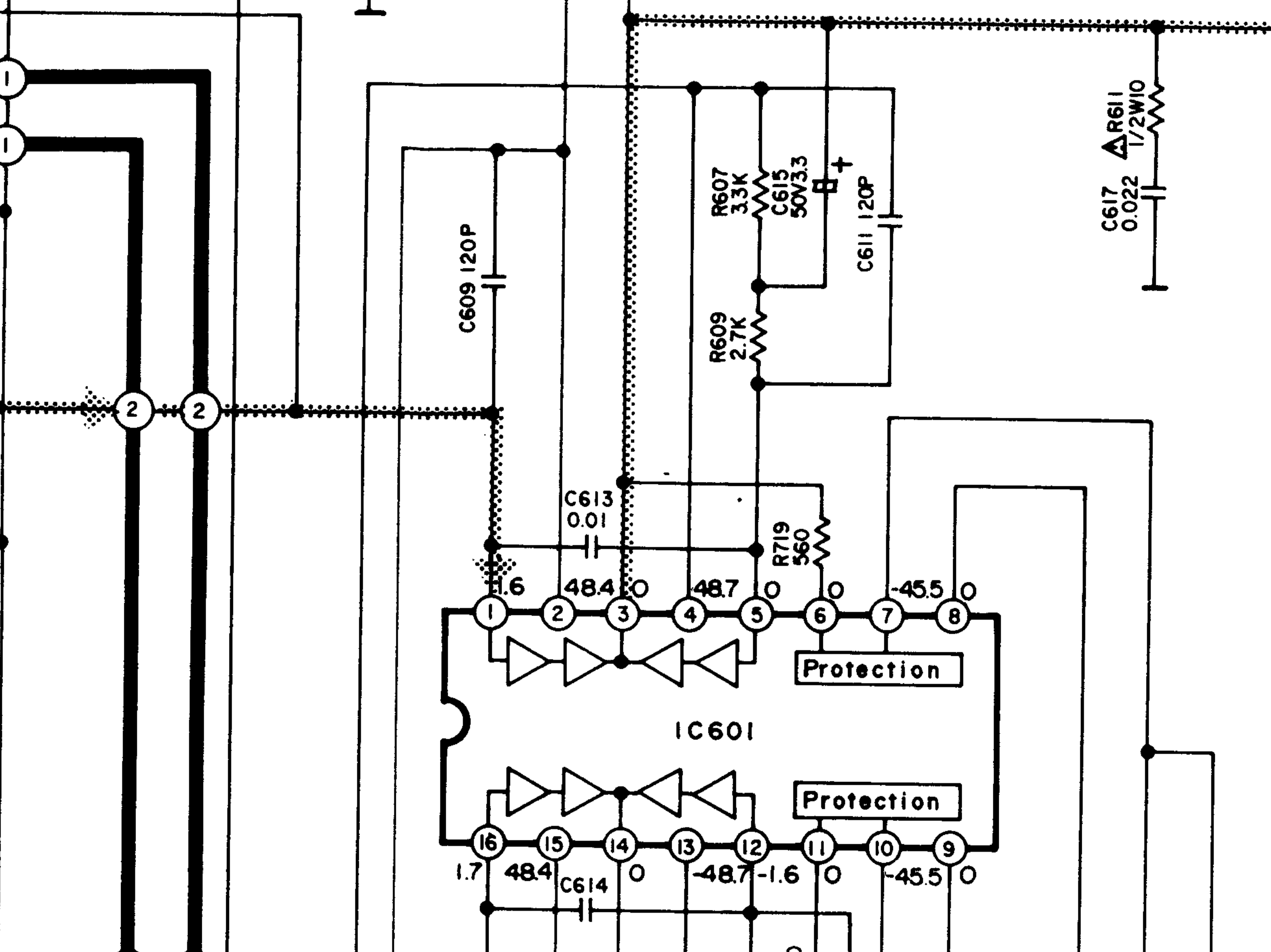

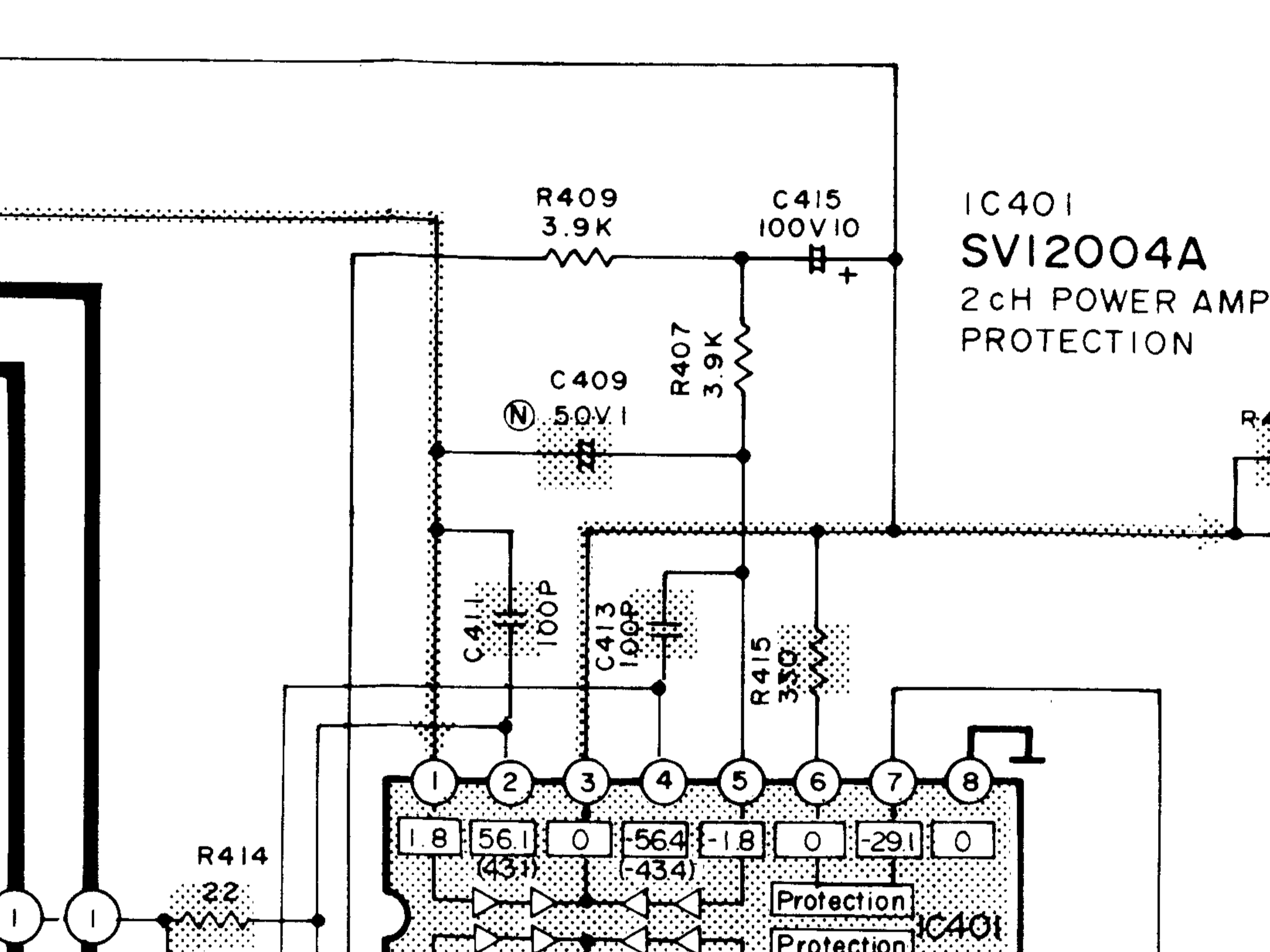

I ran with the resistor chain current stabiliser... I wasn’t keen on the existing current stabiliser... in fact that may well be the cause of failure.... similar array wreaked havoc on V4X amps
Those who wonder.... same power ic in Z600 Z610 Z650 V66 X90 - never see those have current stabiliser dramas they present danger to the power ic

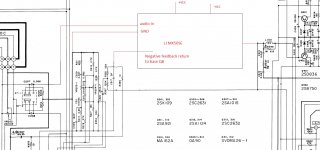

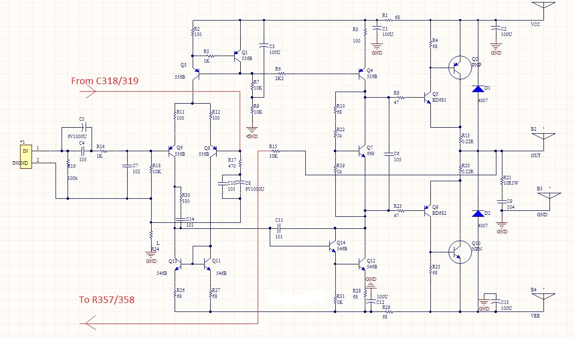

Ok so here's the final decision, I will swap out the whole power amplifier of the su-v4 and put a mx50se kit in its place, it will work on the existing supply rails (I will increase slightly the 2 filter caps). Only question is, as the tone controls are in the negative feedback loop, can I make them work by connecting them up like shown in the pictures ?

I would run the tone section on an external op amp and feed the new amplifier with that. Running the amplifier feedback through a set of tone controls can have really serious issues.

Is it as simple as you make it sound or does this involve a whole lot of modifications ? The tone control here seems to use a dc servo amp that confuses me a little bit.
Simple? Depends on your experience. A piece of vero board would do. Use an NE5532 or similar.
A feedback type tone control circuit in the feedback network of a power amplifier can make it conditionally unstable. PITA to figure out, so if you can avoid this all together, do it. A tone control that is separate is a much cleaner way to create a tone control.
If you need a schematic, just search some preamplifiers and you should be able to find one.

So I will have to build a new one, I can't use the existing one ?

Just copy it from another piece of equipment. You can read schematics and that's a big hurdle out of the picture. It should be fairly straight forward.

It's not the copying that's worrying me, I got quite good at that 😀 , it's the whole bunch of new parts I will have to get plus the pcb to order or the extensive modification I will have to bring to the existing board. Also the amp seems to have an active tone control with IC 303 as the tone amp, does this change anything ?
