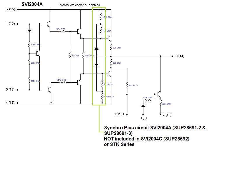

Hi SVI2004A (seems you kind of like this one)
None of these seem to be drop in replacements and they are both 2channel devices, there would have to be some serious re-routing on the board right ? Also what happens to the clamp voltage adjustment ? Is there any guarantee that buying these will get me genuine parts ?
The stk2058IV seem very expensive, is there a guarantee that the SVI2004
These ICs are more reliable than the 8050, and the 2004 has more power and current capability, the transistor chips are somewhat larger than the STK series...
SVI2004C will also work but is not new class A - as the Synchro Bias circuitry was no longer produced in cost cutting. See attachment
As far as I know there are no counterfeits produced for these ICs to date

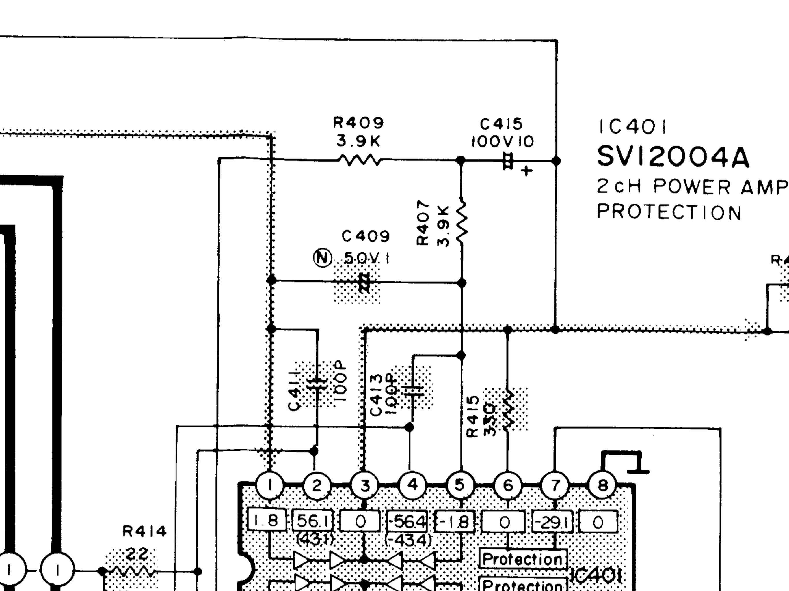

I've seen some people just bypassing the whole power amp section with a different power amp using the same power supply rails but that does go a bit far (even if it might improve sound and stability).
SVI2004A could you send me a little diagram on how you would connect it to the board ? I will probably take your advice and go this way for this particular repair but I still want to try and build something similar tho the original stk but with better components.

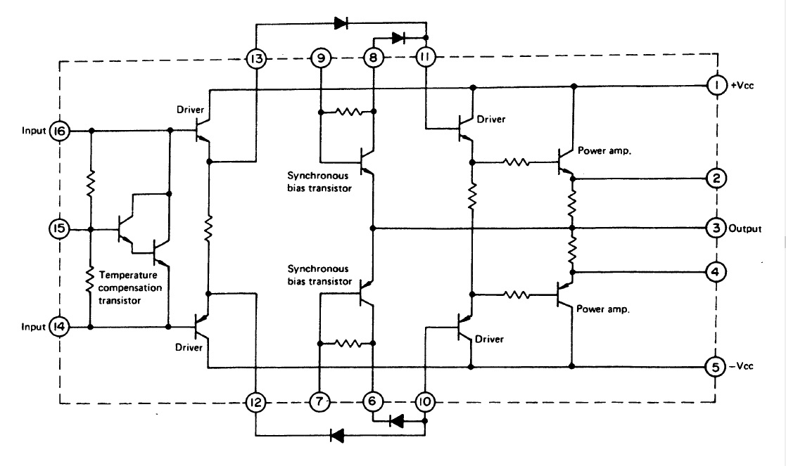

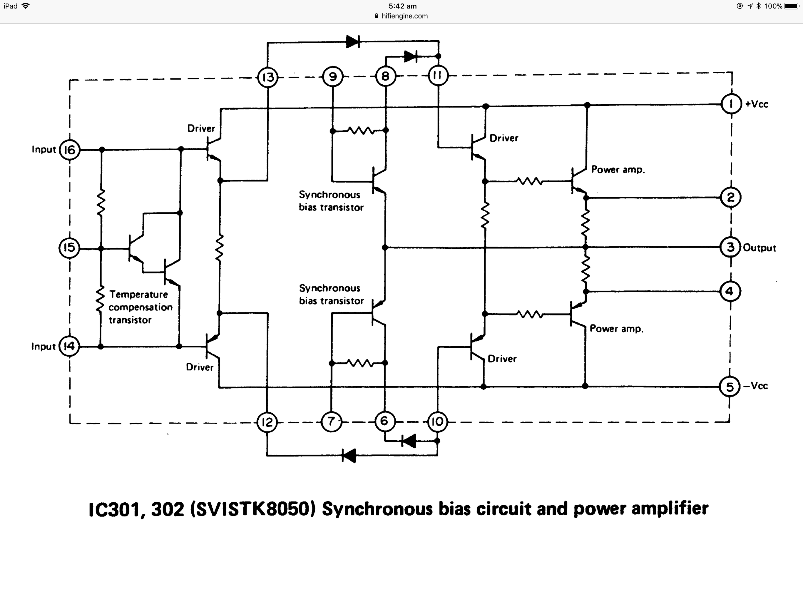

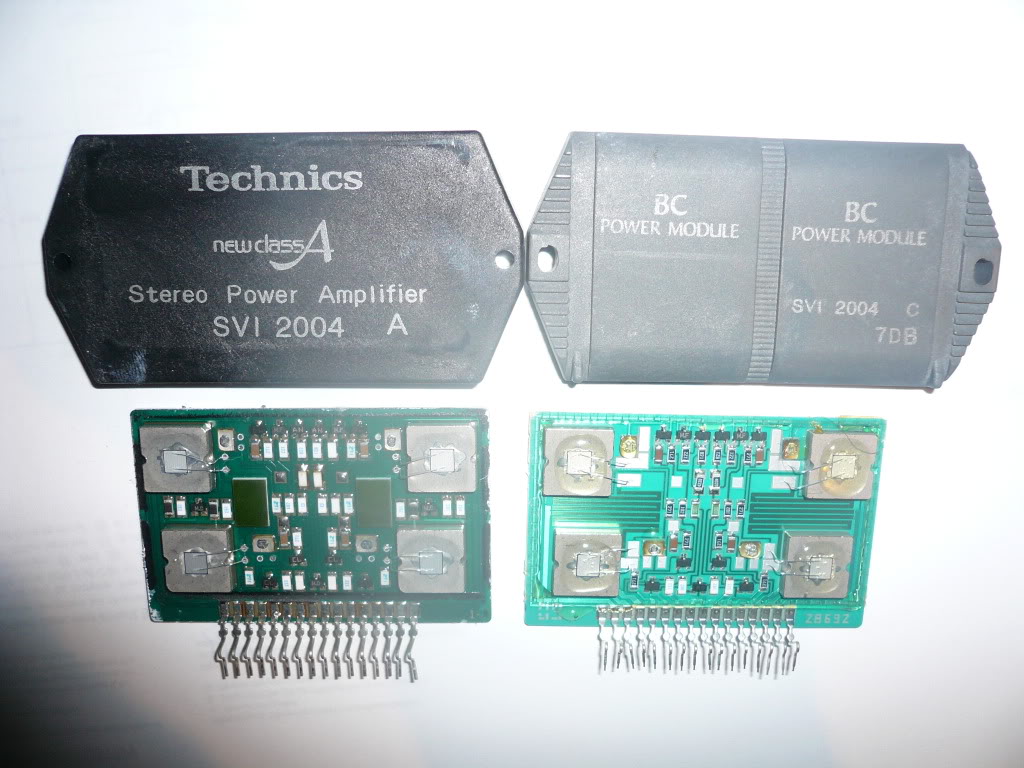

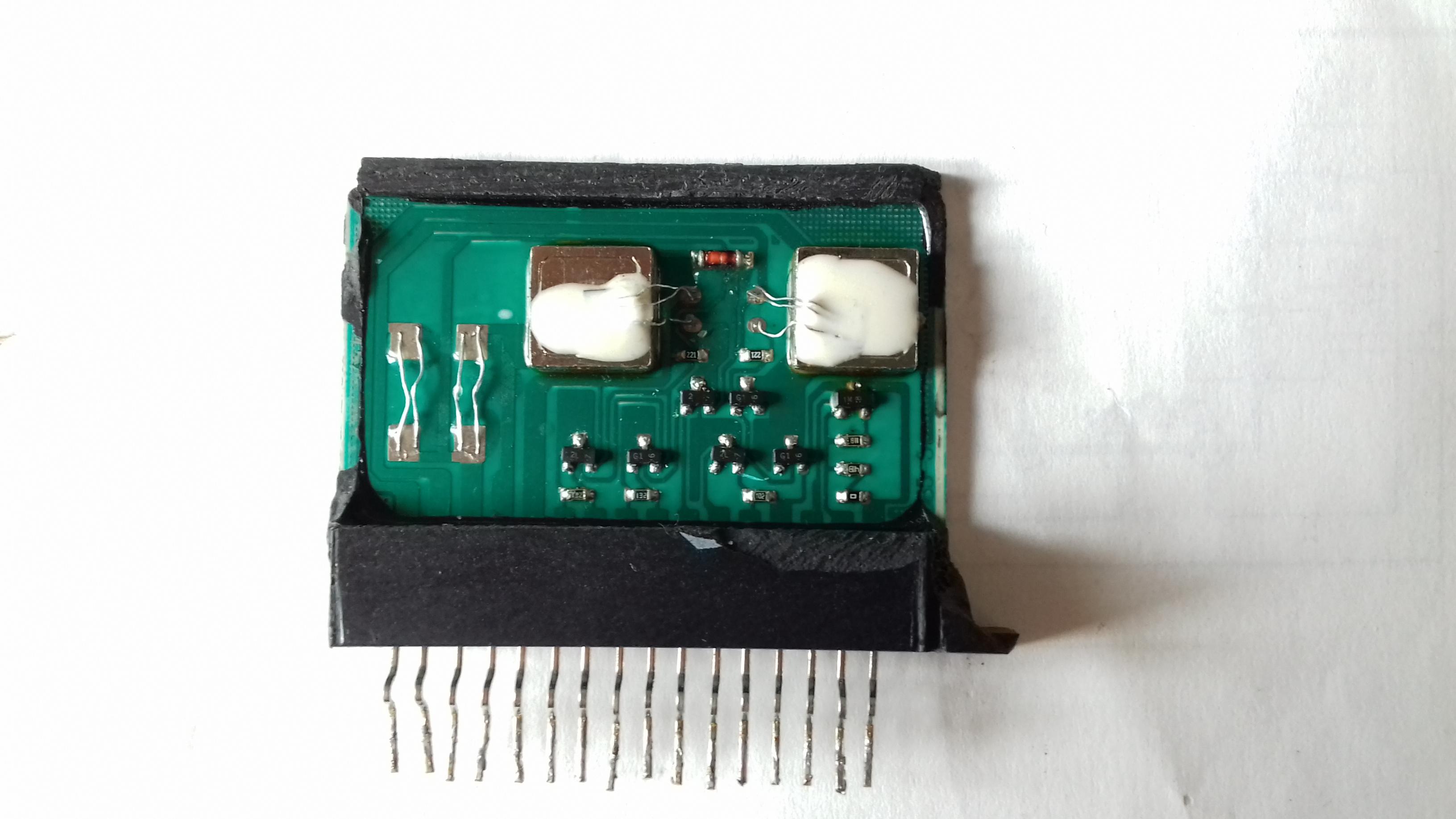

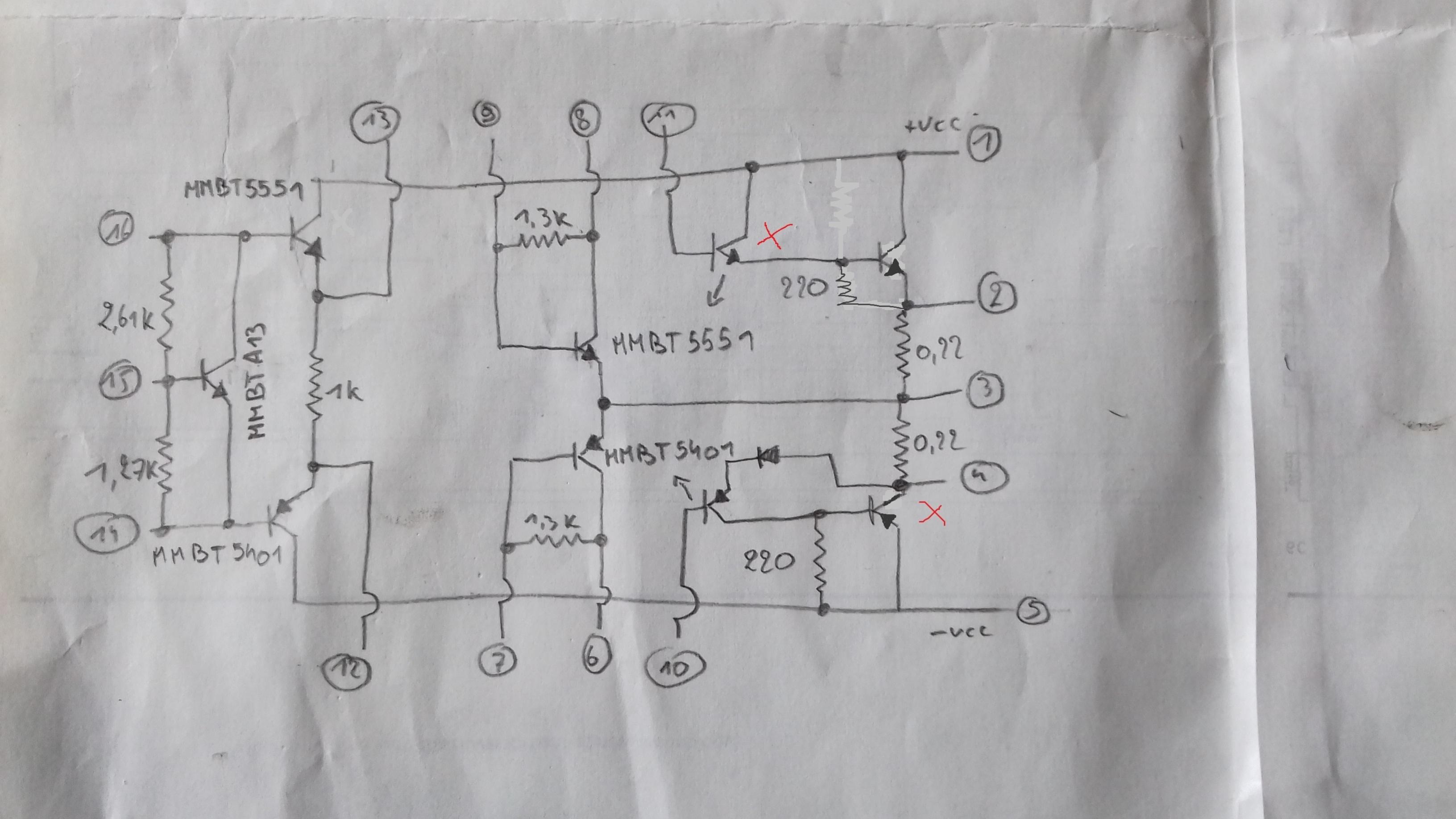

I opened one of the 2 stk modules in the amp that has one working channel. This one is definitely a fake but the one that's still working is an original.
I took a picture from the inside and got a schematic from the internal circuit (I don't think I made mistakes but it's still possible). There seem to be some major differences with the schematic of the stk8050 that can be found online (last image). The red crosses are the 2 transistors that have failed.

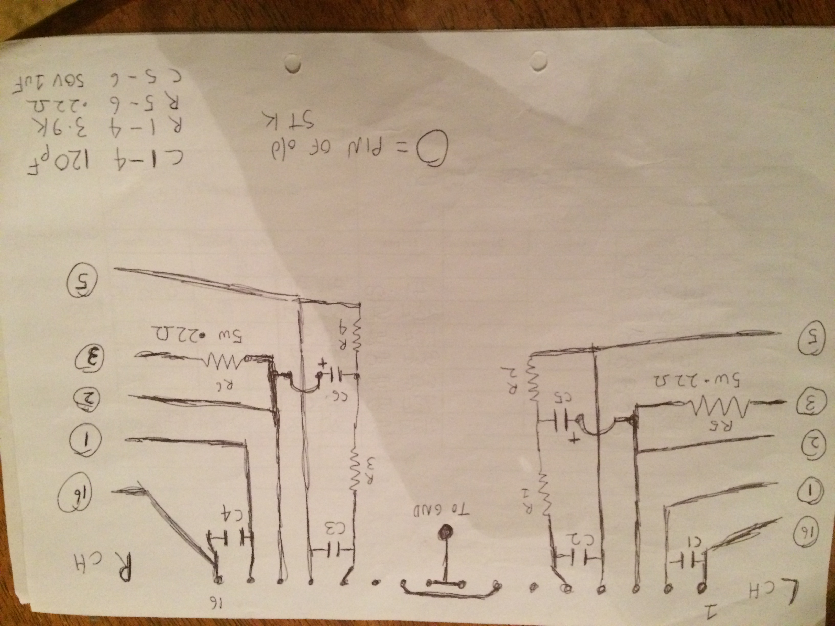

Was trying to make this on pcb software and it heat losing the file
Make a pcb similar (only has to be enough in size to place components and connecting wires.
I have added in the output resistor for existing protect circuit
I have ran with resistored constant current
C1-4 should be close to power ic for stability 120pF
C5,6 50V1uF
Hope this is of some use
C5,6 50V1uF

Also something that is bothering me, why are pin 5 and 12 ont the svi2004 (labeled as - audio in) connected to the negative power rail through those 2 resistors, shouldn't they be connected to the original pin 14 of the stk ?
The heatsink is going to be a problem for me, I don't have the tools to do that properly.
