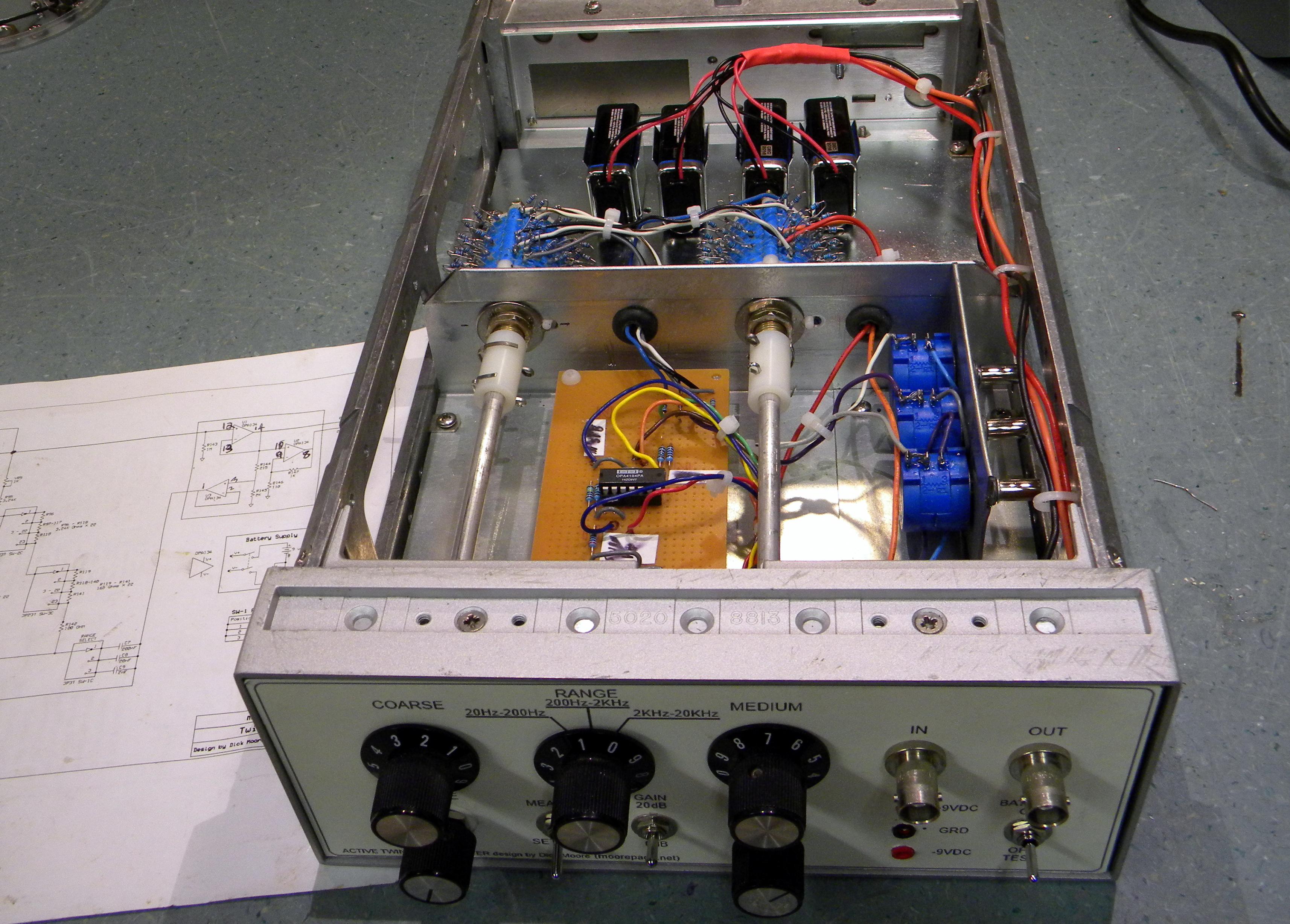

My Implementation of Dick Moore's Active Twin-T

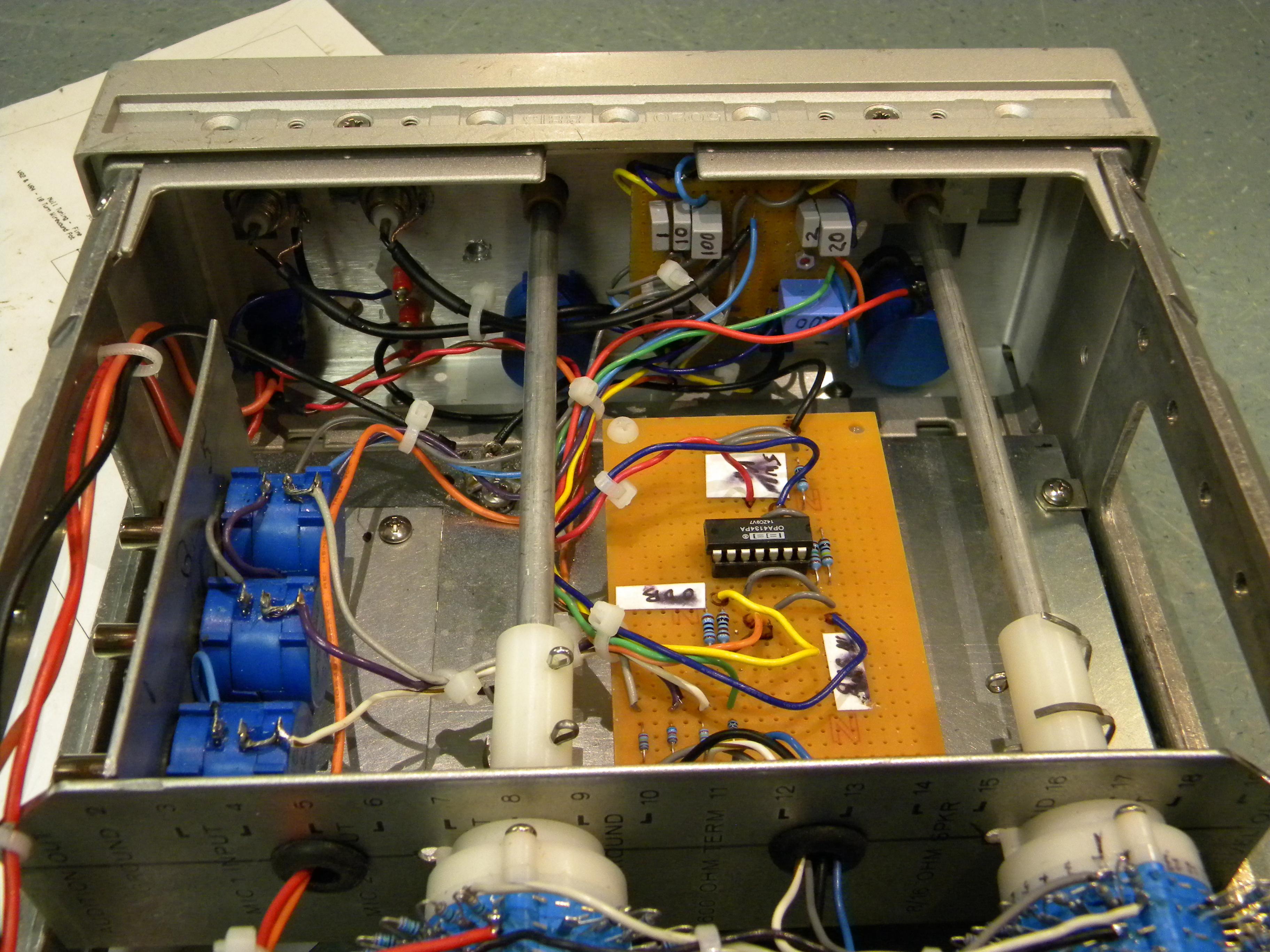

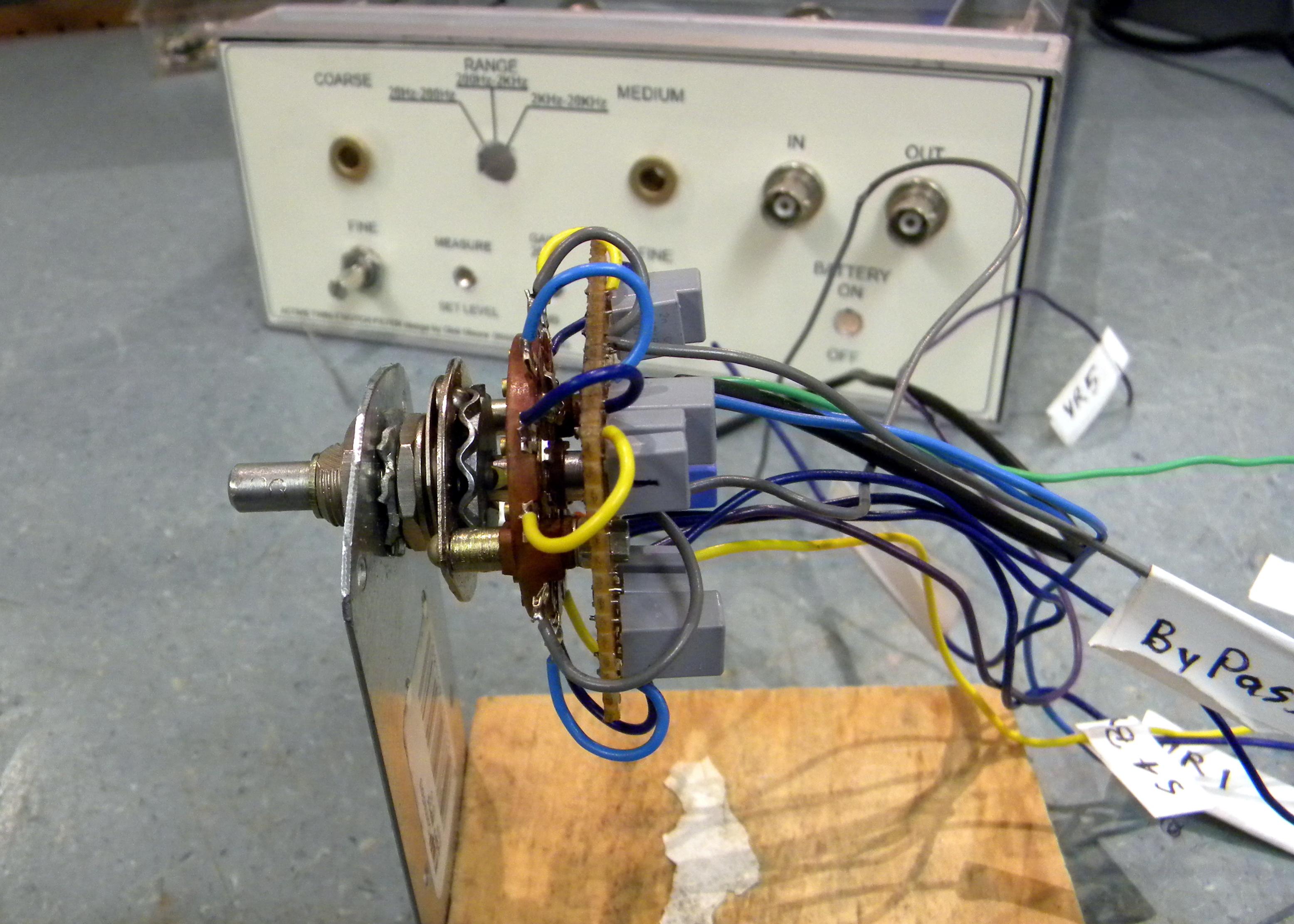

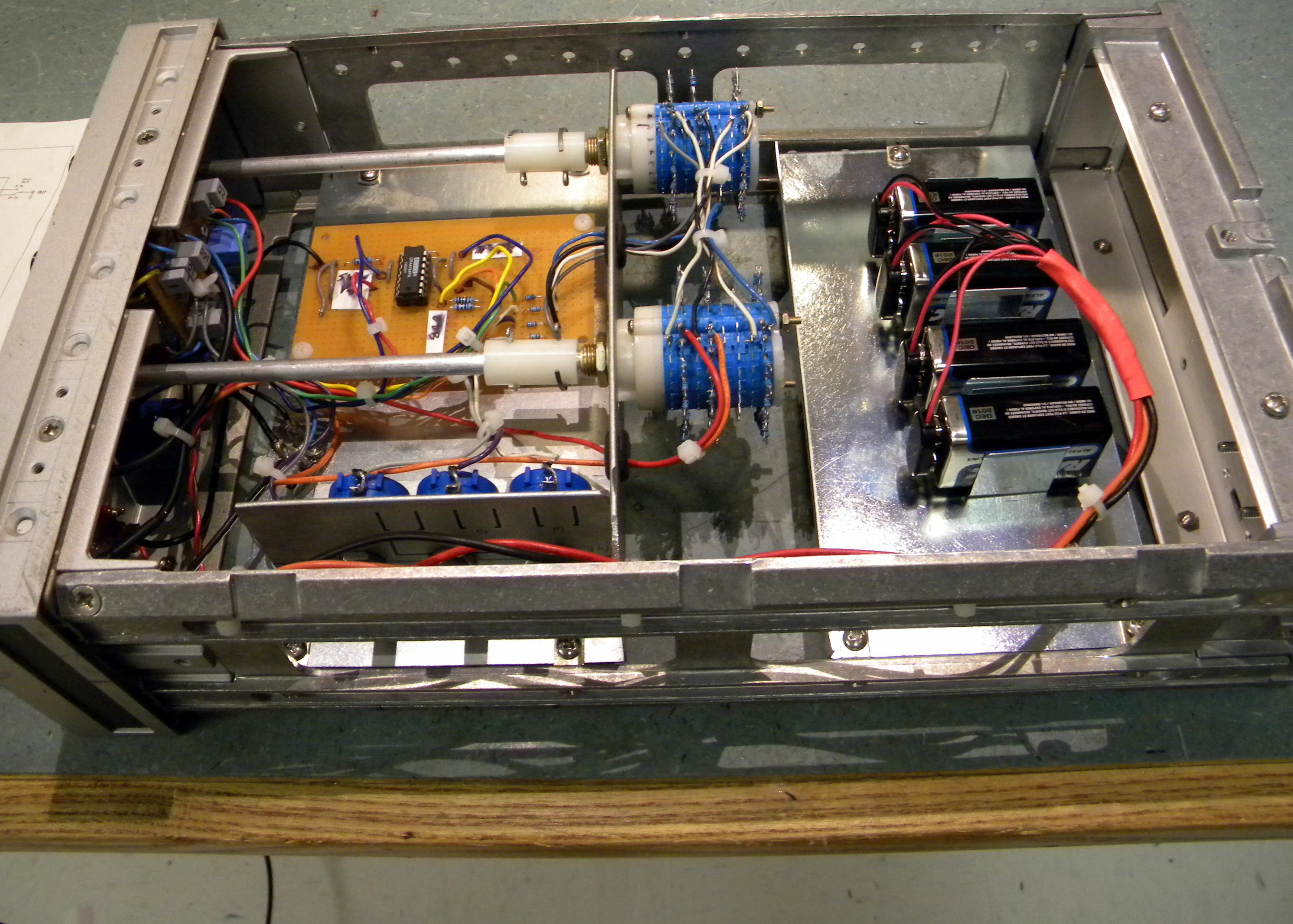

I have been trying to outfit my bench with useful test equipment on a budget. My latest quest is distortion measurement. After a lot of research I have decided to go with a PC based system and Dick's Active Twin-T Notch Filter.

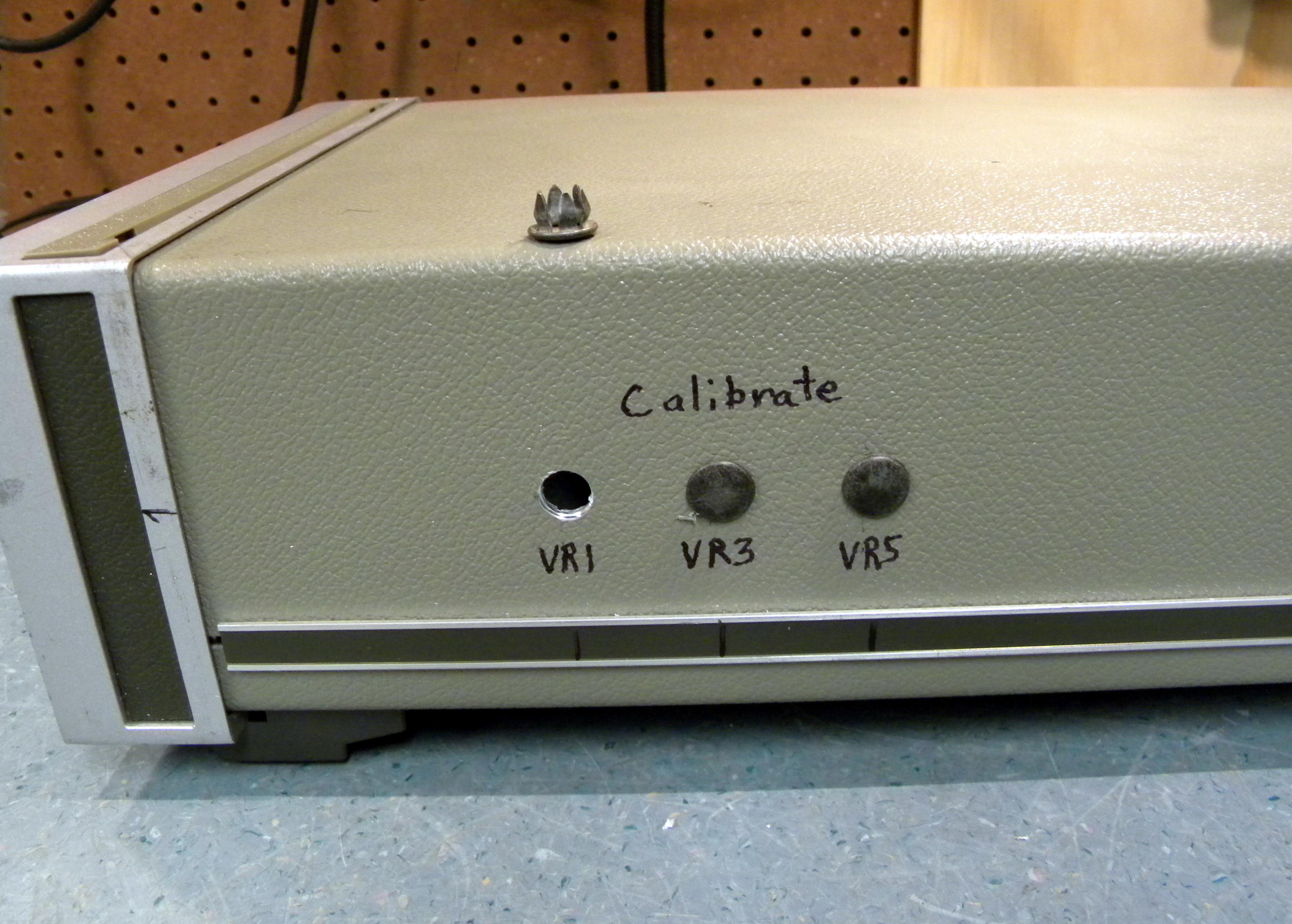

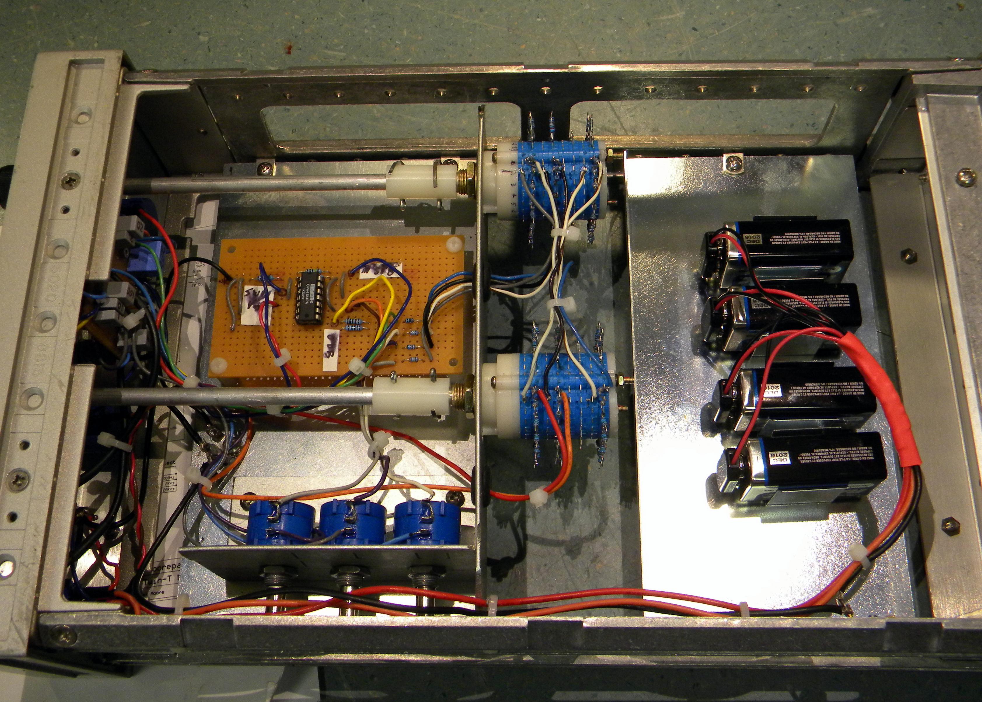

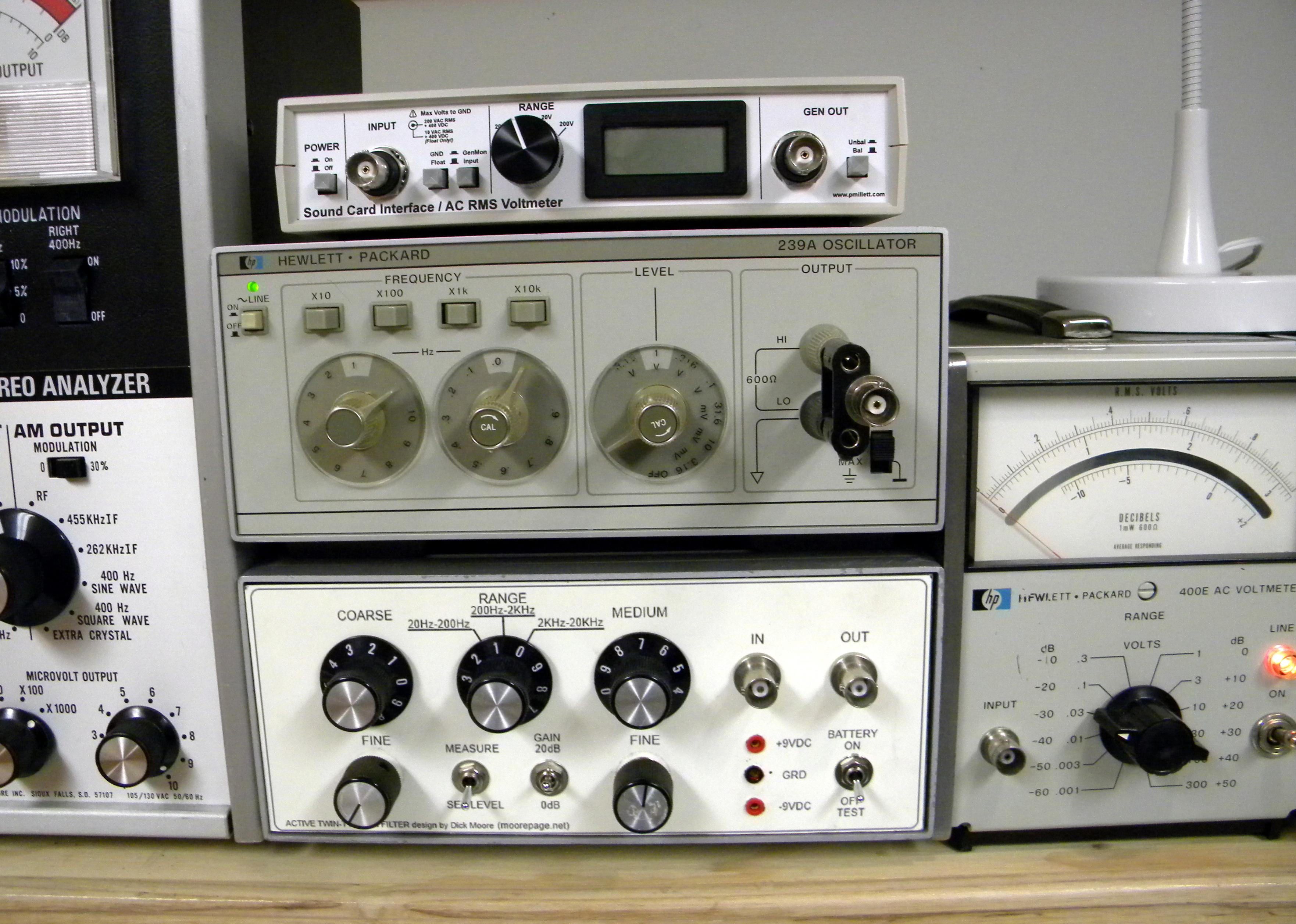

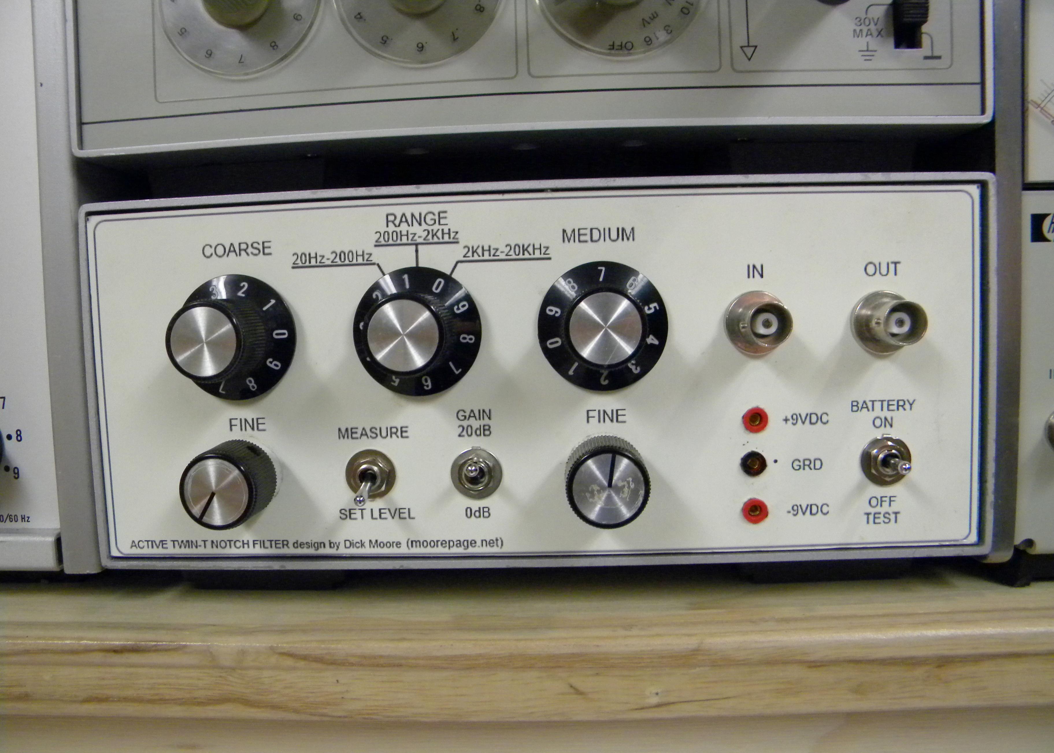

This was a fun project. For the box I re-purposed an HP/Agilent 37203A HP-IB Extender. I found this HP device at a salvage store for cheap and is a common box used by HP to house many of their test equipments including my HP239 Low Distortion Oscillator. This box is a perfect match because I intend to the Twin-T filter with this HP oscillator. The box should also provide excellent shielding.
Because of the small front face plate I had to move the 23 position switches further back into the box using DIY extender rods.
I made no changes to Dick's circuit design. I did add test points to the front to allow me to verify battery voltage without opening the box. I am still looking for front panel knobs that are better suited for this application. But in the interim, these work.
The filter works great and I highly recommend it to anyone on the decision fence. Here are the pictures of my build:

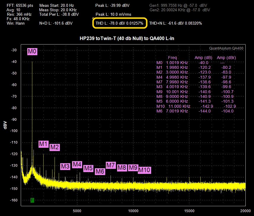

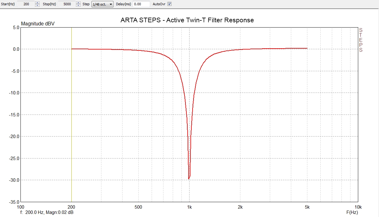

How does it work? I am still testing and getting acquainted with the Twin-T filter and my new PC based analyzer as a system. My first impression is very promising and I am very excited with my results.
Here are some measurements using my HP239 Oscillator as a source.
The first screen shot is a response curve of the notch at 1KHz using ARTA/STEPS and my E-MU204 sound card.
Note: I was able to achieve an amazingly low -90dB notch (as measured on other equipment). The STEPS software is not capable of showing the true depth of the notch, however, I feel confident in the accuracy of the notch from 0 to -10dB. You can see very little attenuation at 2Khz where the first harmonic exist. H2 attenuation would only be about -.01dB.
The next screen shot is using my new QuantAsylum QA400 USB Audio Analyzer, HP239 Oscillator and my Twin-T filter. The QA400 reports 0.0125% THD and taking into account the Twin-T -40dB notch, the actual THD of the oscillator is 0.000125%.

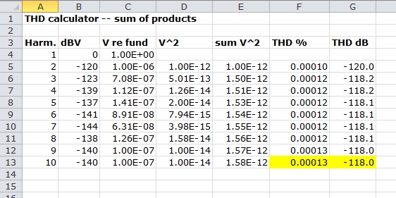

In the final screen shot I further verified the accuracy by calculating the sum of the first 9 harmonics at 0.00013%.
This is a learning process for me. If any of my analysis is incorrect, please set me straight.
Thanks for looking. I also want to thank Dick for all the personal help he provided me, and for sharing his work with everyone. His web site at moorepage.net is an excellent resource for this project as well as his many other useful projects.
