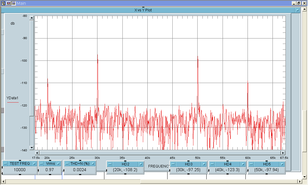

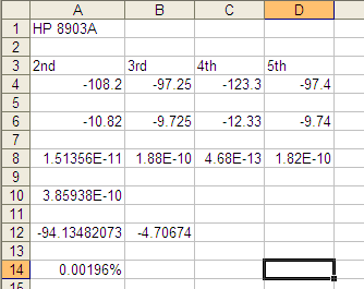

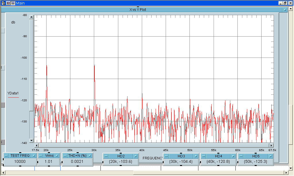

I set the output to 1Vrms and the spectrum analyzer scale read approximately 0dB. So, with the output at 1 Vrms at 10kHz I nulled the fundamental by about 60dB and got the following spectrum plots for the 4402B and the second one for the 8903A.
To get the full spectrum to plot, I will have to tweak my VEE program. That will take a few days.
What do you think about the results?

About what I would expect from the 4402B at 10kHz, and the 8903 is worse than I expected.

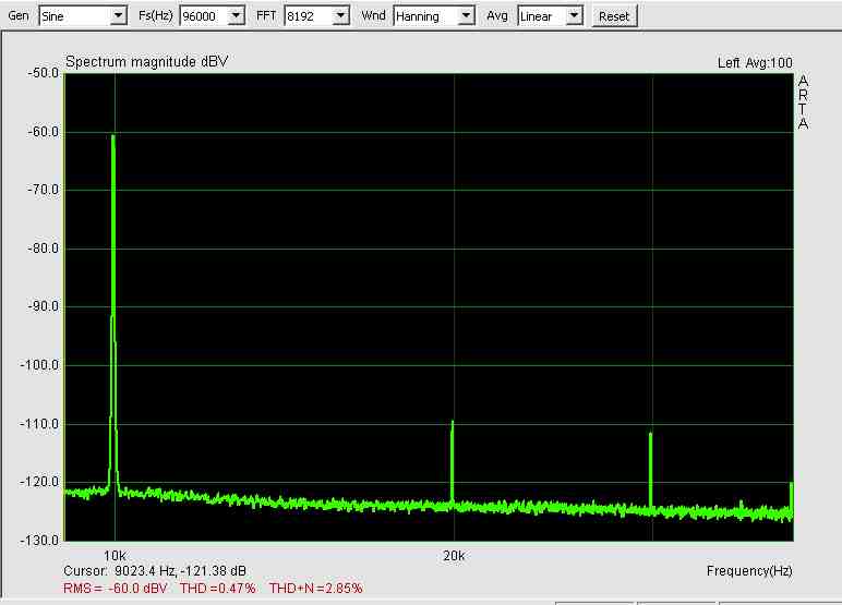

See below the comparable 1VRMS @ 10kHz spectrum (up to 40kHz -- as high as my computer can see) for my HP 239A -- the fundamental is at -60dB re the 1V input. (I rescaled the spectrum to dBV)
Note that the calculated THD of about 0.5%, re the -60dB fundamental, fairly accurately reflects the RMS sum of the visible harmonics, roughly 0.0006%

On the 4402B, check the DC voltage at TP4, and adjust R145 to get 0VDC (the allowable range at TP4 is +/-1VDC -- that's a lot). Small changes here may have an affect on the residual THD.
As to the 8903A, I'm not sure that there is anything you can do -- looks like the oscillator and its AGC either work or they don't....

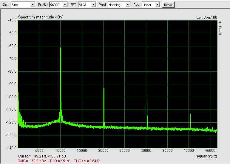

For comparison, I've attached the spectrum of my State-Variable Cordell oscillator at 10kHz and 0dBV -- 0.0025% -- worse than your 8903A.

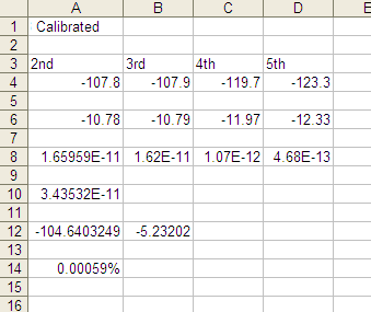

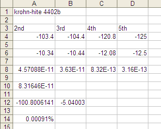

I found the adjustment as you described in the manual. I think the tolerance is +-0.1V I got it down to 0.015V. The 2nd and third improved. I also figured out how to get the spectrum analyzer to average the values, instead of just getting a snap shot at a specific instant. Here are the new calibrated values for the 4402b.

Much better but still a long way from the spec and typical values that K-H list.

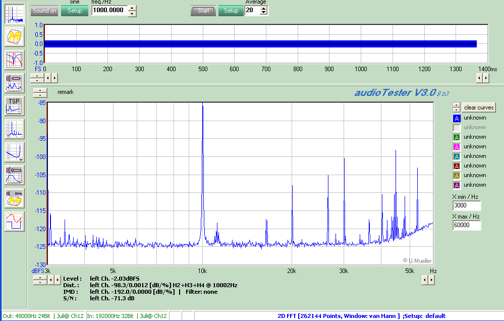

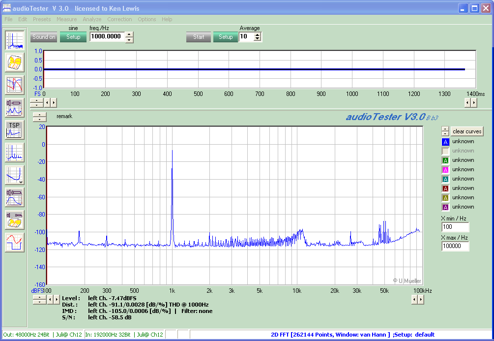

I hooked up the K-H 4402B to my computer sound card this morning through Pete Millett's sound card adapter. I have the Juli@ card in the balanced mode and didn't have an adapter from the BNC to Balance, so, went through the adapter instead. I adjusted it as close to 0dB as I could, but, when I got close, the 3rd harmonic started to rise up in an unusual way. I just remembered that their is an adjustement I have to make in the software. The results are shown below.
I also tried it with the Twin-T, but, it didn't seems very happy. I will look into the Arta software and a BNC to Balance cable.
The other piece of news is that the K-H did not measure as well this morning on the 3562A as it did yesterday. The adjustments don't seem to hold. There are a few electrolitic caps in the unit, maybe they are at the end of their life. The unit manufacture date is 1997.
Ken

RE post #51: I'm not familiar with Millet's adapter -- is it described here at DIYAudio? Intrinsically, for balanced inputs you just ground one of the inputs and feed signal into the other one.
The Juli@ card looks interesting to me; I think it and the ARTA software should be a good match. ARTA is free to use with no time limit in demo mode with very few restrictions -- you just can't save setups and a few other things. Highly recommended. The AudioTester app has a nice display and obviously lots of options -- I'll take a look at their page. The amount of spurious stuff in the plot is troubling, as is the rise in the noise floor above 40kHz -- I can't really come up with a reason for these artifacts. A sharp rise in 3rd H. should be accompanied with a similar but even sharper rise in 2nd if the issue is dynamic range of some part of the gain chain.

Pete's adapter is in the Tube forum. I'll find the link... I haven't been able to master AudioTester's calibration. Arta seems worth a try. I believe the noise at 40k and beyond is the switchmode supply in the computer. As it is, I unplug my monitor before running the test otherwise you would see two off scale spikes at about 44 and 46 kHz.
I've decided that the rise in the third harmonic came from overloading the adapter which was set in the 2v range and has diode voltage limiters. I think the voltage was at about 2.3Vrms when I was trying to get 0db AT.

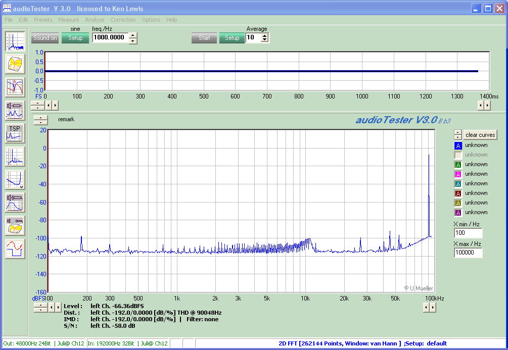

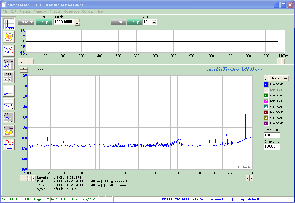

Looks like the Juli@ will go to 90kHz. First plot is a 1kHz signal, 2nd an 80kHz and third a 90khz signal all at a similar amplitude generated by the HP8903A. (I set it at 0.5Vrms at 1kHz and by 90kHz it was down to 0.279Vrms) The last plot, I turned of the fluorescent lights and the computer monitor.

Hi Ken -- the level reading below the plot shows -8dB at 80kHz and -66dB at 90kHz, and yet the spectra and S/N ratios look essentially identical -- do you know why that is? Anyway good news on BW for Juli@. Thanks.
Hi Dick,
I noticed the same thing. I'm just guessing, but maybe 90kHz is just beyond the limits of either the card of the software. I didn't try 86kHz, being half the 192kHz might be the limit.
