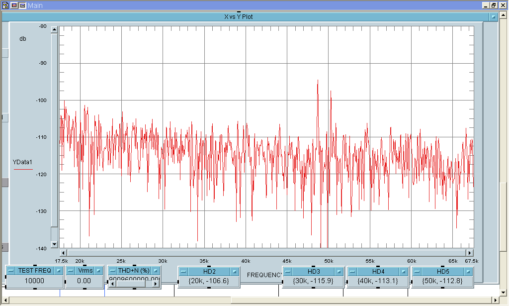

Dick,

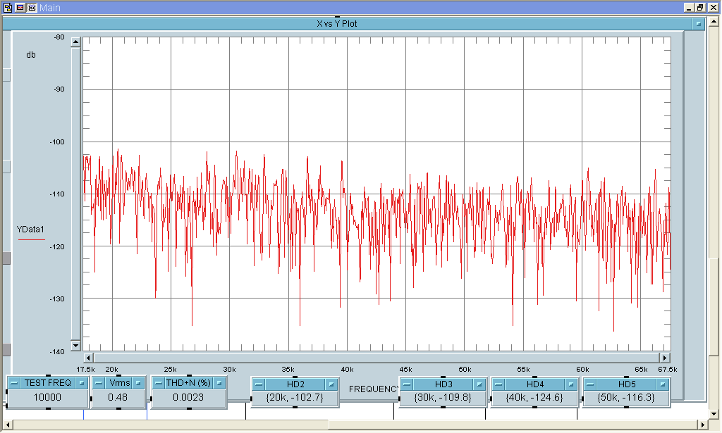

Attached are the following:
Image:
1. 10kHz 0.5v 0db
2. 10kHz 0.5v +20db (for those following along, subtract 20db from the harmonic values to get the true value)
3. 10kHz 0.1v +20db
1k to follow in next post
Ken

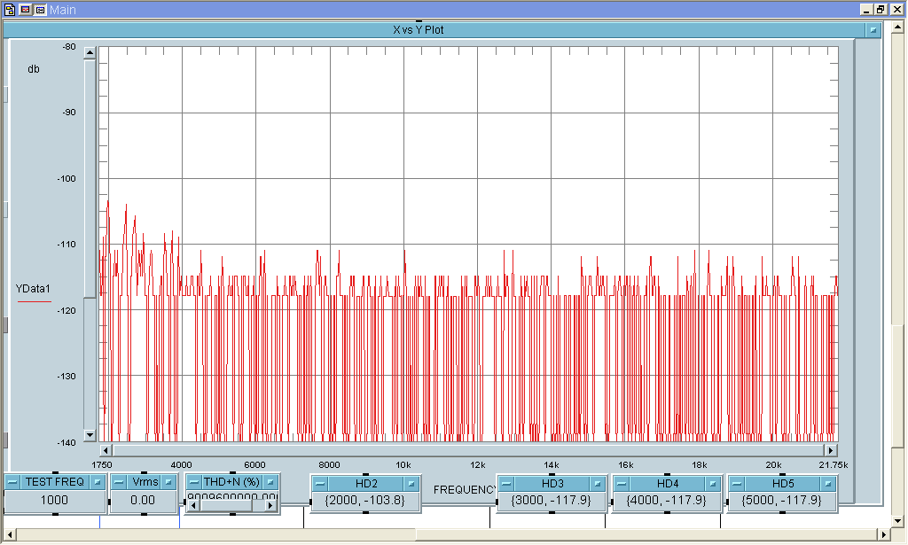

Part two:
( I forgot to mention I cooked up this program in agilent VEE to drive the signal analyzer and the 8903A, the vrms and thd display boxes are not turned on, as the cable is not connected currently to 8903A input)
Image:
1. 1kHz 0.5v 0db (couldn't get quite as deep of a null in the middle setting range -40 db so the -20db is worth showing)
2. 1kHz 0.1v +20db
Ken

Ken, what is the maximum output of the 8903 at 1kHz? 3.16VRMS into 600 ohms -- 6.3VRMS into hi-Z (like the Twin-T)? I was wondering why you are using such low output voltages?
Dick,
Max output looks like 6vrms. I am used to testing power amps, so, I run in the .1v to 1v range. I'll give it a go at higher power and see if it changes the THD.

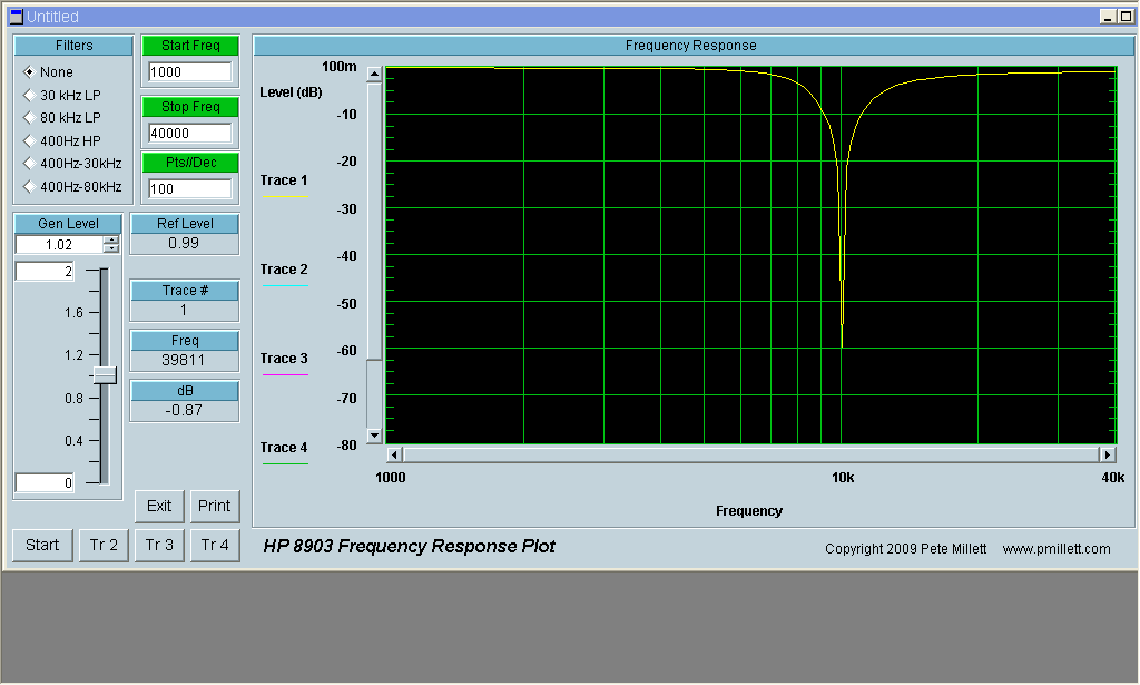

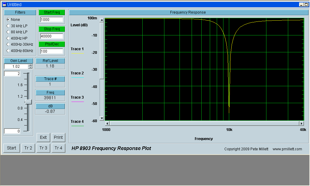

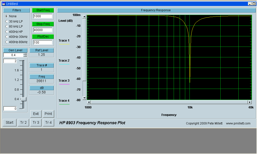

Hi Dick,

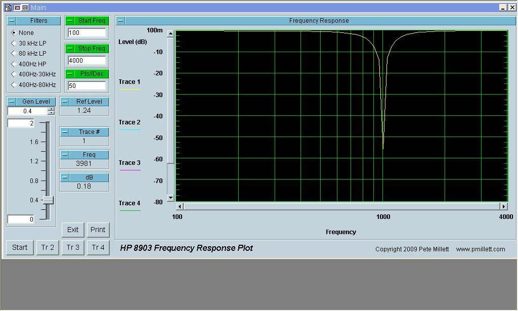

I ran a frequency response plot (thanks to PMillett) of the Twin-T. Input voltage 1v, Twin - T tuned to 10kHz about -60db null. You can see that it's a bit lopsided. The value at 1kHz is 0db, at 20kHz it's -1.42, at 30kHz it's -0.98db. I ordered some 1% caps today and will see if that helps.
What do you think?
Ken

I think you should repeat this trial with a 1kHz fundamental, just to eliminate any possible bandwidth issues with the active amp in the filter, then check the actual upper bandwidth (-1dB) point of the filter.
I also think that it looks like the filter is being driven from a 600 ohm source, which will tend to cause the lopsided response -- 600 ohms is about the upper limit on source Z for decent measurements. Try driving from a lower impedance source, like the output of a power amp -- just for response checking. Then for distortion readings, you can always re-normalize your "0dB" to the upper passband level resulting from the source Z that you're using, without causing problems, because the products you're measuring are all in the upper pass band of the filter. It is always good to have bandwidth/level plots for the actual measuring conditions that you are working in.

Hi Dick,
How do I check the upper bandwidth (-1db) point of the filter?
I ran the 10k and 1k plots through my power amplifier. The 10k improved a bit to -.97db at 20k and -.60 at 30k. Then ran 1k again through the amp and got -.09db at 2k and +.12db at 3k. So, it seem more like a bandwidth thing. Also seems to answer the question about whether the Q is too high (probably not). I can't get as deep of a notch on the 1k setting as I can on the 10k setting. I'm thinking that this is a result of the capacitors not matching as well. I ordered 1% caps and will re-fit those along with moving the trimmers to be adjustable without opening the box.

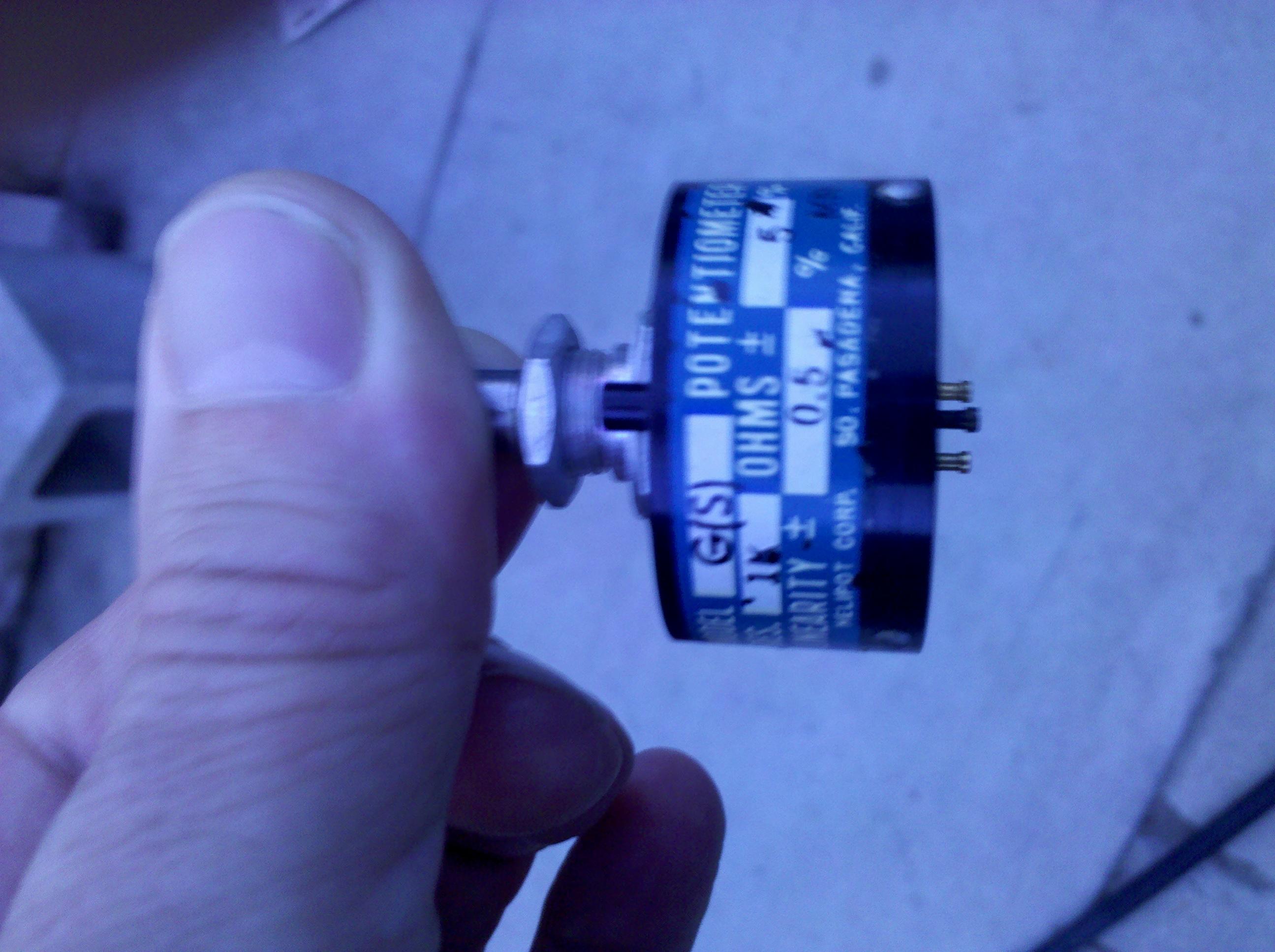

Found some nice surplus precision 1k pots for 50c each for the trimmers.
Ken

Hi Ken -- just got back from a little fall trip to Mt. Baker. If you're basing your assessment of the notch depth by sweeping the filter using a sweep from the 8903, this will not show the true depth of the notch -- the sweep frequency resolution just isn't fine enough -- we're talking milli- and micro-Hertz here. Use a fixed frequency source and manually tune the filter while looking at the filter output on the spectrum analyzer's display.
To check the filter's HF roll-off, just put the filter in bypass mode and check the response as you normally would for any amplifier -- it's entirely a function of the filter amplifier's response -- the Twin-T has no effect on the upper bandwidth limit (at least as long as the source Z is fairly low).
Nice pots!

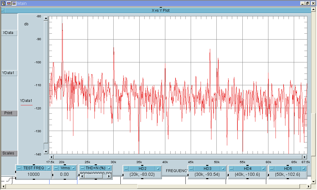

Hi Dick,
Have a look at Post #30, the second plot is the 1kHz fundamental. It's at -0.19dB at 2nd H. So, better than the 10kHz. Still, the 10kHz is good enough for me.
I fired up the 4402B this morning (couldn't resist). Set at 10kHz, with it's volume pot set at 2Vrms, the fundamentals we're so good, turned the volume down to 0.6Vrms and the fundamentals went very quiet. Re-calibrated the spectrum analyzer and got 2h -113dB, 3h -123dB 4 & 5h down in the noise. Turned on the +20dB switch and got 2h -92dB, 3h -103dB 4 & 5h -123db.
The 8903a reported THD+N at .0022%, probably more noise than THD. I didn't have a thumb drive handy, but will retest and post images.
Ken
So, the 10kHz harmonic products sum to something under 0.0003% or 3ppm -- that's very good. I suspect that the notch filter fine tuning of the 8903A may be a little off -- there are a couple of pots that fine tune it. Be sure to switch the 80kHz filter (or even the 30kHz) in when measuring at 10kHz, since there are no significant products above the 3rd in the 4402B.

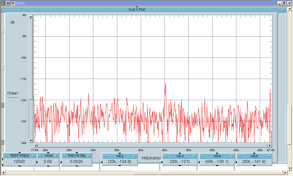

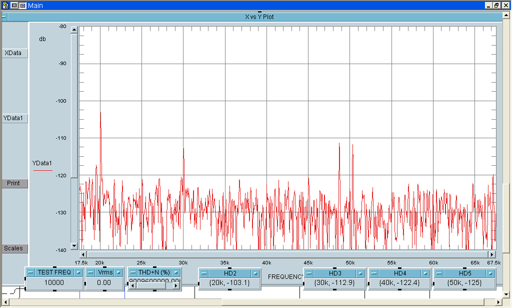

Hi Dick,
I ran the 4402B at about 0.4 Vrms 10kHz and got the following plots. The first one is with the Twin-T set at 0dB gain, the second one at +20db gain. The machine was set in the 1k to 11k range- which the manual shows as the lowest distortion range.
If I turn the volume nob of the 4402B up, the Harmonics start to show up, say above 0.8Vrms. But, if I use the -20db attenuator on the 4402B, the harmonics don't show up with the volume nob way up. Seems that much more that 0.8 V overloads the Twin-T. Maybe the batteries are starting to sag.
Still, nice to the 4402B has very very low distortion.
Ken

OK Ken, I'm a little confused -- what was the attenuation of the fundamental through the Twin-T for these plots? It would really help if you included the fundamental in your plots. Do you leave it out because of something to do with the spectrum analyzer?
I ask because with the fundamental nulled by 20dB or more, I can put 6VRMS into the Twin-T without changing the relative levels of the distortion products. I've used the HP 239 to verify this by using the 239's step attenuator -- on it's output -- which selects in 10dB steps (a convenient size) while leaving the oscillator's output amp running at full level.
Is there a headroom issue with the analyzer?
