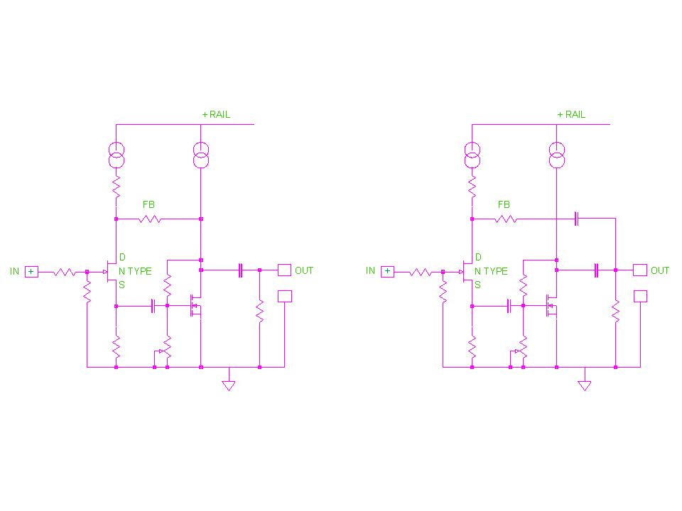

Looking at the Nelson's schematic from post 1:
What could be the outcome of flipping the S-D connection on the buffer and take the feedback from after the output caps? Still a source follower connection.
Of course the idea is to get rid of the input cap.
Would this result in a higher distortion?
Should we need to change to a N Jfet?

If you flip the SD you would necessarily need to go to an N, but
also the feedback would become positive due to the polarity
inversion of the input device. Still, with some re-arrangement,
you could get something like what you want.
Blues said:
Try this...
Great, but what I understood from Nelson is that one could not connect the global NF that way since it will be positive FB with the N channel FET connected as common source. For that reason the schemo I posted had the FB conected to the Drain. 🙂 ...Don't know if thats possible

Re: Problem with input-buffer (ZenV4)
I used ZVP 3306A , works fine . I have many of them, and they are easy to find .
