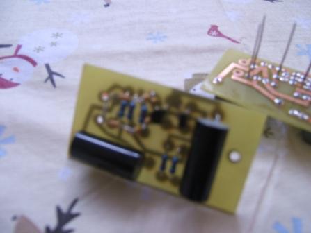

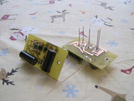

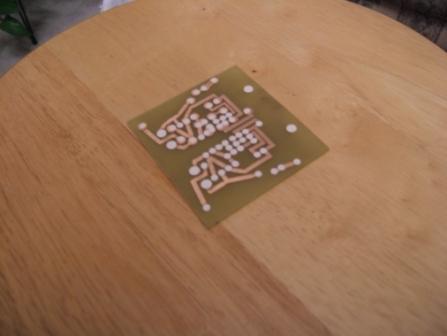

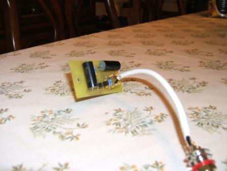

Here are preliminary pictures of the Blues Buffer (B^2)boards I made. These will ride piggy back on a Zenv4 pcb to replace the mosfet input buffer circuit with a jfet. The circuit board can also be used as a BB Brother (B^3) board which has a cascode circuit using a mosfet...in this case the zvp3310.
Jfets are 2SJ74s through the kind heart of Steen all the way from Singapore via the beautiful Kenteminde.
In Holiday tradition, note that I strung together yellow Christmas lights to get about 1.6pF for the feedback cap...due to not having an oscilloscope I'm relying on the Sim software to give me a nice square wave at 10kHz onwards.
Will post pics with the Zv4 board as soon as I receive the 3W 2kR21 bias resistor which I ordered initially at 1/4W. Darn! It's a wait until after Christmas.

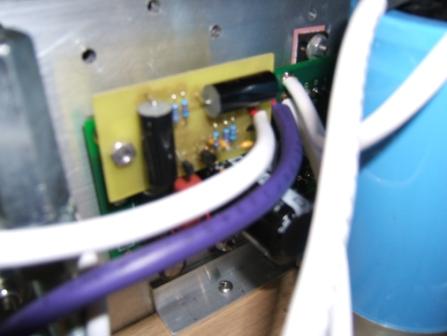

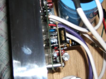

One Channel Up
Singing in mono the jfet buffer is indeed sweet. The sound is now more extended in the high frequencies, midrange is still as sweet as can be. The bass sounds promising and can be more appreciated in stereo (still working on the left channel). In mono the music is now more defined and clearer compared to the old buffer. With a stock Aleph 3 as my reference the Zenv4 used to lag in this department and in the high frequencies. It has changed and I like what I hear. More on the sound when I get it in stereo.
Here are pictures of the working channel. 😀 Big grin indeed!
