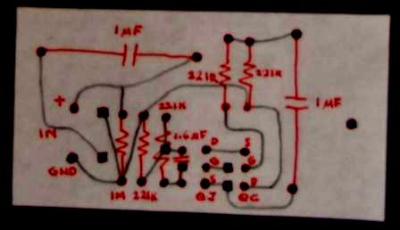

Here's the pcb design drawn by hand...
The cascoded jfet buffer is to me a very worthwhile upgrade...a bit of effort for a really big improvement. I used to miss the Aleph 3's fine top-end using the Zv4 but the Blues Buffer's Brother (B^3) changed all that. The Zv4jC sound now really gives the A3 a run for its money.
Allan
Big Thanks to Mr. Pass for the jfet buffer circuit and to Steen for the jfets and for calling it Blues Buffer (B^2). 🙂
A bit out of focus, my friend. Can you enlarge the picture?🙂

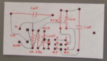

I'm reposting the picture of the pcb design. I hope it's much better. The square dots (sounds like balanced/single-ended🙂 are where the pins/stilts connect to the stock Zv4 pcb and the one in the middle of the 1.6uF cap is the jumper wire connection of the feedback. Note that the feedback is now taken before the output caps. Also, referring to the Zv4 circuit, remove Q4, R13(replace with 2.2k/3W), R3, C12 and R20(replace with jumper).
I think I posted the mirror image -if that's the case just trace the reverse image.
