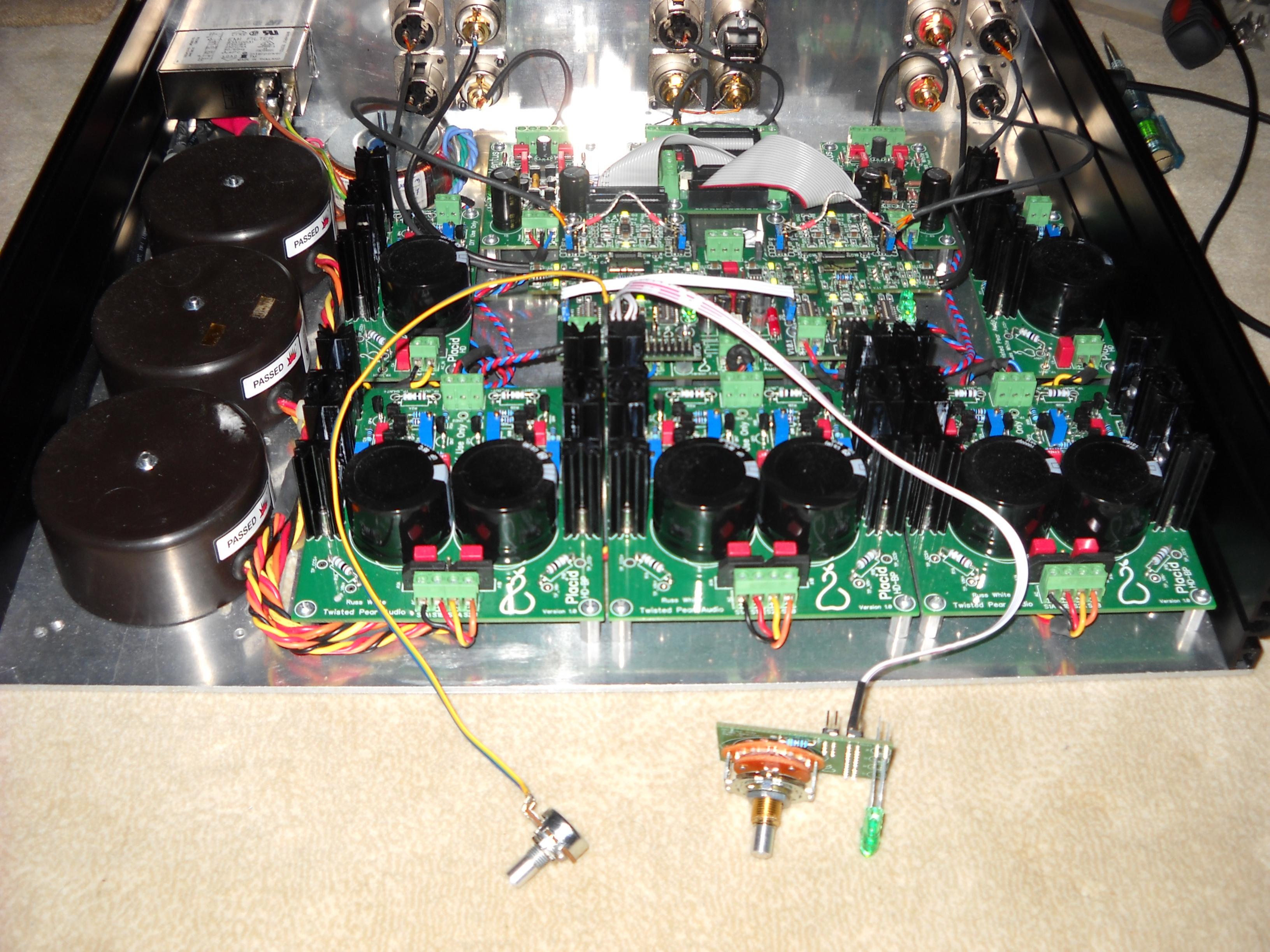

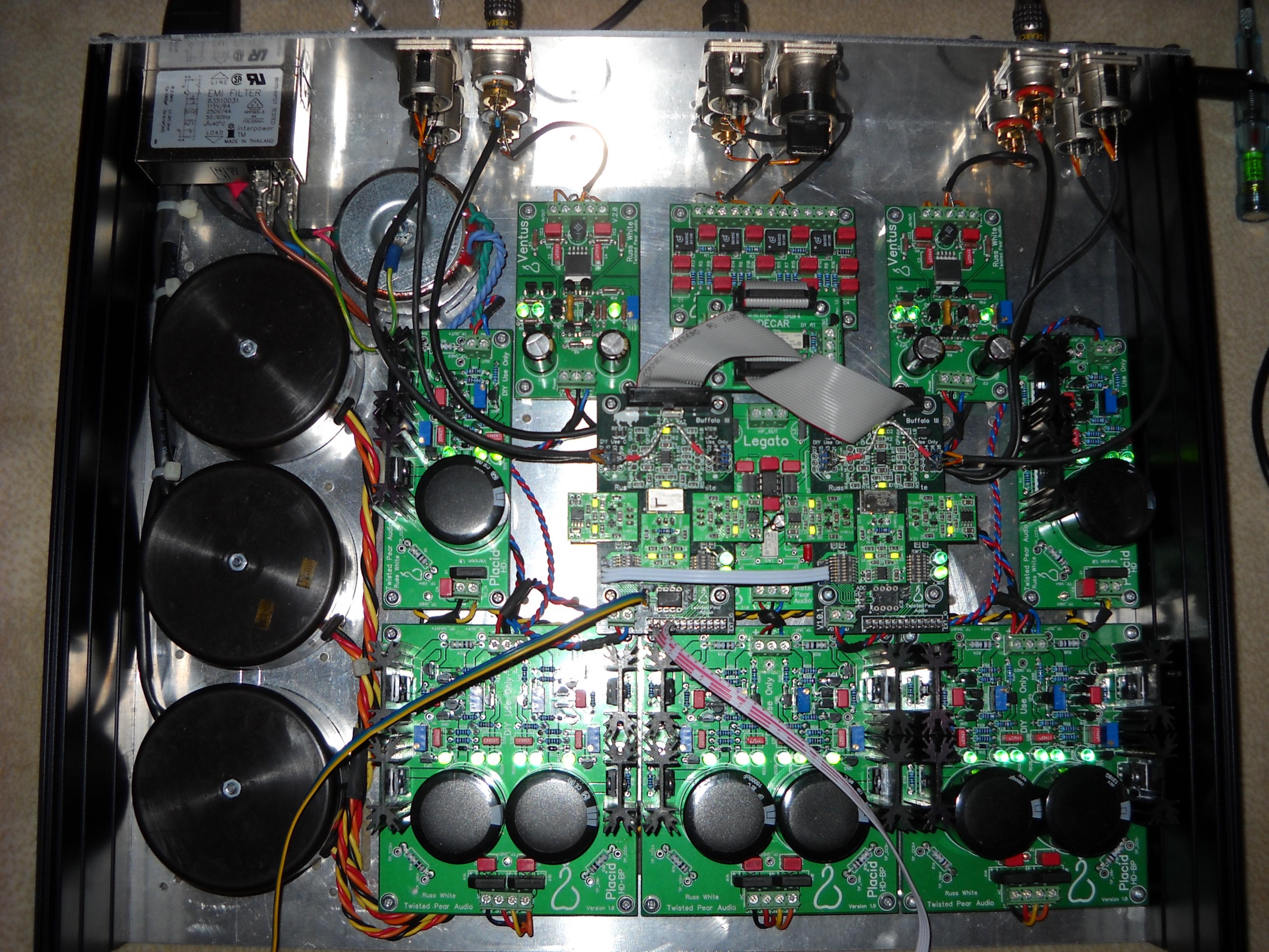

Hello guys,
Unfortunately I still can not start listening to music!
As I said I read from cover to cover the BIII DAC Integration Guide and have configured the system as I understand.
I used the following: 4-Channel S/Pdif-4input board*Sidecar*two BuffaloIII modules*one Legato 3* two Ventus HA*2-bit rotary switch*volume control.
1. I followed the instructions on page 21, "Sidecar and S/PDIF-4 input board integration", so I have not mounted JPCM1,JPCM2,JPCM3,JDSD1,JDSD2 on both BIII modules.
"Solder the 24-pin unshrouded header for the EXT_IO connector (EXT_IO, 12) in place. This allows you to connect the switch for the input selection of the S/PDIF-4 Input Board"(page 21)???? . More explanations here!
2. For dual mono I followed the instructions on page 23 step by step for both channel.
3. DIP switch setings:
SW1: 1 - off
2 - off
3 - off
4 - off
5 - off
6 - off
7 - off
8 - off
SW2: 1 - off
2 - off
3 - on
4 - off
5 - off
6 - off
7 - off
8 - on
These settings must be made on both BIII in dual mono? On right channel I remove the on-board firmware controller from the board, jumper on ADDR, jumper on R7!
"Only a DAC board with both the firmware controller and L5 in place and R7 not shorted will respond to the DIP switches"!!! page 23.
Can someone give me advice? Russ White, Brian Donegan, LeonvB,...?
Would have been ideal to do one diagram for BIII Dual mono one Legato!
Thank You!

Have you already tested the individual modules?
DIP settings are done on the board with the on-board firmware.
Dual mono with 1 I/V stage is not a standard configuration. I'm already at 52 pages covering just the basics, it's simply impossible to document everything you could do with the boards.
