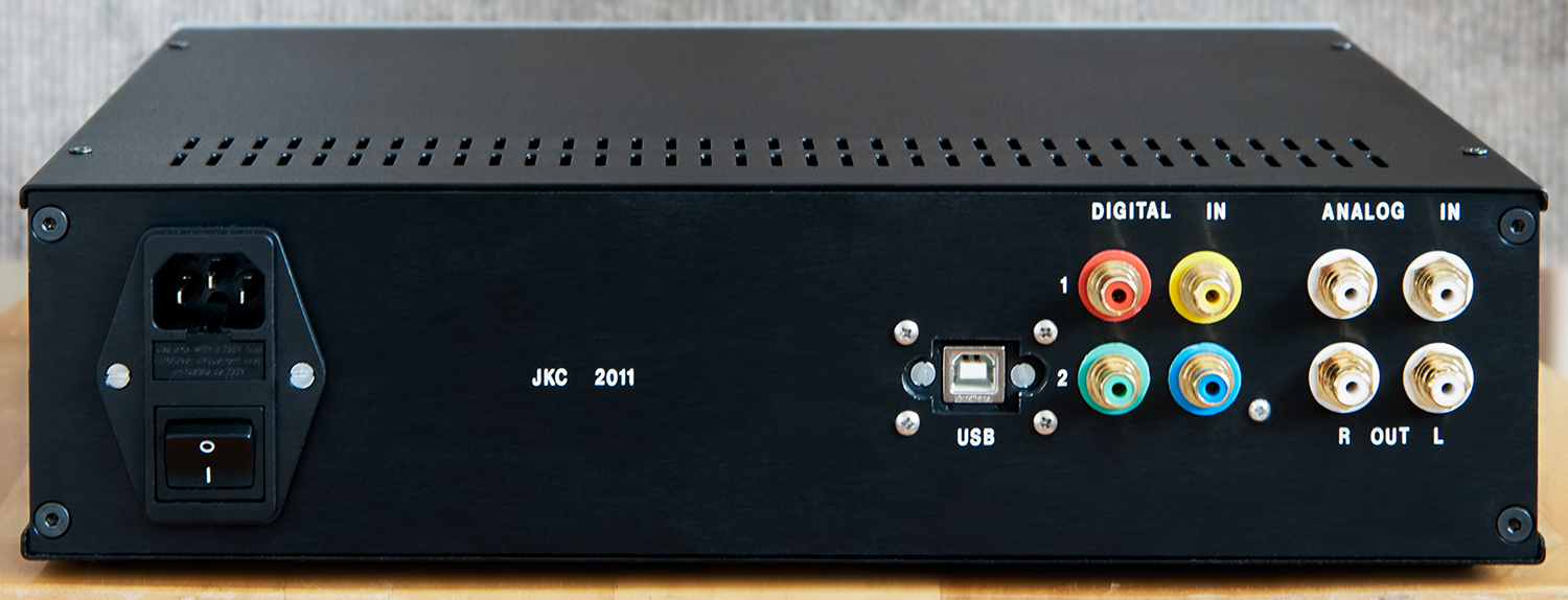

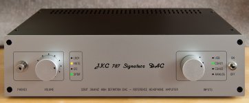

Here is my DAC that I have designed based on TPA modules. Everything is working fine except USB port that will be added soon (right Russ?). I have tested it up to 24bit/192kHz on SPDIF inputs only. I would like to thank Russ, Brian and Leon for providing this opportunity.
George

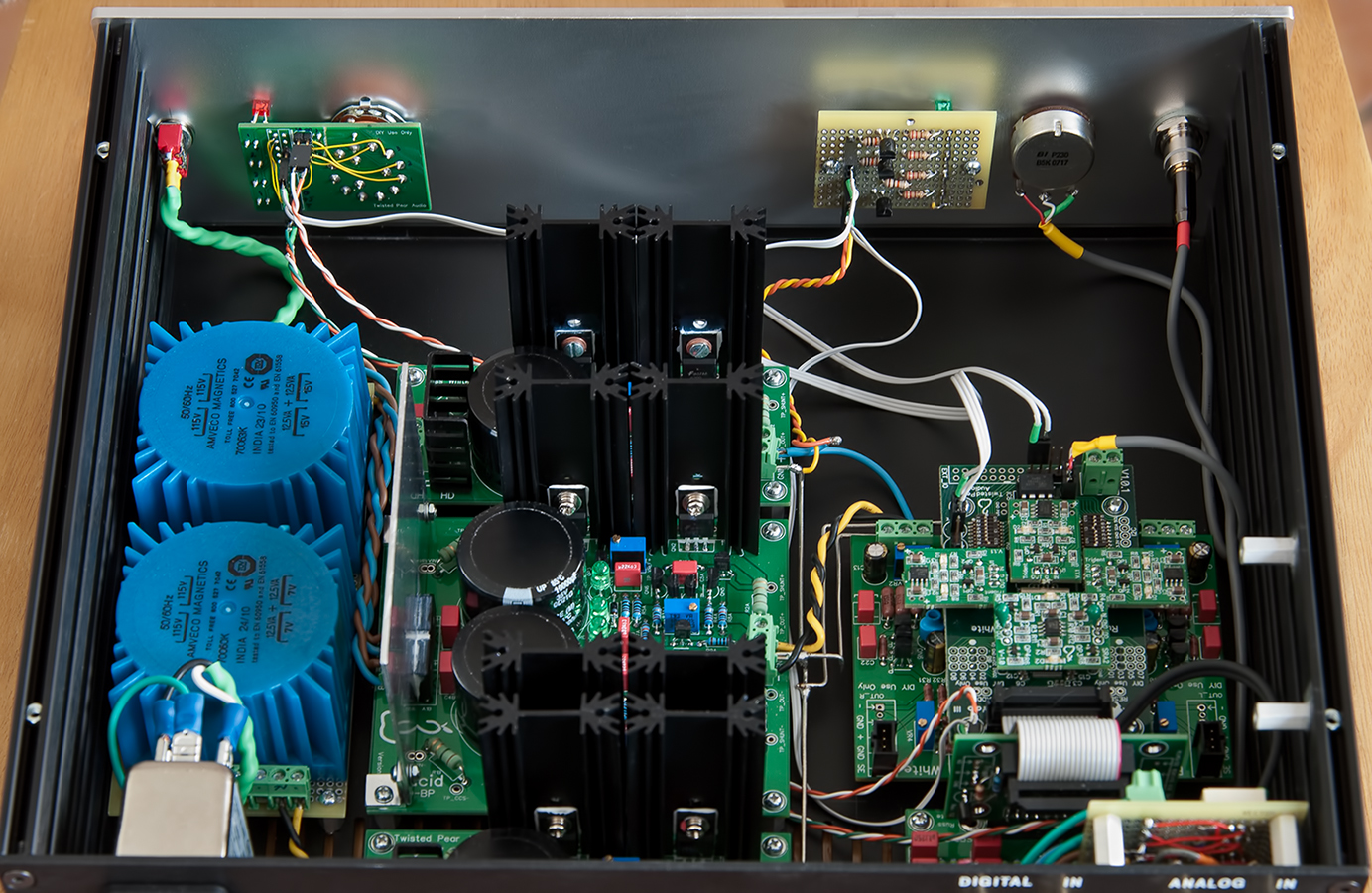

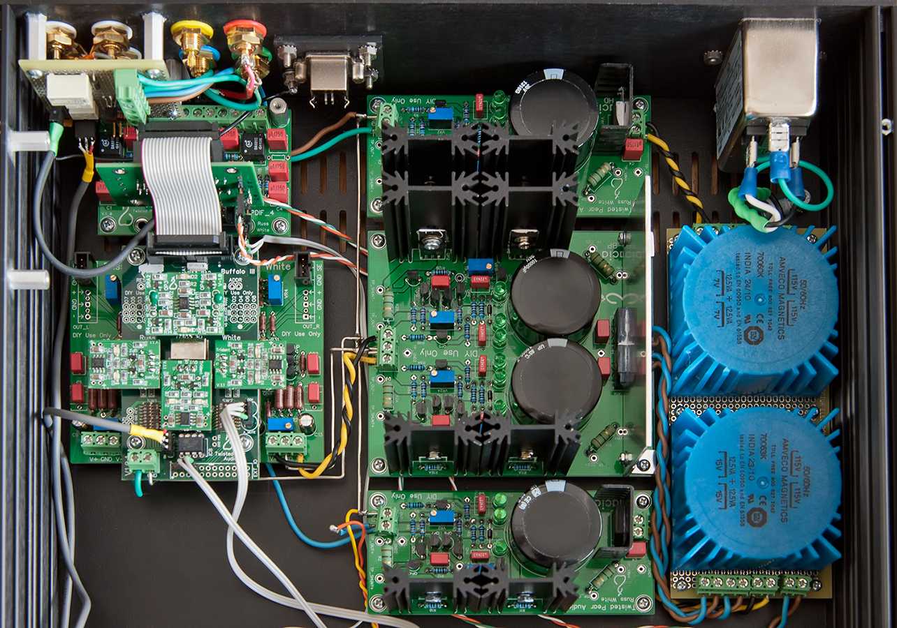

Thank you all. I plan to make internal pictures too when I add USB module to show you the whole design. Currently I have inside: Buffalo III, SPDIF 4, Sidecar, Legato 3, Placid HD Bipolar, two Placid HD (one for Buffalo III, and another for future expansions like USB and others), 2 x 7VAC and 2 x 15VAC 25VA toroid transformers, analog signal switching board for switching between external analog signal and DAC's output, one board to control extra LED's, EMI filter at power input. I made modifications to all Placid modules by changing heatsinks to 2.5" high to better manage heat dissipation.

There you have it. Because so many of you are curious what is hidden inside I decided to make some pictures today to show you my "secrets".
George

Sorry, but I am not willing to share this file. It is useless for most of people to use this file because of different components used during design process. Software for designing front panel is very easy to use and it is free.
I will place future USB module in the empty space between Buffalo board and front panel.
