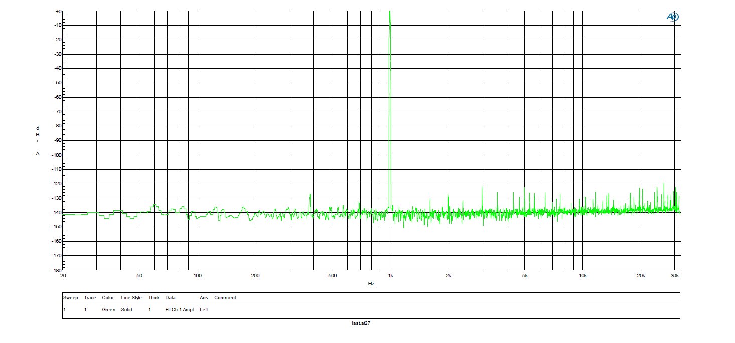

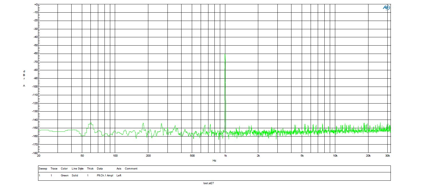

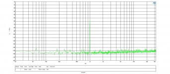

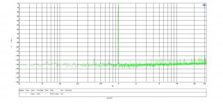

For your viewing pleasure. 🙂
How do you read these charts?
I suppose for the THD chart, the highest peak (at ~25K) gives you the -118 db THD number
The DNR, the highest peak is also ~ 25K and that is at ~143 db?
With the harmonics so low, I do not think there is any DAC+IVconverter+filter that beats this measurement. 3rd is at -122 dB and 2nd is even lower.
Still, it does not say how it sounds.
How THD+N is calculated from such a graph can be read about on Wikipedia. It is easy but tedious.
