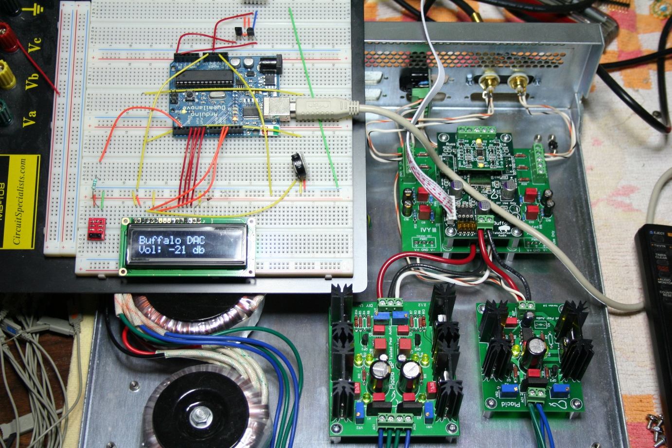

Hi Russ,
Thanks much for making the DAC available. I has been up and running for a month now and I enjoy every bit of it.
I also hacked together an Arduino based remote volume control for it. Not having the ES9018 datasheet, I mostly rely on ES9008 datasheet and my not so trusty HP 16500a to make sense of the initial settings (I am still a bit confused by some periodic register right that I saw – could be an error on my own I2C decoding.) I would have waited for AC2 if I knew how nice is and how much progress you have made before I ordered the part. This is no comparison to AC2 and I may get an AC2 to replace this when it comes out, but this is still a fun little project nevertheless.
Thanks,
Stanley
