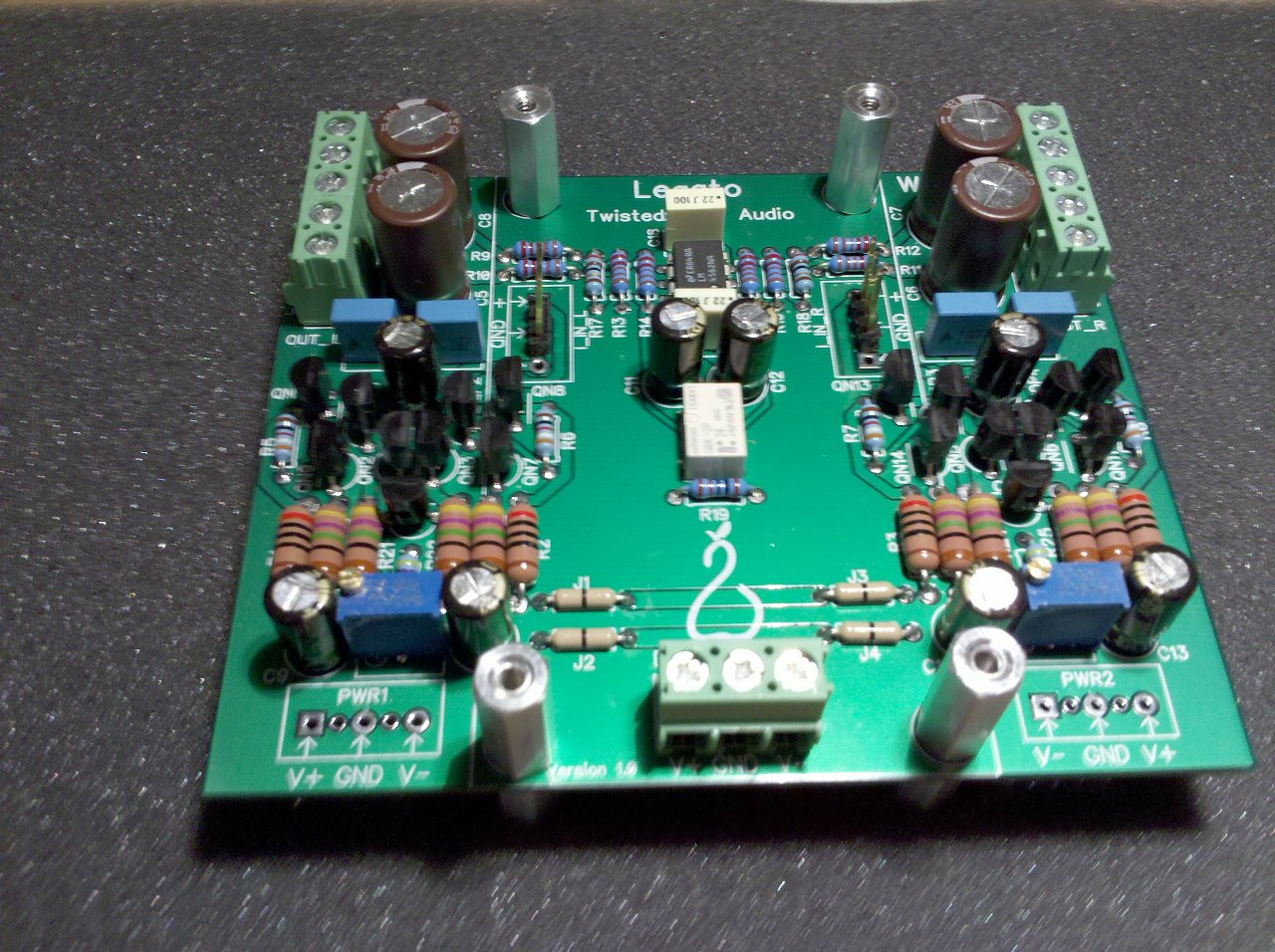

Here is the Legato.
I am really enjoying it.
When do you think we might enjoy it? 🙂🙂🙂
Choosing the cap will depend on your load. I would not go less than about 10uf (8hz corner) if you are using the on-board bal/se converter as it will present a 2K load.
100uf should suite just about anything. I have even used it driving my HD650 headphones. 🙂
