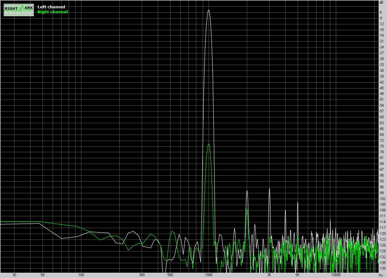

I've already tried BuffaloII in "current mode" with LL1931 (1:16) trafos loaded with 2,8kohm on secondaries. In this configuration DAC sees about 8ohm so every complementary output about 4ohm. I don't know if that is sufficient low to achieve good performance in current mode. If I reduce load resistance to 1kohm then every complementary output will see about 1ohm, ofcourse output level will decrease.
some RMAA measurments using motherboard built in sound card and crappy signal cable:
I don't know what is reason for this 10k+ peak..
and about Sabre DAC. As Russ said its internal equivalent scheme is voltage source in series with 195ohm resistance, not current source in pararell with resistance.

Linn Karik transport-- Sony test CD 0dB 1khz signal -BNC to BNC SPDIF transfer-Buffalo II- IV transformer-Xfi PC card-SpectraLAB

This shows why trnsformers help to produce "better" bas...

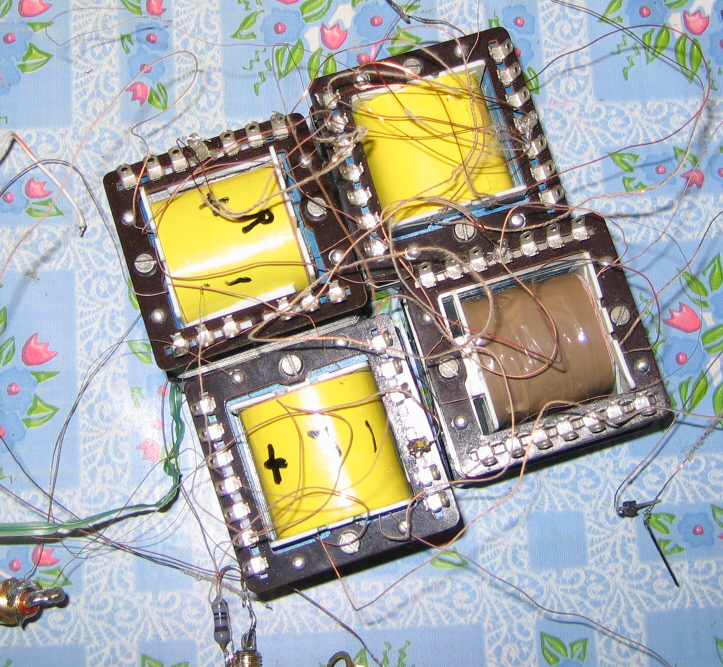

io, what DCRs and inductances your transformer has?
Did you connect center tap (if you got it) to GND or you leave it unconnected?
Primary bifilar 12 ohms dcr serial (2x6ohm) 6Hy 0.32 mm silk insulated
secondary 82 ohms dcr 28Hy 0.21 mm silk insulated.
GND terminals from a secondary RCA outputs

What about core for Your Hand Made trafos...??

Tel us bit more about it maybe some photo...??

I'm just experimenting their own entertainment, there are no plans to sell a transformer.
