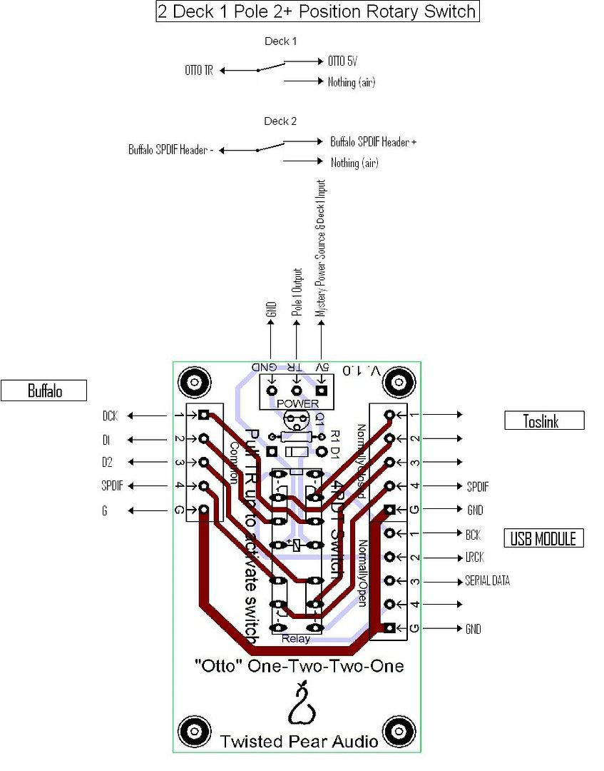

I've managed to get a Buffalo/IVY/power supply from a nice guy from Bulgaria. It is the 1.0 board and I note the silk screen error.
Can I ask a couple of questions. I've looked at the TP website and this forum but this thread goes on forever and I can't find the answers.
1. How does one get at the firmware? Is there somewhere to download upgrades if needed and how is that done?
2. I'm using SPDIF from a Phillips CD Pro with the clock disabled and re-clocked with a TentLabs low jitter clock. Should I disble the Buffalo clock and use the TentLabs clock output or will the Buffalo sort this out?
3. There is a mysterious 'bag of bits' consisting of a spare 8 pin DIL IC, same part no as on the Buffalo board, 4x R5-R8 178 ohm, 4x R1-R4 357 ohm and 4x220 pf add on capacitors. I found the update instructions on page 1 of this thread, R1 to R4 on this IVY are 550R - should I change them and what is the spare IC for?

The firmware is on the chip you have in the "bag of bits". The one in the bag should the one with the latest firmware.
The big question is when will TP be back open for business?
It is not a latching relay, but you could probably use one if it has the same form factor.
Cheers!
Russ
