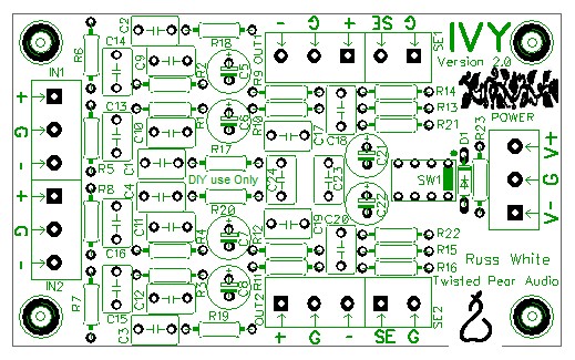

i just read the ivy manual and it states that C13-16 (the caps from current input to ground) should never be used without R5-8 - why?
wouldnt it help to have, say 2x 2.2nF to ground from the current inputs even with ivy configuration "Buffalo 1", to reduce high frequency noise BEFORE the ths4131 (maybe also reducing slewing effects)?
t5 said:i just read the ivy manual and it states that C13-16 (the caps from current input to ground) should never be used without R5-8 - why?
Because of the way the fully symmetrical op-amp works. 🙂
You will get some nasty peaking.
Look at the THS4131 datasheet for more info.
Cheers!
Russ

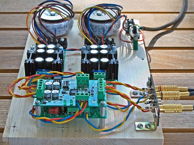

I finished my Buffalo build yesterday. Not as neat as Beefy's implementation; just on a piece of wooden board to test everything out. It will eventually go in the same housing as the preamp I'm planning to build; then it will be wired more neatly.
The assembly was easy, thanks to Twisted Pear's exemplary silkscreen labeling and layout documentation; everything worked the first time around. The DAC locked to the SPDIF-signal as soon as I switched the CD-player on, even without a CD in the drive. And then sweet, beautiful music, everything absolutely stable. That's great so far, and I'm happy, although I'm not quite sure if my birds nest implementation is really achieving the full performance of the Buffalo.
