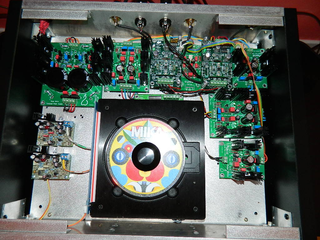

We used two BuffaloII + Legatoa3 as you have recommended.
It is fantastic !!!!! Especially the bass!!!
When I was a BuffaloII a Legato3 was not so.
What is the cause of so powerful and precise bass?
Because I now have 8 if the channel?
Or because of the increased current output?

I thank very much for your appreciation Russ!
I really am very very happy with Buffalo🙂🙂
One thing I'm sorry-F5balanced not work without capacitors (
But I put 33mkf/16v BG (N) and sounds great.
Best regards!

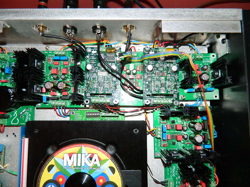

Having read through this topic & studied Rosendorfer's very helpful posts I'm keen to try this.
I've been using a dual-mono Buffalo II the conventional way with two Legatos but this method appeals because I use a single-ended output & currently have to use, in addition to the two Ballsies built into both Legatos, two other Ballsie Lites to convert to SE output. Using the one Legato is much neater and I can use my two HD Bipolar Placids to power either side separately.
My only query is, other than wiring as per Rosendorfer's photos, is there anything else practical I need to do? It appears I don't need to change the input resistors, and if this is incorrect, where are they on the board please? Sorry for these basic questions, I'm not very confident with the DIY stuff yet.

2 Buffalos and 1 Legato
Hi Tony ...
As per my experience, there is no need for changing resistors, everything works on stock values. But as important factor is that I'm using Volumite with my Buffalo's and that way I can take care about higher Output Voltage values it is 3dB higher, as Legato have to work with double of the input currents.
Well in theory of cause some tweaking with I/U Resistors values could improve things a bit, but having Volumite, You can easily try stock build.
And as small remark... "Preferred" for that configuration would be LEGATO 3.1 thanks to its lower input impedance, but any Legato sounds fantastic.
Anyway if I may say .... getting away with that quite few extra Opamps on Your signal path that are required in "standard" dual mono configuration, and keeping things simple "sounds pretty nice" 😎.
There is I would call "small issue" with Diff 2 SE conversion /Ballisie/ build into Legato board. It is done with LM4562 /Double Opamps in single IC/ and unfortunately there is no easy(!) way to have "True Duall Mono" Separate Power Supplies for L and R channels in SE Out mode, but for start third Placid could be used....
Rosendorfer
